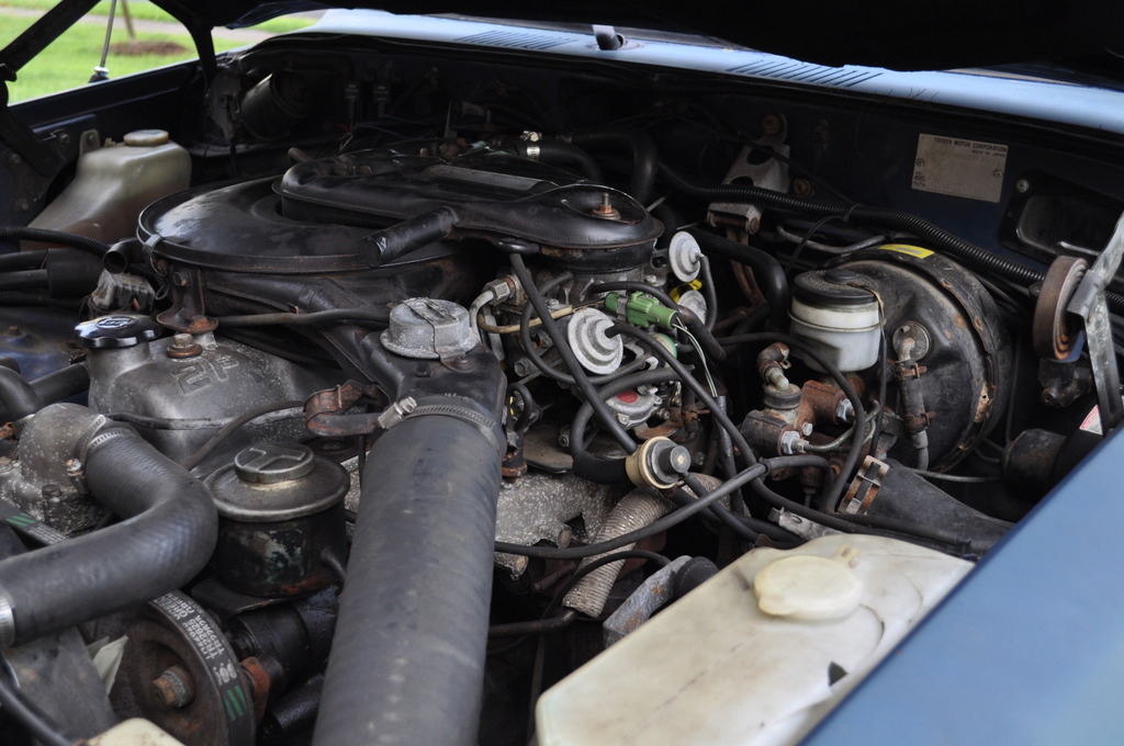

Make sure all vacuum hoses are right (something seems off by looking at it)

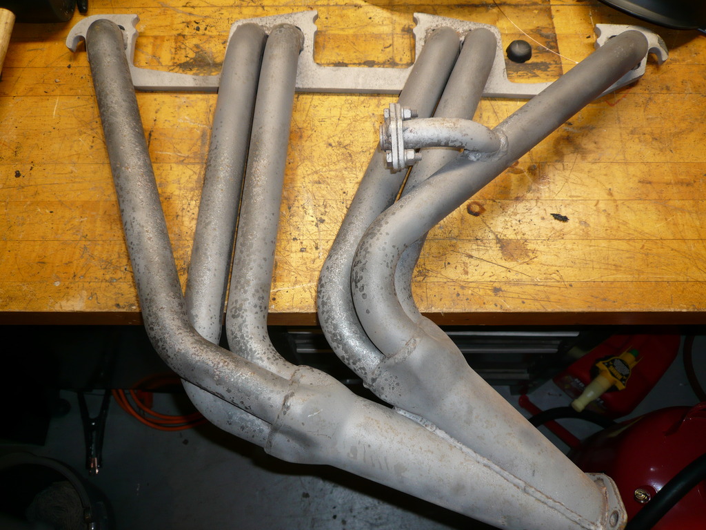

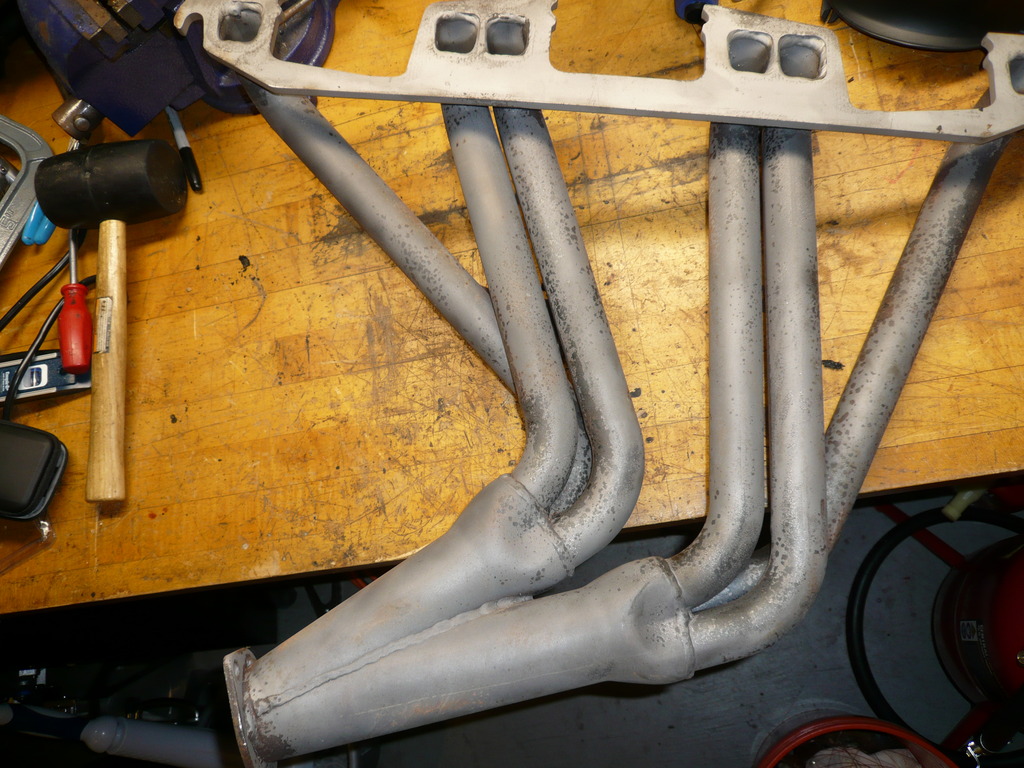

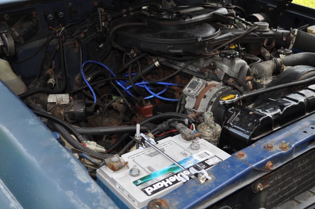

I believe those headers are the tri-Y headers by Downey Specter, 3 into 2 into one. Just referenced from a 2000 Specter off road catalog.
Good thing that you kept her, eventually the:princess:, you and the family will be happy that you did.
Thanks All. First, thanks on the headers. I will paint them and leave them on the shelf for now.
Maybe one day i will change them
Also I agree on the Keeping it. Very happy.

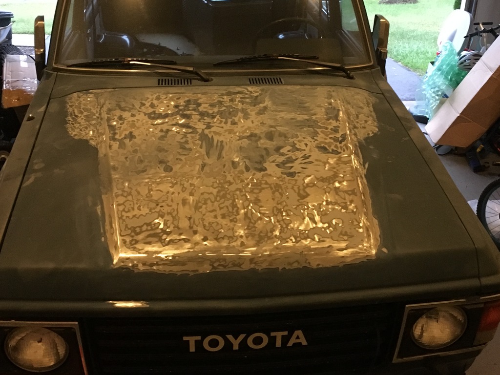

For all of you guys who think that spraying on bed liner on the hood or anywhere else on your 60 is a great idea and looks cool, think about the next guy.
Did this over the weekend
That stuff with older paint is like glue. Nothing short of a grinder and a flap wheel works.
Now to do the sides
LOL... think most of us plan on keeping these trucks for the remainder of their life. Plans for the hood?
So far sand and paint back to original color the 60 will get a whole paint over once i clean the sides and finish the wheel well rust repair. That starts this weekend.
I will not be putting any black decal or paint or anything. The hood aside from the mess it looks, is actually very straight.
