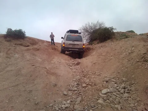

:D Kais.webp
Well... For me it is still working perfectly! :grinpimp: So easy to use even the :princess: can do 2 wheel stands! Now my only problem is to stop her from flipping the cruiser! :doh:
Seriously, Could not be happier with how it works! :clap:
