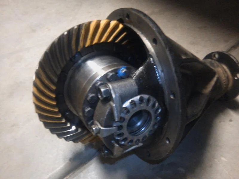

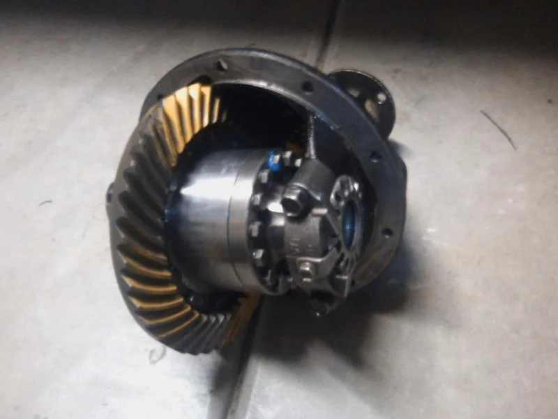

Update with Pics
Just some pics of the 3rd with the locker installed!
Enjoy :popcorn:

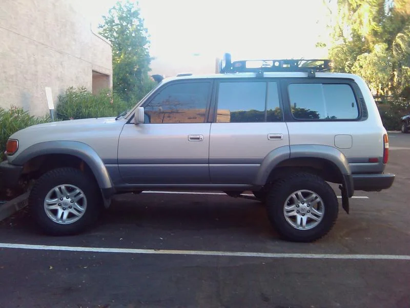

Couldn't resist :o Pic of my rig with the lift, Rack, snorkel, new wheels and tires.. :D and if you squint really hard you can maybe make out the locker! :lol: :lol: :p
I know, I know I still need the sliders, ARB front + back..etc!! :grinpimp:
