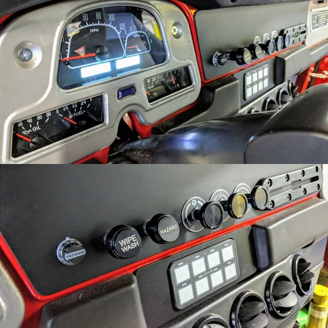

I love the stock look of the Dakota Digital gauges. The best part is mine went in with my Cummins R2.8 install so Odometer will read correctly :)
We're using aluminum overlays and only passing screws/switches through stock dash holes so it looks clean and doesn't alter the original dash at all.

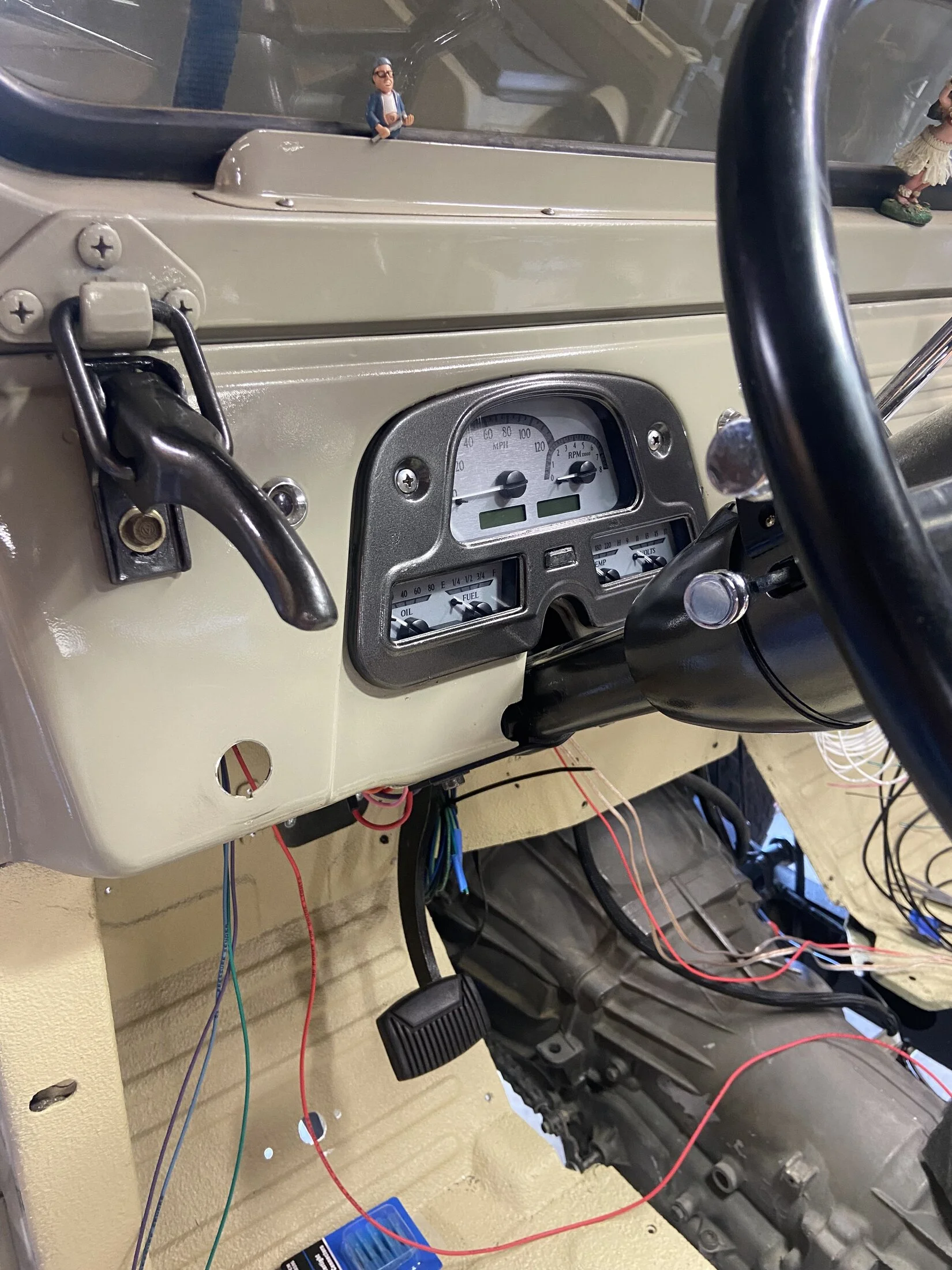

Just finished up the install of a Dakota Digital instrument cluster in my 76 FJ40. Went well. Am very happy with it- gauges work nicely and the lighting is awesome. I gained a clock, and now have a functional tach and set of gauges in the cluster rather than aftermarket units on and under the dash. The install was straightforward as their installation booklet is pretty comprehensive. I mounted the control unit in my glovebox and the SW1 and SW2 switches in the dash witin easy reach of the driver. Picked up the turn signal and high beam indicator lights from the original cluster pigtail, and tied into the parking light circuit for the lighting. I was lucky enough to have a spare gas tank float unit here and tied that into the conrol box temprarily to calibrate the fuel gauge. Worked well. The speedometer and odometer were easy to calibrate. Took about twelve hours or so to get everything in, wired and calibrated. I might not be the fastest guy in the world but stayed at it pretty well and tried to make everything look neat. Overall I think it is a great improvement for my 40 and would recommend it to anyone.
