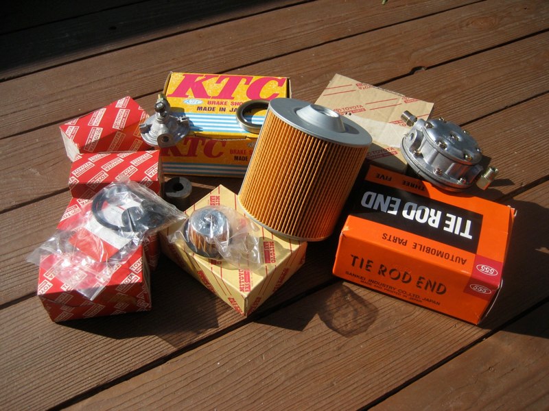

Got some new parts from Mark the other day...
:grinpimp:
I have a second half to the list that I'll be filling soon. Sorry I had to run Mark. I hate being in a hurry especially during good conversation. I appreciate all your help and sharing of knowledge.

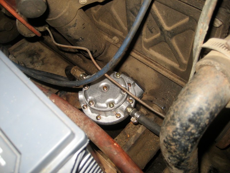

I replaced the old fuel pump with a new one from Mark. Definitely seems to have a better supply of fuel when depressing the accelerator. (Not sure I can even call it that as it's more of a slow motion-increaser). We'll see if that gets rid of my "hard to start" problem after it sits for a few days.
Also replaced the fuel filter and started poking around the Eaton heater to see what was up with that.

I picked up a few more parts from Mark and now have quite a few projects to do.
-Replace/rebuild the brakes.
-Install updated brake master.
-Replace Fuel line from pump to the carb.
-Replace all tie-rod ends.
-Rebuild center arm.
-Rebuild parking brake and replace rear transfer seal.
-I also need to determine the leak at the front of the transmission. I imagine it's the front retainer gasket which I am not looking forward to.

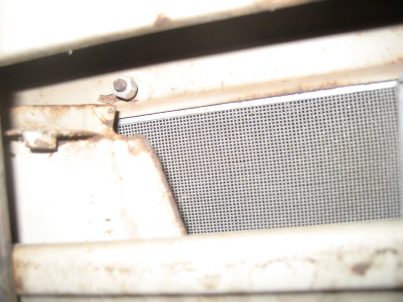

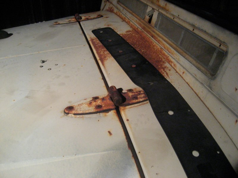

-Replaced the windshield vent rubber.

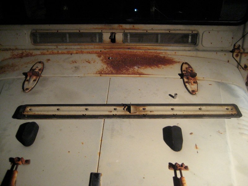

Old lower piece removed...
New rubber...
I was extremely careful with all of the tiny bolts on the flap as well as the interior of the windshield frame and only one broke off despite the condition of them. Fortunately for me it was after I had loosened the nut to the end of the stud and most of it remained. I just threaded another nut on no problem...

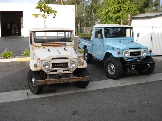

I also met up with Mike (crusherboy) and drooled all over his LWB 45. Very nicely setup and one of the sweetest I've seen.
He gave me a few great ideas and most importantly passed on his old window channel felt that he had just replaced!:grinpimp:
Mine is pretty much all missing and the windows rattle like crazy.
Thanks Mike!!!
