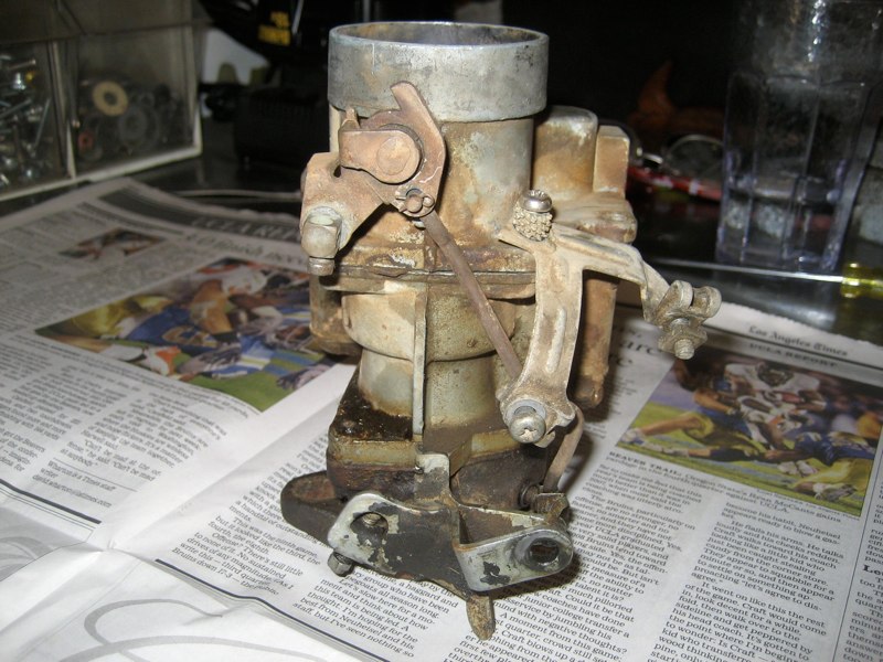

So I decided to tear apart the Carter Carb and do a quick rebuild.
I haven't rebuilt a carb in about 10 years so I took tons of pics in case I didn't remember where anything went.
Before...
As you can see from the picture above the choke and throttle cable attachment was not ideal. The threads were stripped so I decided to use a new bolt with nut to secure it tightly.

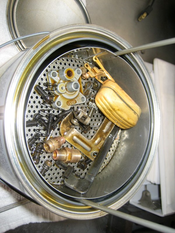

Pulled it all apart and then into the parts washer...
The body came out pretty nice. Here's mid-rebuild...
Final product...

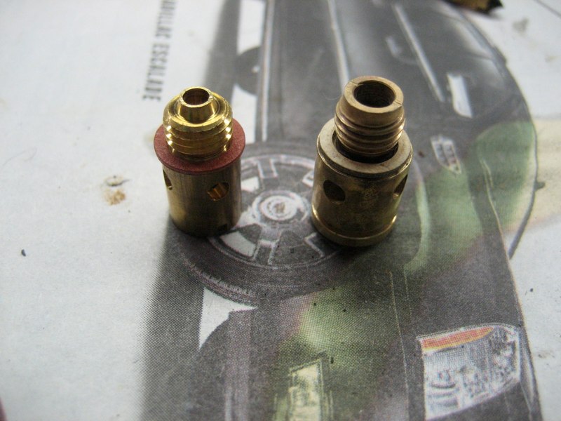

After first installing the rebuilt carb it took a long time to get it to start. At first I chalked this up to the empty carb bowl and after a long period of trying it did start up. This is when it did not run well. Before I found the vacuum leak and oil cooler hose I thought it might have to do with this piece where the needle valve resides (sorry for my lack of terminology)...
The one on the right is the old one and I had replaced it with the one on the left (from the rebuild kit). The inner diameter looked identical so I wasn't too worried. But after the idle issues I dropped the old one back in with the new needle valve with no change. Then I found the vacuum and hose issues and it's much better.
Does this matter much?
Now after the rig sits overnight it is hard to start. I have to crank it over for several minutes before it fires up. It seems like it's starved for fuel. Once started it runs fine and will start for the rest of the day without issue but continues to be a hard start each time it sits for a day or two.
Any suggestions? :confused:

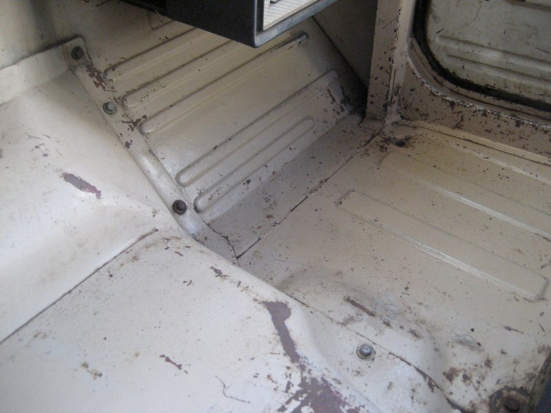

Next I cleaned up all the loose items on the floor and behind the seats. Found a few interesting things...
Old school flares...
Old Toyota knuckle shims?...
Broken FD knob that was missing from the dash...
And after shop vacing the floor and cleaning up with a little simple green the floor board looks pretty good. :grinpimp:
