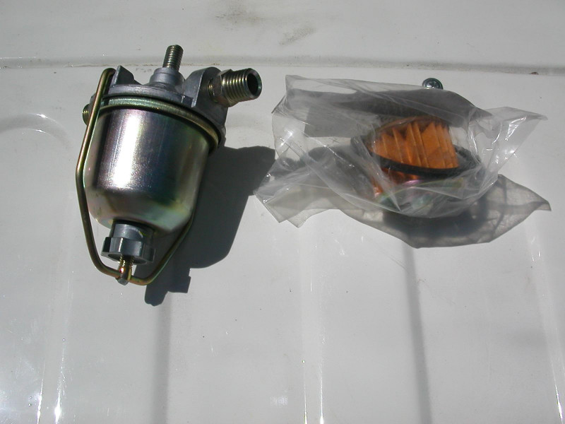

you can still buy the fuel filter assy from the dealer for about $8. they nnow come with a stamped tin bowl instead of the original glass units. i have an extra glass bowl if you need one.
also, i have a good 3spd trans and t-case i just pulled out of a 1970 fj55. you can have them for $100 for the pair, delivered to SNT. the trans is a top shift 3spd though, not sure if that will work for you.
Thanks guys. I have sourced the filter element but do have the metal bowl. I imagine the glass bowl was original for 65? I'll take it Georg.
I didn't think the glass bowl type came with an actual filter inside, i thought it was like the old fly-catcher kind of air filter, lol where the sediment settles at the bottom of the bowl, kinda like panning for gold, but I never have gold in my gas tank.....

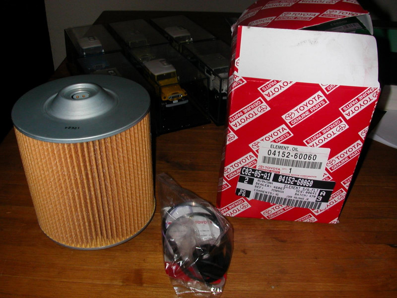

1st off CONGRATS! :)
think I got the last of the NOS OEM masters 3 years ago
oil bath
fuel filter.....forget the #
oil bath
Thanks Pimp, and...
I'll take 'em!!! Ha Ha!
Joking aside thanks for posting up the pics. Everyone here is helping a ton. I remember before MUD I had to take a trek to Specter and hope I remembered everything I needed.
