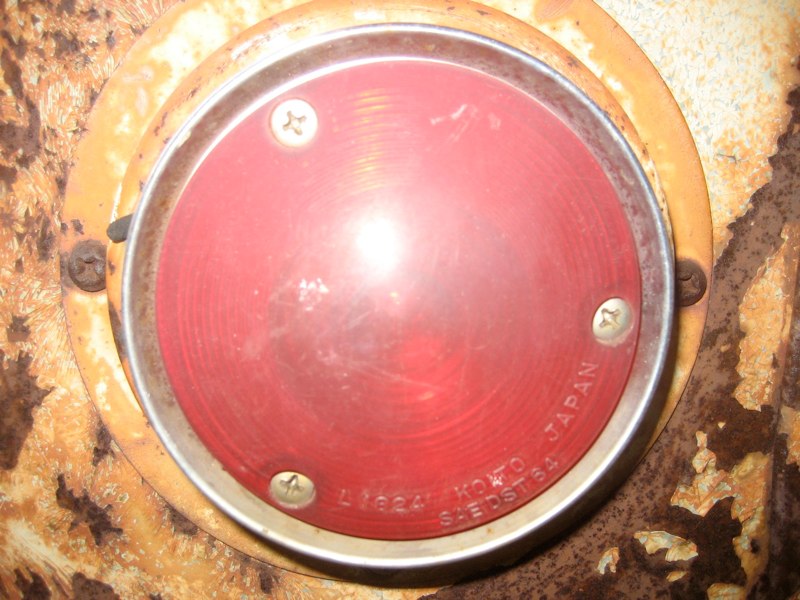

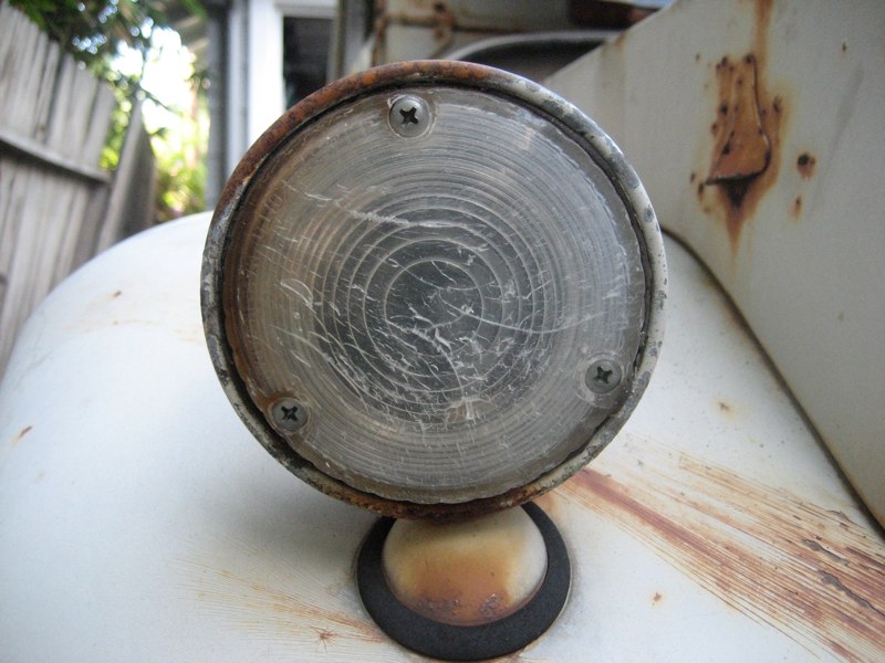

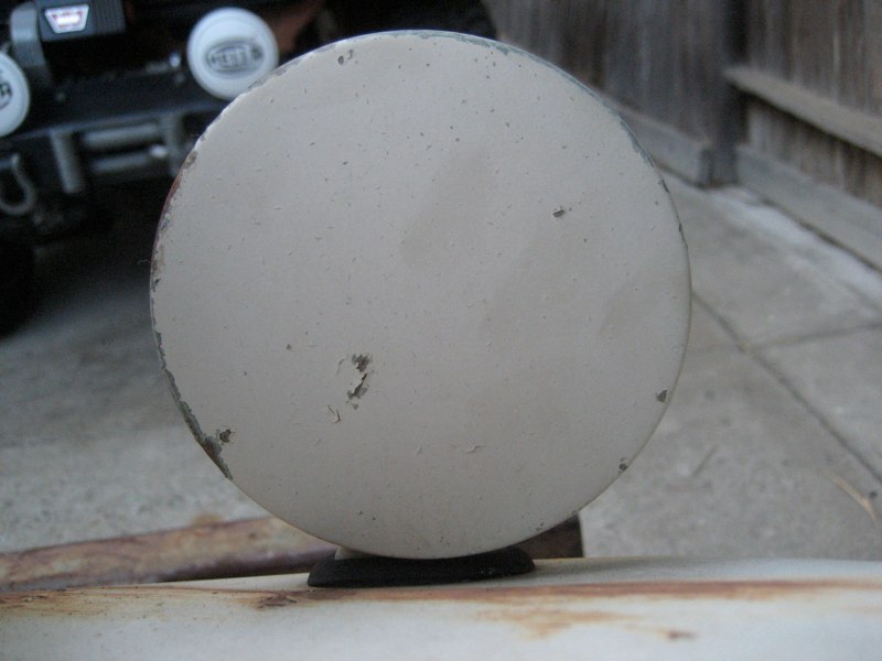

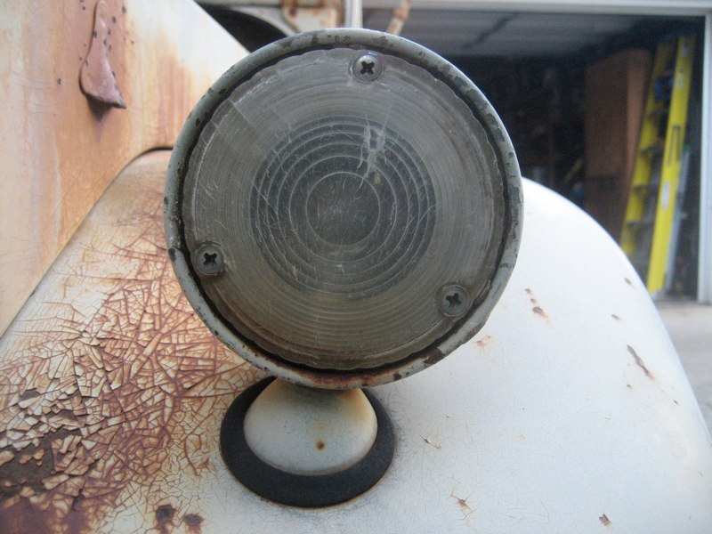

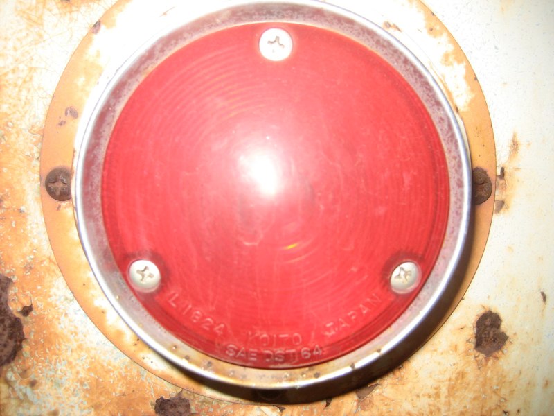

Got some close ups of the front and back of those front turn signals?
Here they are... I also included the rear signals...
Drivers Side:
Passenger Side:
Rears:

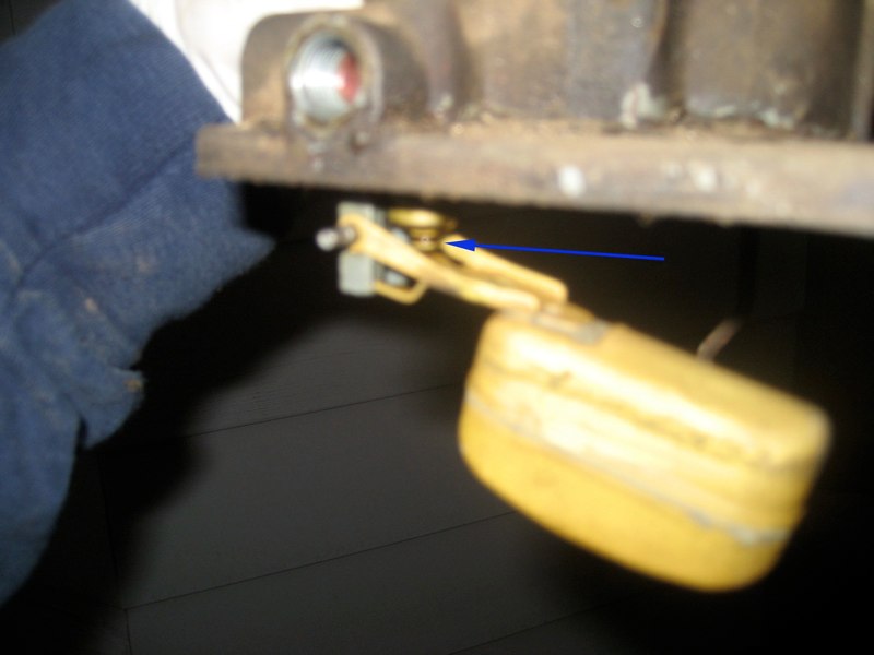

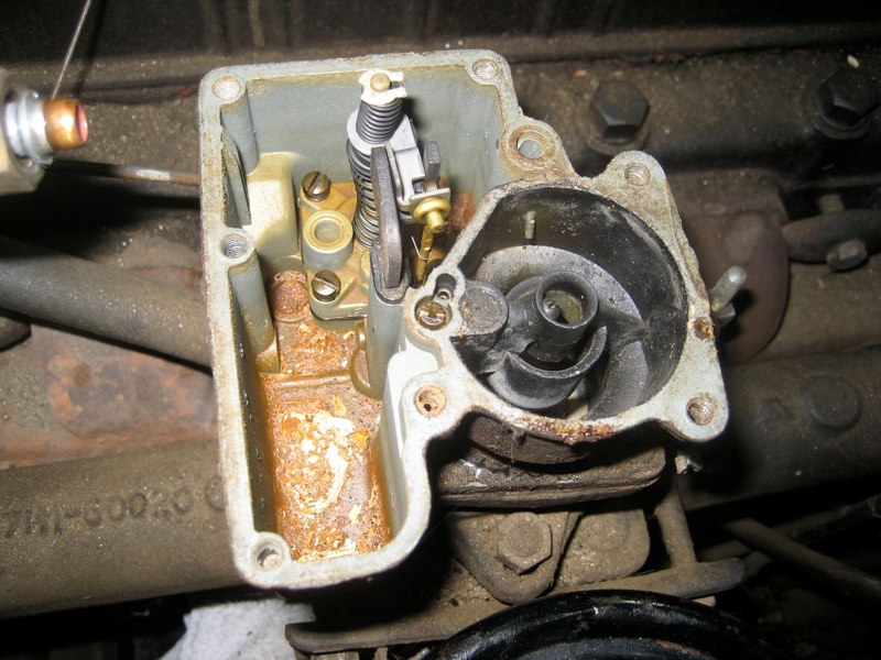

Shane is definitely more carburetor inclined than I am so he convinced me to pop the top of the Carter to take a look see. Pretty damn grimy in there and the bowl was empty...
He also noticed that the valve that shuts off when the float is high was stuck (sorry for the blurry pic)...
This thing is in serious need of a rebuild but until I get a kit I hoped to at least get her to run. I think an Aisin carb is in order eventually, I just need to source one. Cleaned all the crud out and cleaned up the needle valve. Also filled the bowl with a little fuel and crossed our fingers...
SHE STARTED UP!!! And stayed running and idled smoothly. Woo Hoo and high fives followed and after about 20 seconds it died again. :frown:
After that I decided to push it into the garage for storage and pull the entire carb to take a look. I realized then that I would be sucking some serious fumes if I started her up again.
After looking at the needle valve again I could see that a very fine groove had been worn into the rubber where it seats, so i figured that is what was sticking. I decided to rub the rubber cone to see if I could smooth the groove out. Sandpaper? No. Steel wool? No. I finally decided on a paper towel and it actually worked! No more groove.
Put it back together and fired it up. After inhaling tons of exhaust it stayed running. :) Now I know this needs to be done right but the moral victory was huge.

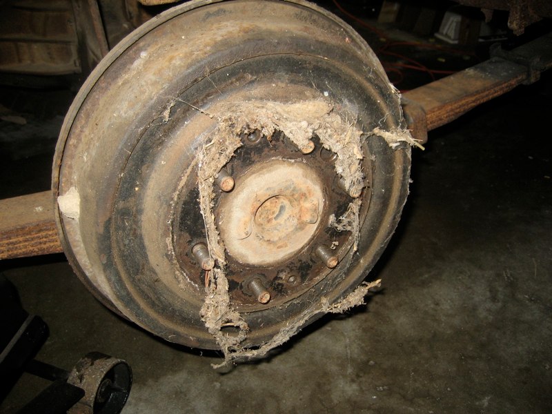

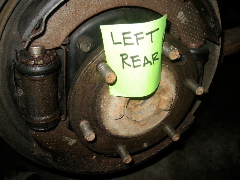

I decided to spray the brake bleed valves some more and pull the rear drums to get a look. These lug nuts were a serious pain to get off...
They really didn't look as bad as I had suspected...
I will certainly need to rebuild all the wheel cylinders but otherwise no major component problems or missing junk on the rears. One of the bleeder nipples is broken off but I'm certain I have one laying around somewhere. Broke free the other 3 bleeders and sprayed the fronts to help loosen up overnight.

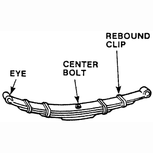

Hi Don,
first ;)
it´s so easy to get a smoother ride with this old leaf springs.
( they are easy to restore ),
What you can do immediately, bring grease between the leafs.
( 1time a year)
You can take wd 40, Fluid Film or something else.
Your ride will be softer ,
Easy to do & cheap :)
Change the original Toyota shocks,
take Bilstein or Monroe Gas Pressure Shocks,
spray them black
Cheers
Peter
Nice score.
Mike,
Just curious, is there something special about the turn signals?

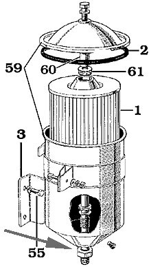

Oil Canister: Since cleaning out the carb the rig runs as long as I want but... the oil filter canister is leaking from the bottom so I have to shut it off. I noticed a small rubber seal (area of the gray arrow) on the underside of the canister that was pretty well worn. This must be it, but after tearing everything apart I'm not sure I have all the parts. :confused:
I think I have everything except maybe #60? Is that a sleeve that holds down the seal (#61) and pushes the filter down onto the lower seal and spring? There was nothing between the top oil filter seal and the top of the canister to hold it down snuggly to help the lower seal seat. The upper bolt tightens nicely into the long threaded post that slides in from the bottom but the filter can just slide up and hit the cap.
Here's the only schematic I have...

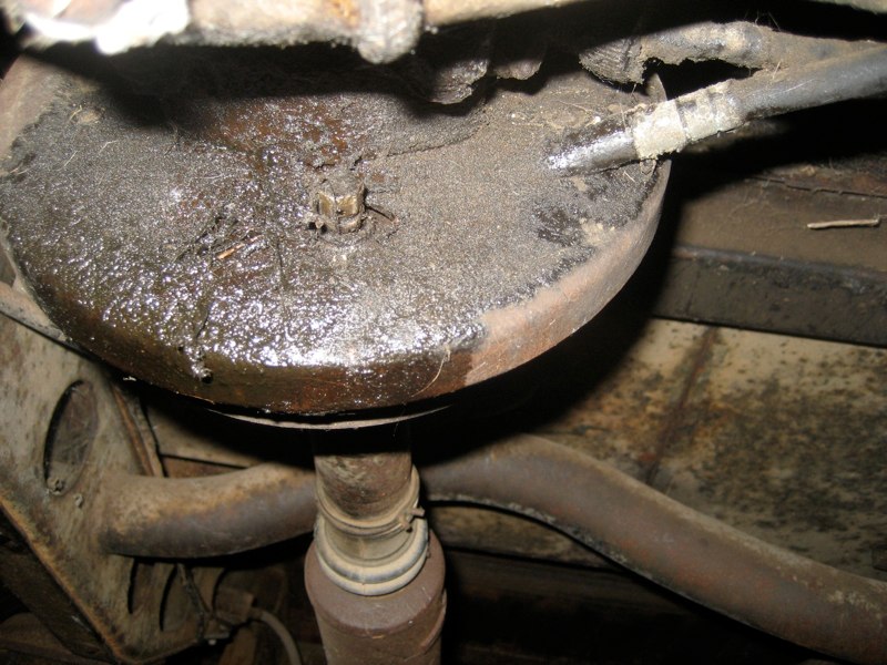

Next we took a look at the parking brake.
I knew from the day we pushed it off the trailer the PBrake was not working right so we pulled the driveshaft and took a look. I forgot about the seal and immediately had to slide the drum back in to stop the transfer fluid from draining. After draining the tranny and transfer we went back to work. The parts are all there but it needs to be pulled and rebuilt as well as new shoes. I have another complete setup but I think what is there will do. The drum does have a pretty good groove in it where it rubs against the seal...
http://www.dominicsmith.com/1965_FJ45_Pics_2_files/Media/IMG_2668/IMG_2668.jpg
Lots of metal stuck to the tranny drain plug :frown:
[IMG]http://www.dominicsmith.com/1965_FJ45_Pics_2_files/Media/IMG_2667/IMG_2667.jpg
I suppose it's not TOO bad for how long this thing has been sitting. I'll be refilling the tranny and transfer with gear oil in the morning. I'm not too worried about draining the transfer a second time when I rebuild the parking brake because I think it will be good to run some fluid through it and drain again.
