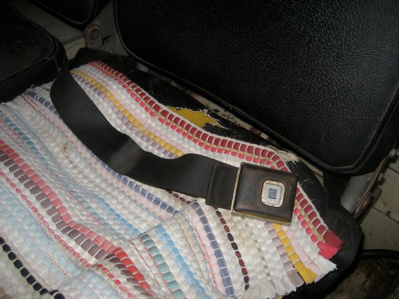

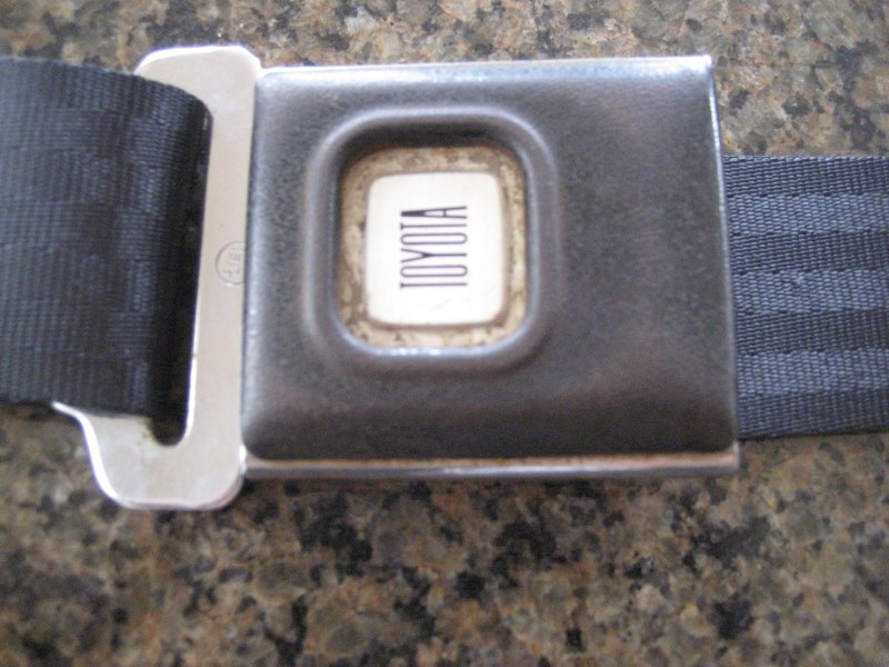

As for the 45 I did finally go pick up the seat belts I had my upholstery buddy re-web. Here's what I started with:
They're out of an early 70's FJ40 and the lengths were a little off and the webbing was tired so I measured what sizes I wanted them to be and had them re-webbed custom lengths.

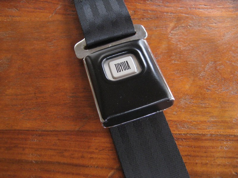

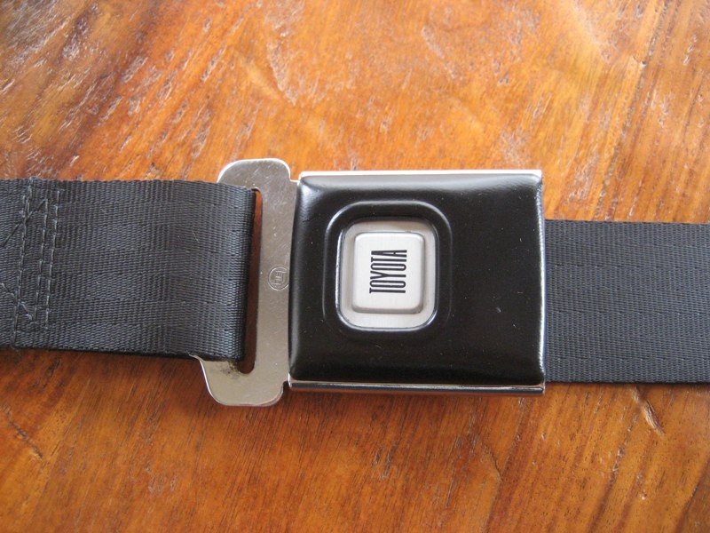

This is how they came back with the correct length webbing:

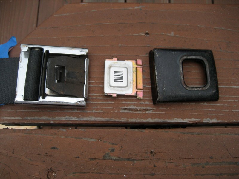

So I popped the covers off:

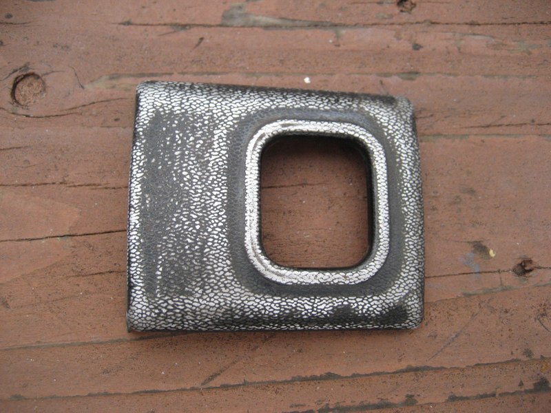

Cleaned them all up and sanded the covers:
Then primed them and used a black satin finish:

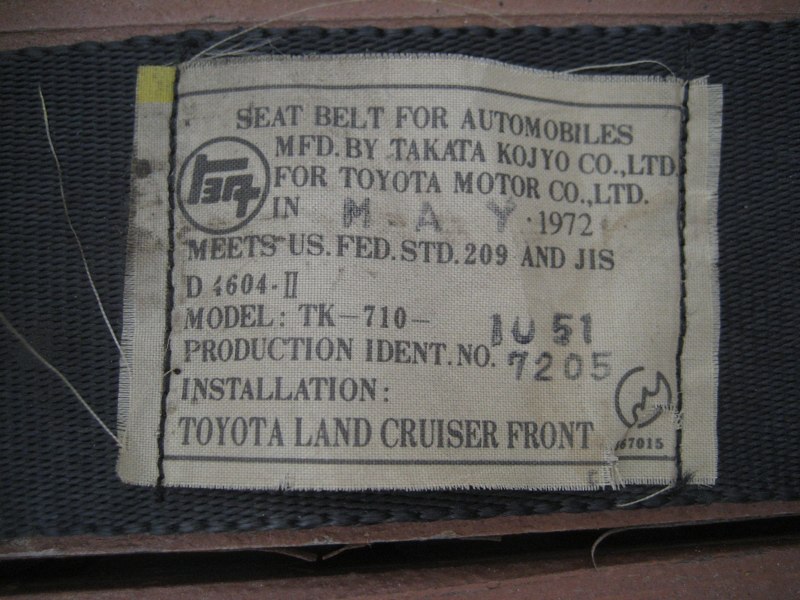

The only thing I didn't do that I considered (and still might do) is have them remove these old tags and sew them on the new belts:
I mentioned to Shane that he might want to consider scanning these, digitally cleaning them up and making reproduction cloth with the correct date stamp for whatever people here might want. Not sure if there's much demand and it is a bit overkill but that's never stopped anyone here before.
I'm going to bolt these in tomorrow. I had the drivers side lengthened a bit and made the passenger side long enough to fit a middle passenger in a pinch.

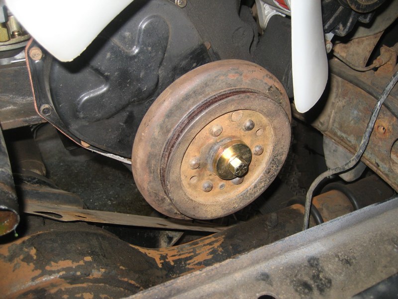

I have not been doing too much with the Cruisers lately but decided to tackle the front pulley problem that reared it's ugly head again a month or two ago. It's been parked for some time since I noticed the pulley had come loose and I was afraid to drive it much. :mad: Just a few trips to Home Depot for supplies to build a fence and other than that it's been in the driveway.
So I decide to solve the front pulley loosening problem with a more permanent solution (I hope). The front of the crank must be worn because both of the pulleys I've tried have come loose. (See post #149 for the last episode)

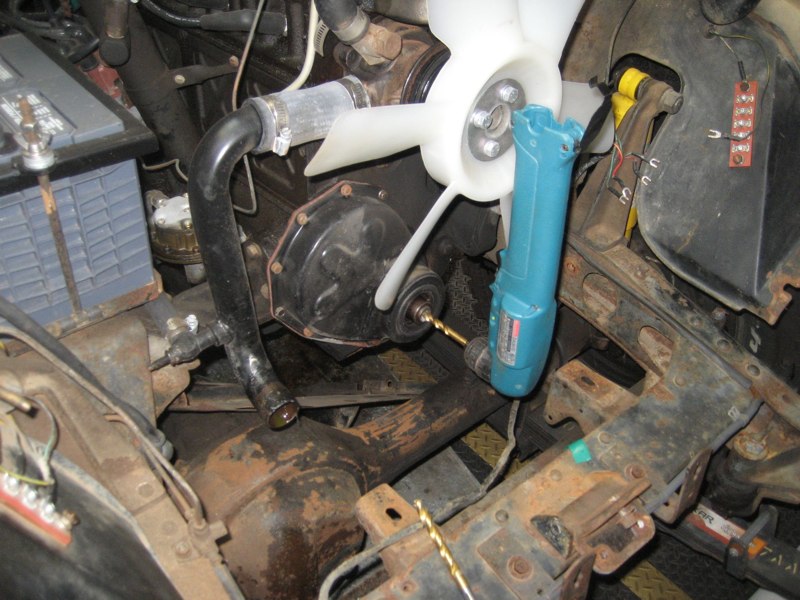

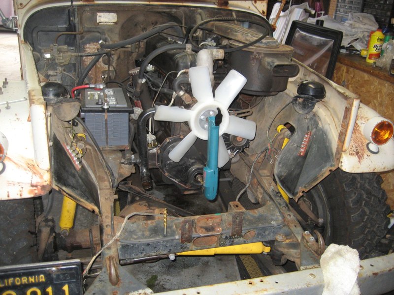

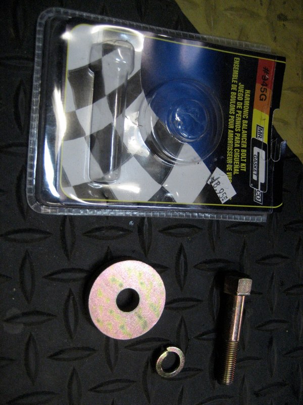

So I drained the coolant and disconnected all the front wiring, removed the bib, took out the radiator, etc. so I could get to the front of the crankshaft. I purchased an SBC harmonic balancer bolt at my local speed shop (7/16 x 20) with plans to drill and tap the crankshaft to eliminate the pressed-on design that keeps loosening up...
I lined up the drill as best as I could and started out with a small bit gradually getting larger and larger. I used the angle drill because my corded drill was too long to clear the front cross member, and the weaker drill kept me from creating some unwanted carnage. Patience...

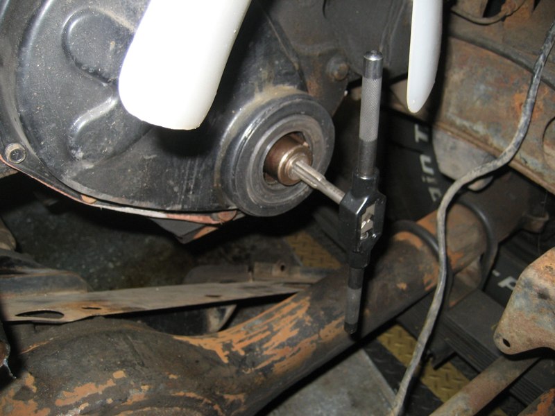

Once the hole was drilled to the proper spec I used the tap and slowly threaded the crank...
While I had the radiator support out I re-welded a bolt on one side as it had snapped off during the last pulley replacement. I ground off the old broken bolt, found an exact replica and good to go...

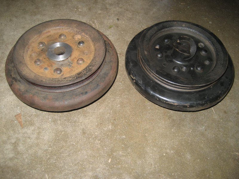

I had dropped off the original pulley I had replaced with the one from Marv at the machine shop and had the front of it machined down flat. You can see the difference here...
I lined up the keyway, slid it on snugly and bolted it on.
Here's the pulley bolted and loctite'd in place...
Put it all back together and test drove without issue. I hope this one lasts longer than the last one...
