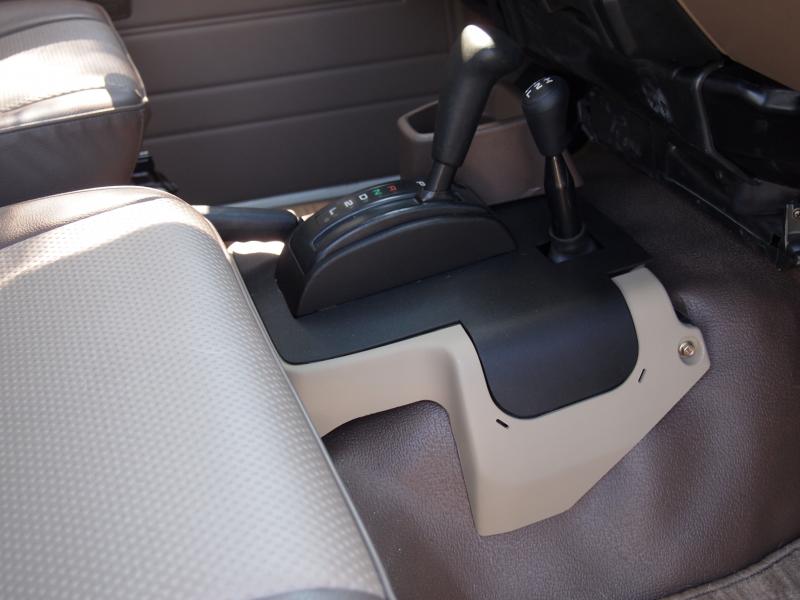

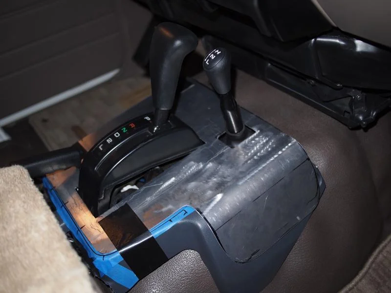

Couple progress shots of the center console....I think it's going to look and function perfectly when we finish it up....going to go with a textured black powdercoat on the aluminum more than likely....
Still making progress on the center console....we've still got a good ways to go but this should be close to the final product....pretty cool.
I don't think the H-L shifter hole has been finalized....looks too small. I have an extra tan e-brake boot we will use as a shifter boot for that once we get the console fitted and finalized. Probably going to go with a light texture black powdercoat for all the parts. I think we decided on a small bezel under the shifter "dome" and the base. Once the cup holders go in it will look really slick....

Console is still a work in progress....it's not very far away though. Just needs some minor work to fit the other cupholder and make some mounts to hold it down to the shifter plate. Then I'll have a couple of holes filled in the plastic and get it painted to match the rest of the tans in the truck...we sprayed it with some textured black and some light tan we had laying around. Good enough for now...
