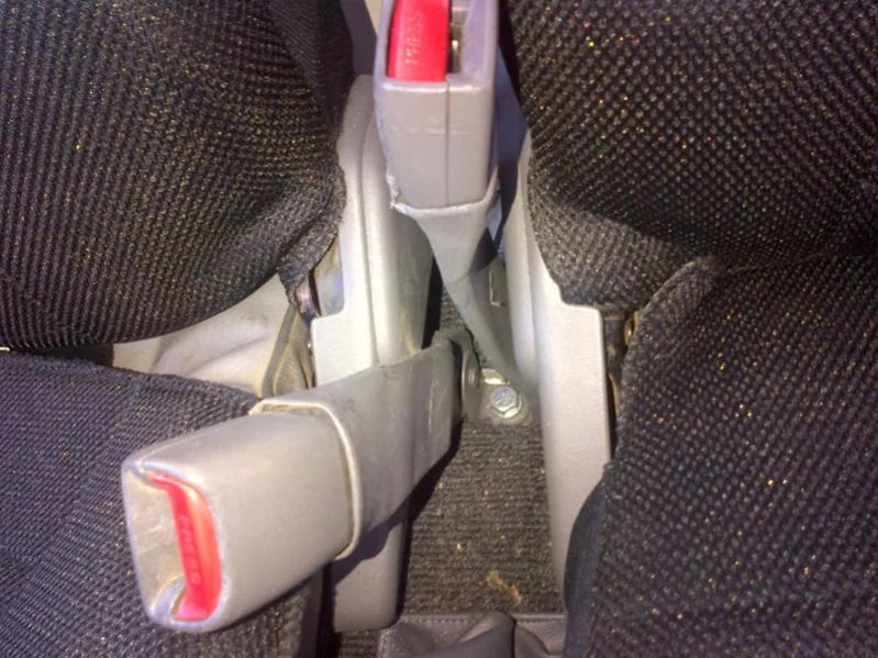

Strange passenger seat belt arrangement.....that 3 point harness is not for normal sized people. I might have it set up wrong but I'm pretty sure there aren't a whole lot of other ways it will work...
Where's the lap belt? It's supposed to poke through the seat as well.... And yes it is for small passengers or short journeys. :)
Is this configuration designed for 3 passengers?
Yes, there is usually a second seat belt receiver between the seats and a lap belt for the middle passenger, that's what my 75 series has.
I need to research the belt situation a little bit to figure out what is going on....
Mind attaching a pic of your belts?
1978HJ45......yeah, 3 person seating I believe....60/40 split. Dog will be the middle passenger pretty much all the time.....

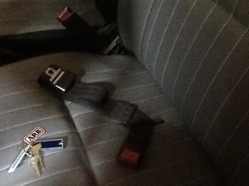

This is my configuration. Hard to see in this photo but there are two female connectors between the seats.
Sorry for the poor quality photo.
Perfect....that makes sense and the parts diagram indicates that. Hopefully Penny can get some nice take off ones.....

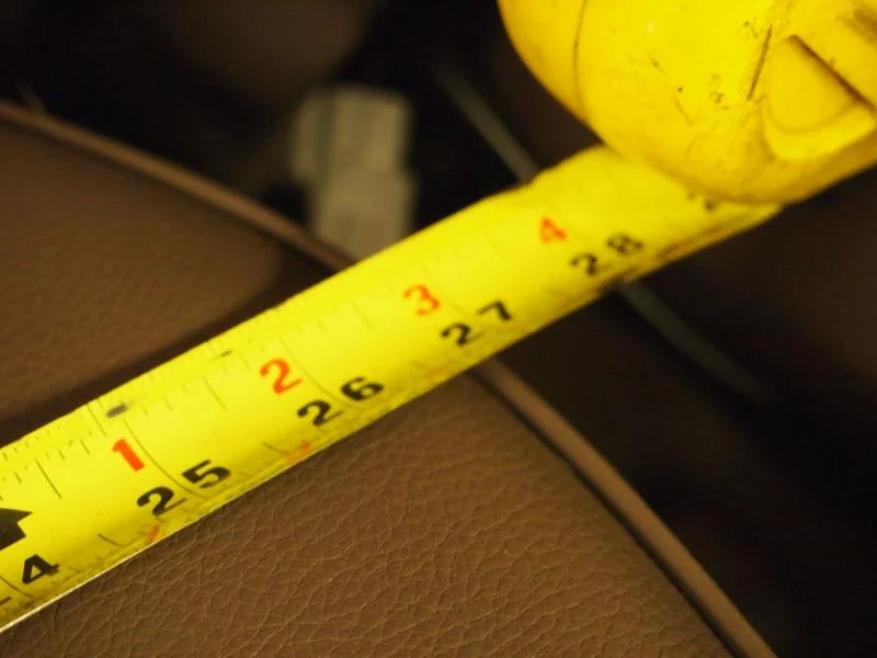

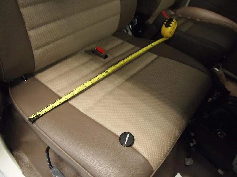

Just curious ...... what is the width of your "bench" seat cushion?
Thanks.... Charles
I'll get you a measurement tomorrow when I see my beloved truck at the shop....
Just the bottom bench cushion measurement is all you need?
Yes ..... Just curious to see how it compares with the older bench seats.

Here are mine, a little clearer. The second receiver attaches to the floor with the same bolt as the drivers.
..... "A little clearer" .....
Are you making fun of my marginal photographic skills? :D
Not at all, that's a great effort in what looks like a dark garage. I have the advantage of daylight in my time zone. ;)
Thanks 75ute......very clear now. And I clearly won't ever use them. That's a tight front seat for 3 peeps...

1978HJ45.....attached are your seat measurements. Looks 27" at the widest point. not too wide
