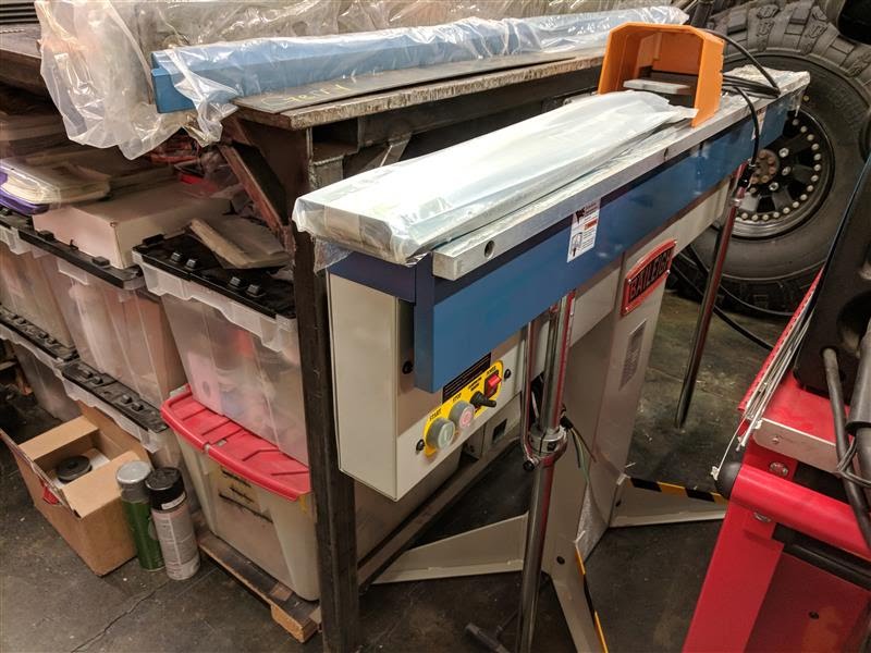

Trying to finish the shroud... I went to use my other new tool. Baileigh BB-4416 mag brake.
Baileigh BB-4416 mag brake:
I’ve known I have quite a bit of sheetmetal work ahead of me, so I bought a sheet metal brake. I liked the small footprint and versatility of bends possible so went with a Baileigh BB-4416 Mag Brake. My garage continues to be 10 lbs of stuff in a 5 lb space so I had to make a few mods before the brake would work for me.
Added risers to put the elevation of the work surface just above my weld table.
You have to add your own plug.
The brake calls for 220 V +/-5% (209-231v) and straying outside this range will void your warranty. Since my house nominally runs at 240 (and I was measuring 247 V at the plug) I got to wire up a buck boost transformer to drop the voltage into range. I’m not 100% sure if my multimeter read correctly as I ended up at 215 V rather than the 225 or so I was hoping for. I may rewire the buck/boost the alternate approach for less drop. I’m finding I want every bit of capacity I can get out of this machine.
The pedal plug was installed backward with threads not facing the connector so I got to redo that. (Thanks Baileigh, loving you guys right now).
I also built a holder for the pedal so it wouldn’t be in the way on the floor when I clean up.
I used the brake to build a holder for the various dies and tooling to hang off the back. I can vouch for their limits. It wouldn’t do a 44” piece of 16 gauge stainless (manual says 0.050”), so I ended up having to section my holder to get it done.
The more I use it the more I find capacity is the Achilles heel of this machine. On a traditional finger break you can cheat things a bit and do more than you’re supposed to. On this one, you just pop the magnetic bar.

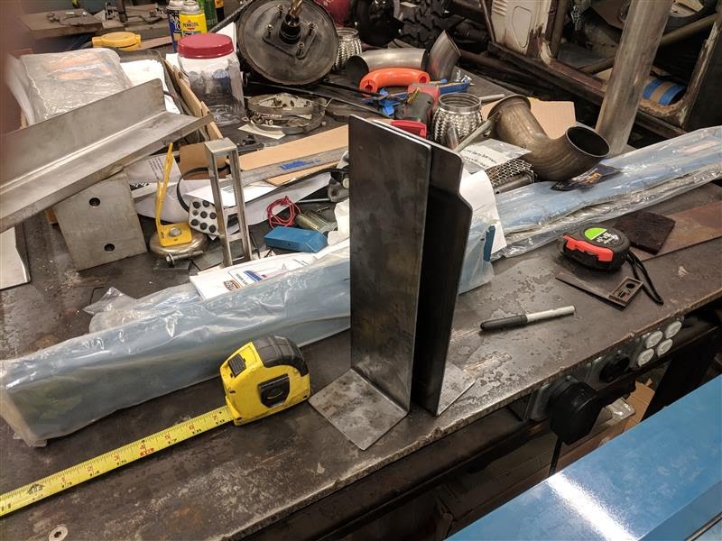

Getting back to the fan shroud write up. Remember that 0.090 aluminum I talked about? Yeah, turns out this machine’s rated capacity is probably only 0.060 aluminum at 4’ (estimating from other numbers since they don’t call out aluminum). Either way my shroud is 24” long. Cutting the “B” term in half from 1/12*B*H^3 means I’m still trying to be 1.7x the machine capacity and that doesn’t take into account the magnetism falling off with distance.
At the end of the day, I still don’t really have space for a press brake. The machine works awesome for smaller stuff. Case in point. I made some quick soft jaws I was stoked on before bolting the bead roller in a vice.
It kicks ass hitting specific angles.
Even folded the corners and marked which side goes toward the handle.
