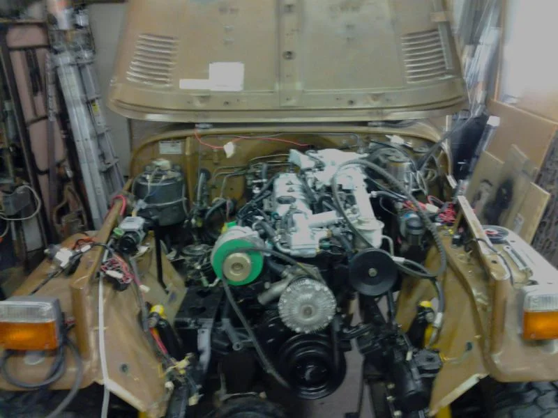

Not to worrry, Jim. We're gaining on it. Well, sort of. We pulled this much out of the dash today, and now it looks like this, but we still need to put this much more back in, if we can figure out how:bang:
What the mechanic really meant to say was: :doh: "Employing great amounts of fabrication skills and large quantities of blood, sweat, tears, flesh, and time, the aforementioned assembly has been made to fit with a reasonable likelihood of long and fruitful service." :hhmm: Actually, it's the SCHIZZL!! :clap:
This looks amazingly stock, well done.

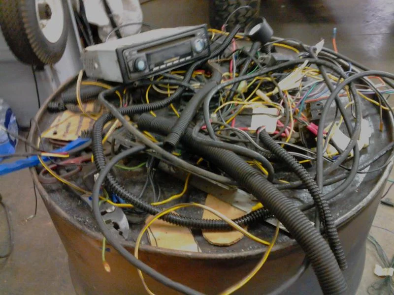

THIS has been a priority all along. Been fun/challenging trying to find/source all these parts from a variety of years and models then fit them together and make them work right.

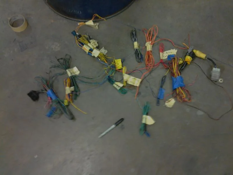

Did I say fun? Hey Kevin, what the hell is this wire for??????
make a wiring diagram as you go along :doh:
I do not think that is the first time they heard that... ;)
Mostly wiring to the '88 FJ62 diagram, taking notes, modifying the diagram to reflect the changes.

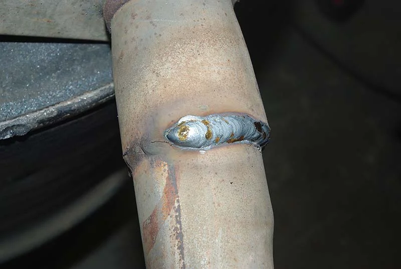

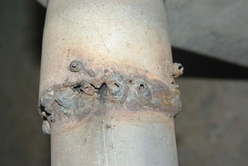

I was a little embarrassed about my welding on old, rusty muffler pipe skillz, till I looked at what the pros previously did!:eek: Anyway, cleaned that stuff up.
