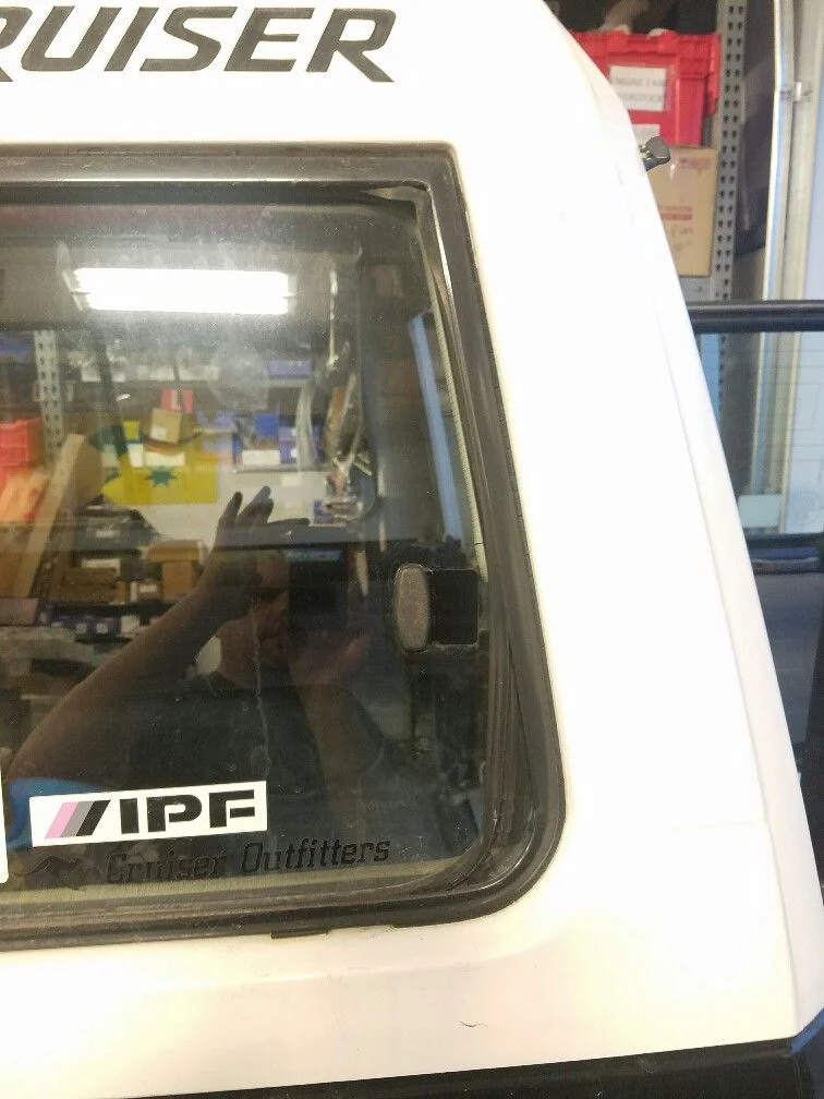

The cost of the FRP top side window runs was low enough I decided to experiment these eve. You simply can't remove the glass without removing the frame and you can swap the one piece w/s without removing the glass. But, if you remove the latch mechanisms you can slide the windows far enough to each side to allow replacement the w/s when cut in half. I used a bit of black silicone at the joint and it turned out quite tidy and FAR better than my leaky-noisy original w/s. I still need to do the second window but it should take more than an hour now that the process is sorted.
Before look:
After:
When it comes time to pill the frame.... yuk!
Replacing a Sliding Glass Window in 75 series Troopy
Appreciate the photos and info Kurt! My poor 74 has been sitting far too long and needs some attention to get her back on the road.
My side windows have some awesome purple tint on them. The tint must've been a Japan mainland special, but I think i'll be removing it in favor of a bit more blase 20% charcoal color!
Mine had tint on the top side and back door windows. I removed all of it using vinegar and garbage bags to keep the tint wet while the vinegar did its work. MUCH better visibility out. Handy when right-hand-driving in a left-hand world.
