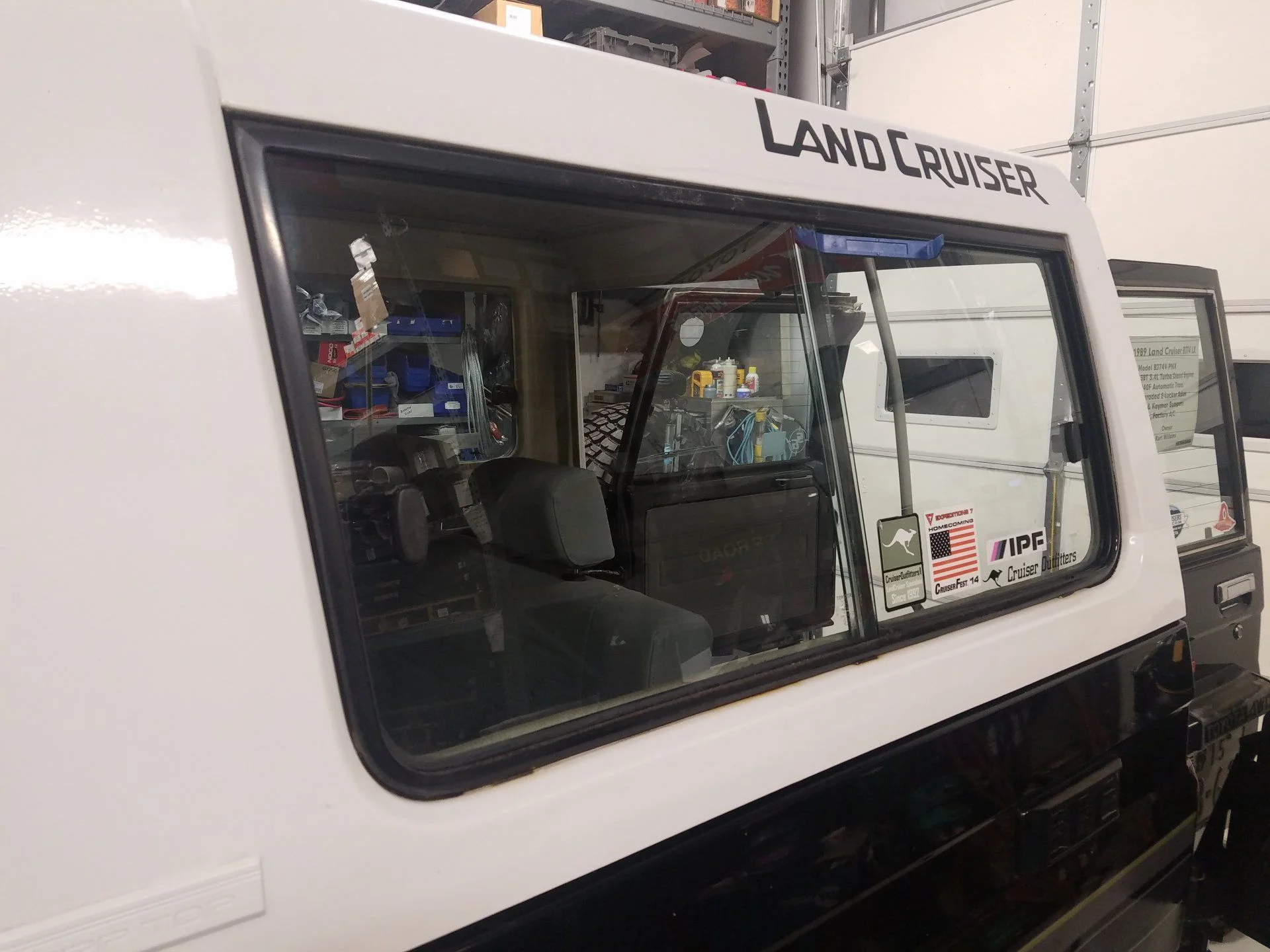

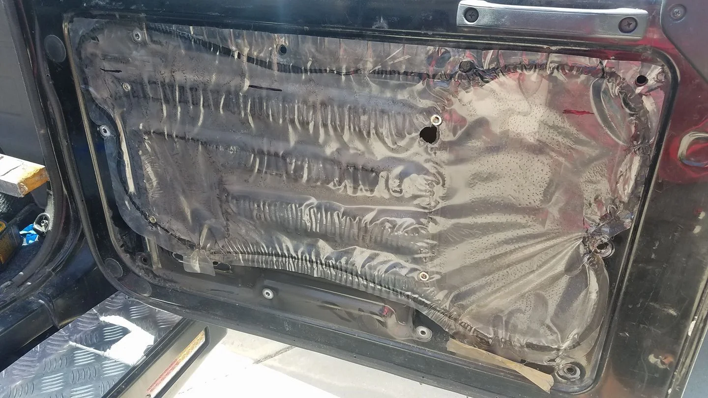

Got the otherside buttoned up. I don't look forward to pulling those frames. Even with them pulled your going to have to do some creative tweaking frame to get the glass out. I don't think it will be a huge deal but the glue cutting may be.
And I forget to snap a picture of one of my new favorite mods
I need one of those ^^^^^!!!!
Do you think new powder coat would be flexible enough to survive the process?
I'm sure it would. You can nearly squeeze the glass out, 1/8" more and you're golden. they are quite flexible so I worry about getting them out without tweaking. As the cross section is quite uniform, it's quite possible a sheet metal shop could make lengths of it. Bending the corners would be tough but the two top angles are just cut/welds. That will have to be a rainy-er day project.

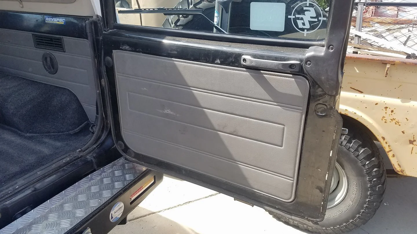

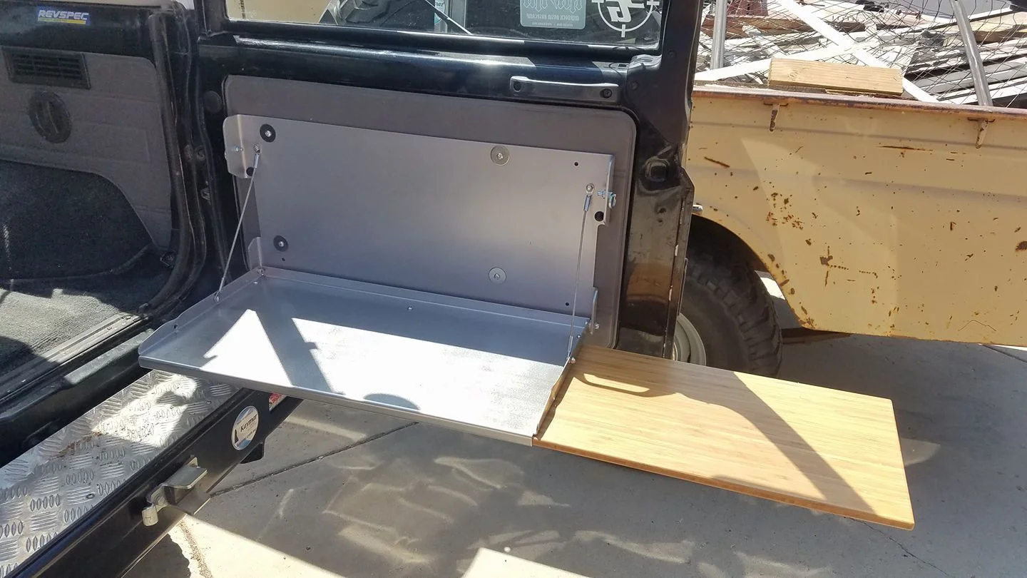

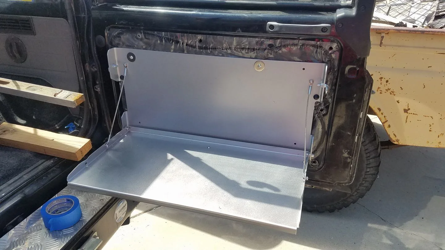

Got the barn door blues? Me too, time to finally getting around to fixing it. Camping out of the 74 last week for the Relic Run reminded me that I somewhat dislike barn doors, more specifically I dislike the lack of utility they offer. I'm a "cook brekky on the tailgate kind of guy" and I really missed having that space. I've had this table kit kicking around for quite some time and I finally had a few hours this am to do something with it. This is a bit of an attempt to meet the need with a super high quality product. Outback Adventures is a good friend and Cruiserhead, he started making these 5-6 years ago? Maybe more. We had them in both of the Expeditions7 VDJ78's and they proved extremely useful.

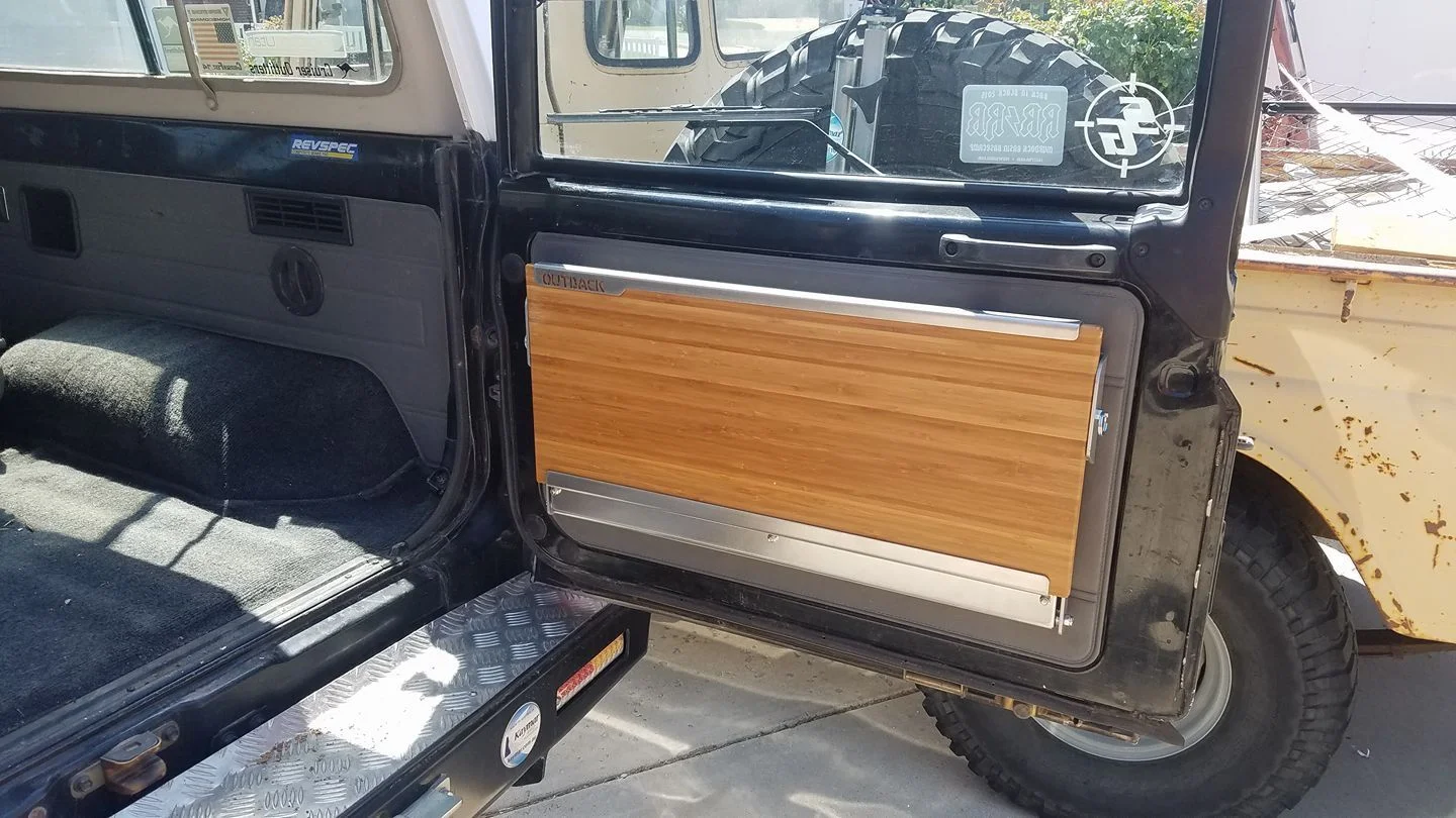

His kits are designed as a direct bolt-in for JK's but they feature a flat back so really all they need is a straight panel to mount. Well the 7x Series has just that on the right hand side and the width is near perfect. It does require some searching for 4 somewhat uniform locations to add the nutzerts. With those set, I transferred the holes to the door card and then finally bolted it up. Totally digging the added space and the cutting board too!
Folded up, nice and rattle-free
I have admired those units in the VDJ78s for some time now. They are very nice but they do require a well-stocked billfold.:)
Fortunately Doug needs parts every once in awhile so we could do some trade action.
