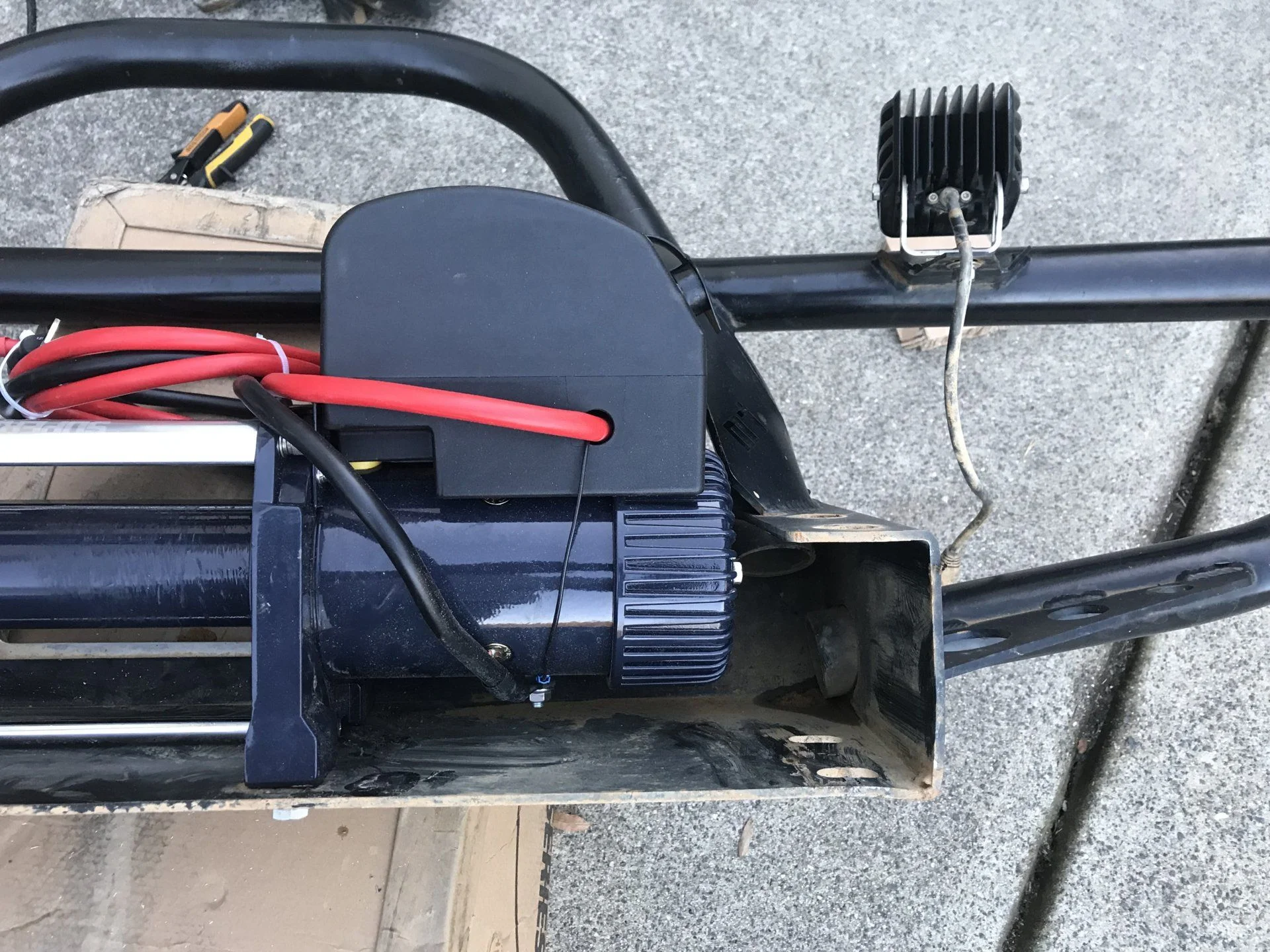

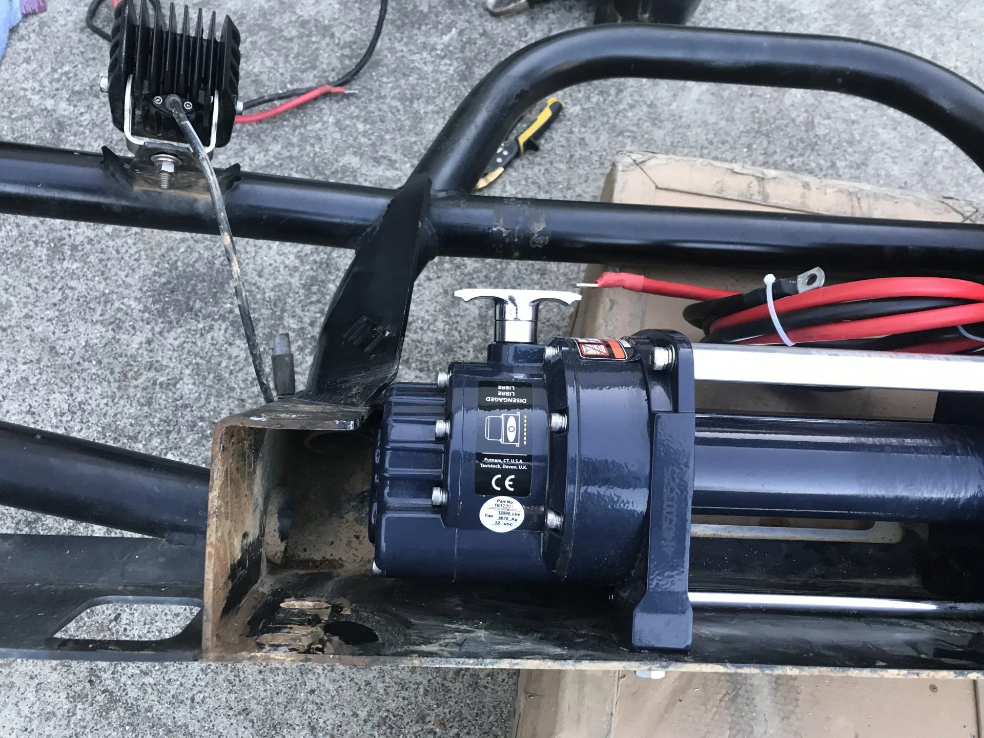

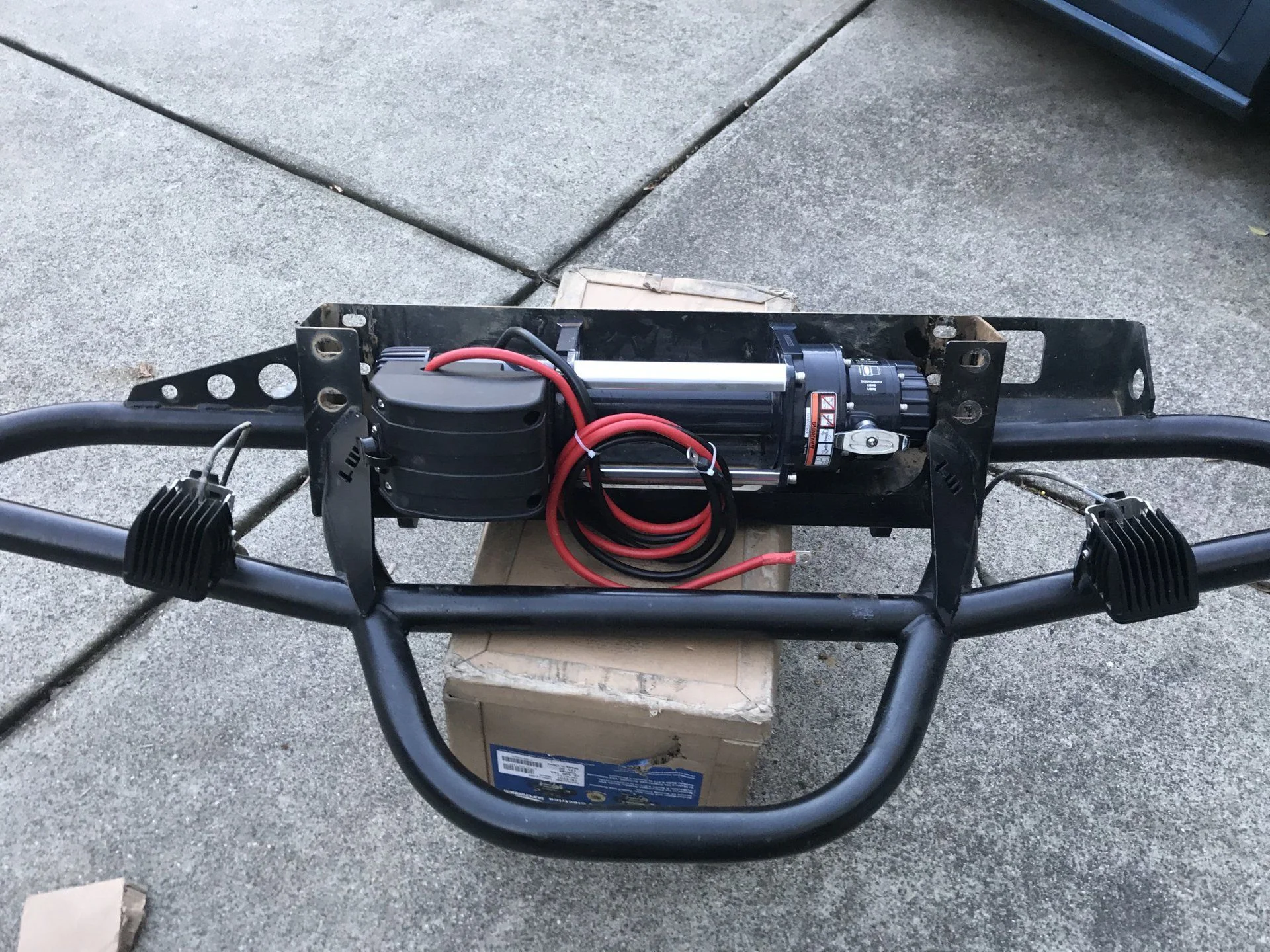

Got the Superwinch Talon 12500 synthetic ! Installed this afternoon, it has tight clearance on the bumper, but it did fit. Will finish installing the line tomorrow.

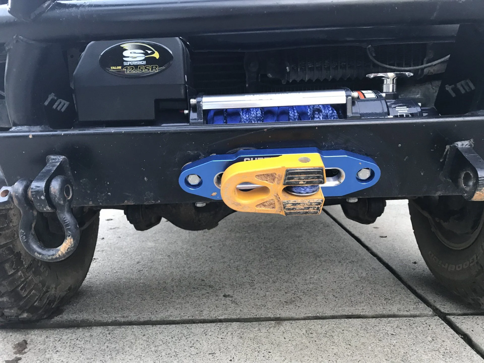

Line is in. MPretty....
They need to make that thimble in bright red, so it looks like a tongue sticking out LOL
Is the extra blue cover a tree protector or suppose to be on the first line on the drum to protect against heat? I have heard both ways.
Well, both ways are wrong. All Superwinch winches use external brake to avoid heat on the drum, not a problem with steel line but does affect synthetic line life. Thats one reason swapping a synthetic for steel on an old winch can be a bad idea if the drum brake is internal (most common design), and will degrade the synthetic fibers as they insulate the drum. Steel line dissipates heats very well, but also can dissipate body parts if it breaks. The blue cover is an abrasion resistance sleeve. it slides anywhere in the line you need it if, for example, the line is going over a rock, root, log, or other surface that could abrade the line. You can buy more of them and are easily replaced too of course.
And never use the winch line around a tree, use tree protector for that at least 3" wide.
Another good use for the sleeve is to keep it all the way out on the line so that when it wraps up it provides UV protection for the line itself.
Should not have said tree protector and would never wrap around a tree. ;<)
