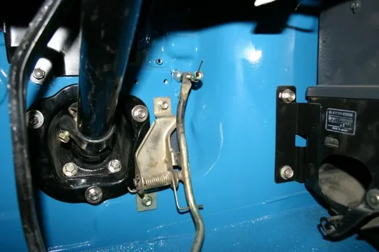

Also took some pics of the accelerator pedal, and bolted it up to the firewall....I think you can see the problem. Like I said, I can only assume on LHD models the pedal different? :confused:
I made a couple drawings of what I would think a LHD pedal would look like. I'm hoping Mark or someone can get a few photo's of a LHD unit, just to confirm this?
Couple drawings of what I would assume (ass-u-(and)-me) the LHD pedal would be shaped like?

This style is from a left hand drive 1979 fj40. Notice how it straddles the column mount flange. maybe one like this would work but it uses a hard rod linkage and not a cable.
Second/third pics are from one I picked up at a swap meet. i think its from a 76 era. it has the extra paddle which contacts some sort of switch which I believe has something to do with emissions.

On the '79 40 we basically have a modified pedal like the picture above. Removed the hard linkage, and replaced with a Lokar throttle cable. It was easy, and works great.

Just got this pic via the Netherlands, thanks Mark! aka Troopie.
This is off a LHD 1982 BJ45. Kinda looks to be a combination of the what I have and the linkage type pedal?

Here's the not stock, aftermarket/modified pedal in the '79 FJ-40 (modified with the 3B).
And here's the stock pedal in my '76 HJ-45.
Don't most Chevy conversions switch to a cable? I think that's where the modified pedal in the '79 came from--I think. (the PO had a Weber on it, and when we switched back to Aisin years and years ago that pedal ended up in the spare parts box--was pretty nice when I realized I needed one for the 3B).

Another pic via email I just got.....supposedly came out of the stash!! :p
The pedal out of that 76 looks the same as the other style. Looks like they mfg. a little more bracket on top at some point?

You could also modify a 70 series or 80 seried pedal. That's what I'm running on my 40...just a little bending to get the angle right for the pedal and that was it. Since you don't have holes drilled, any mismatch is a non-issue.
