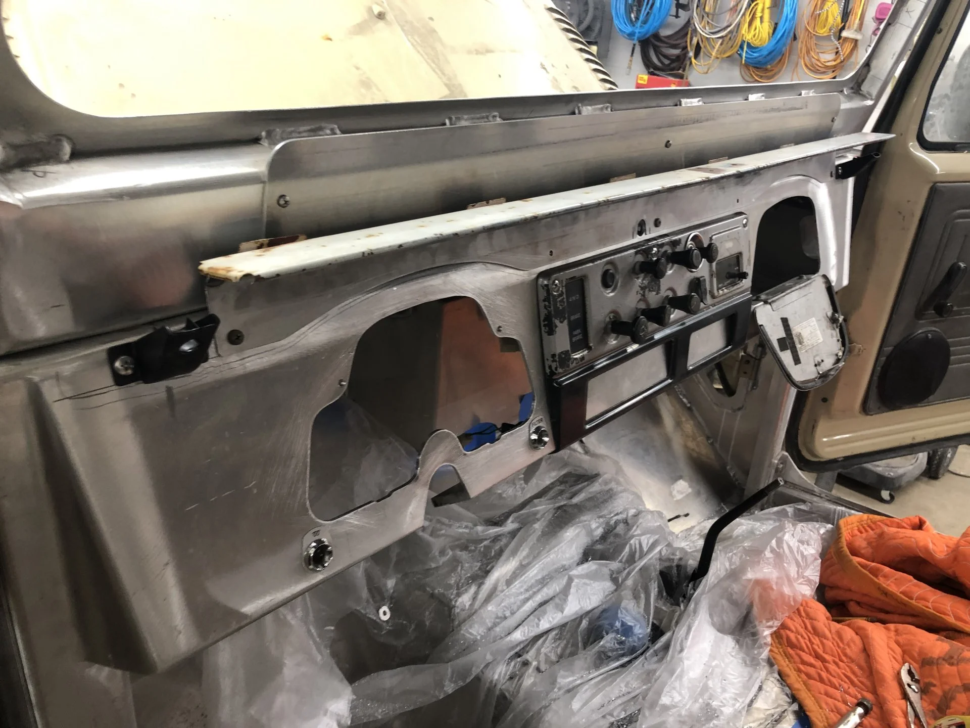

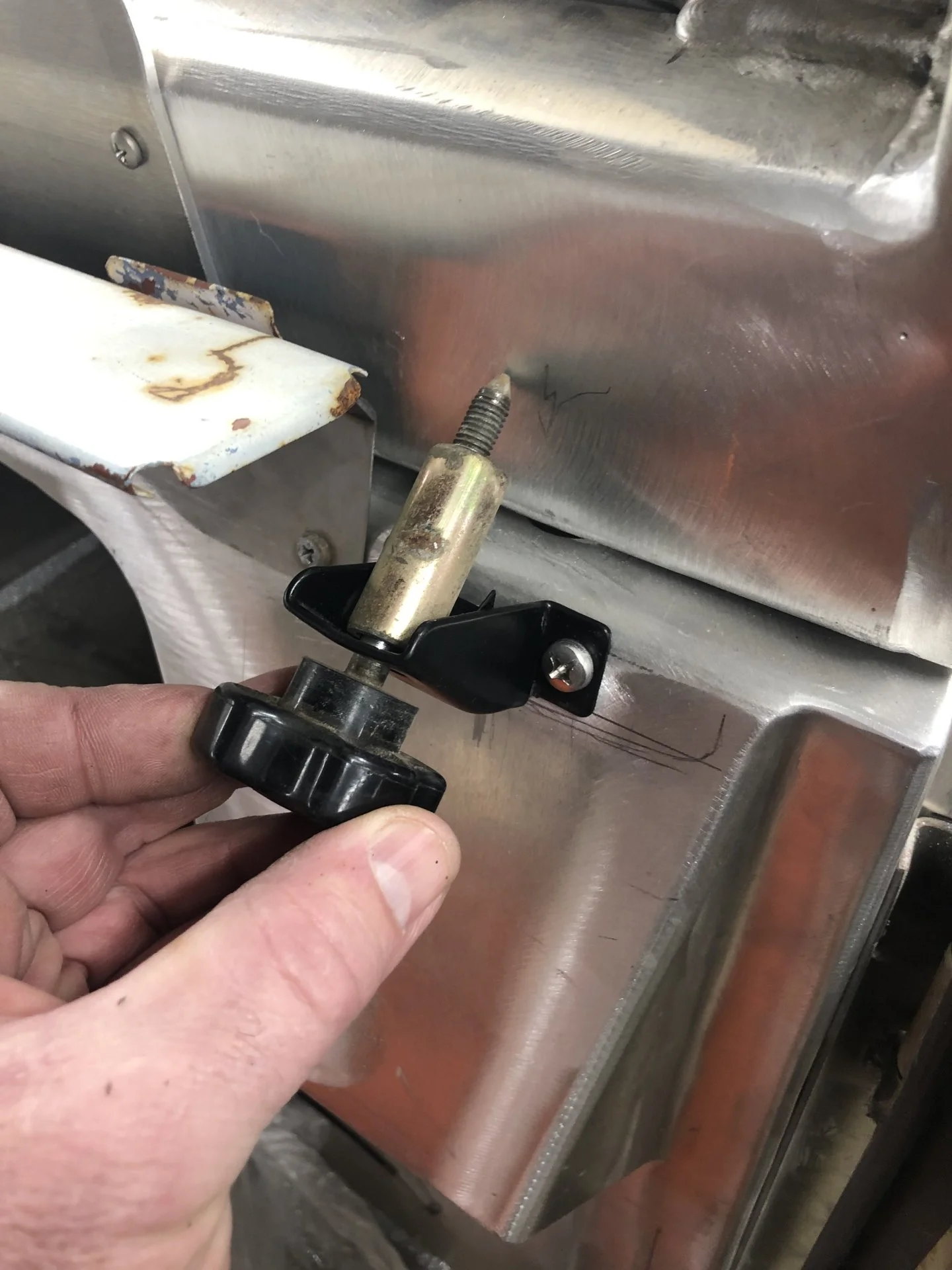

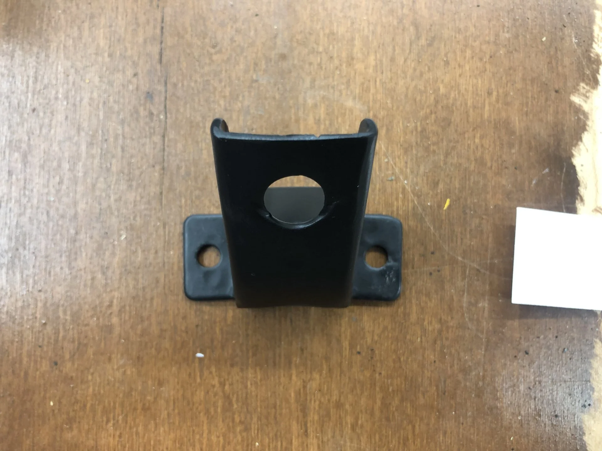

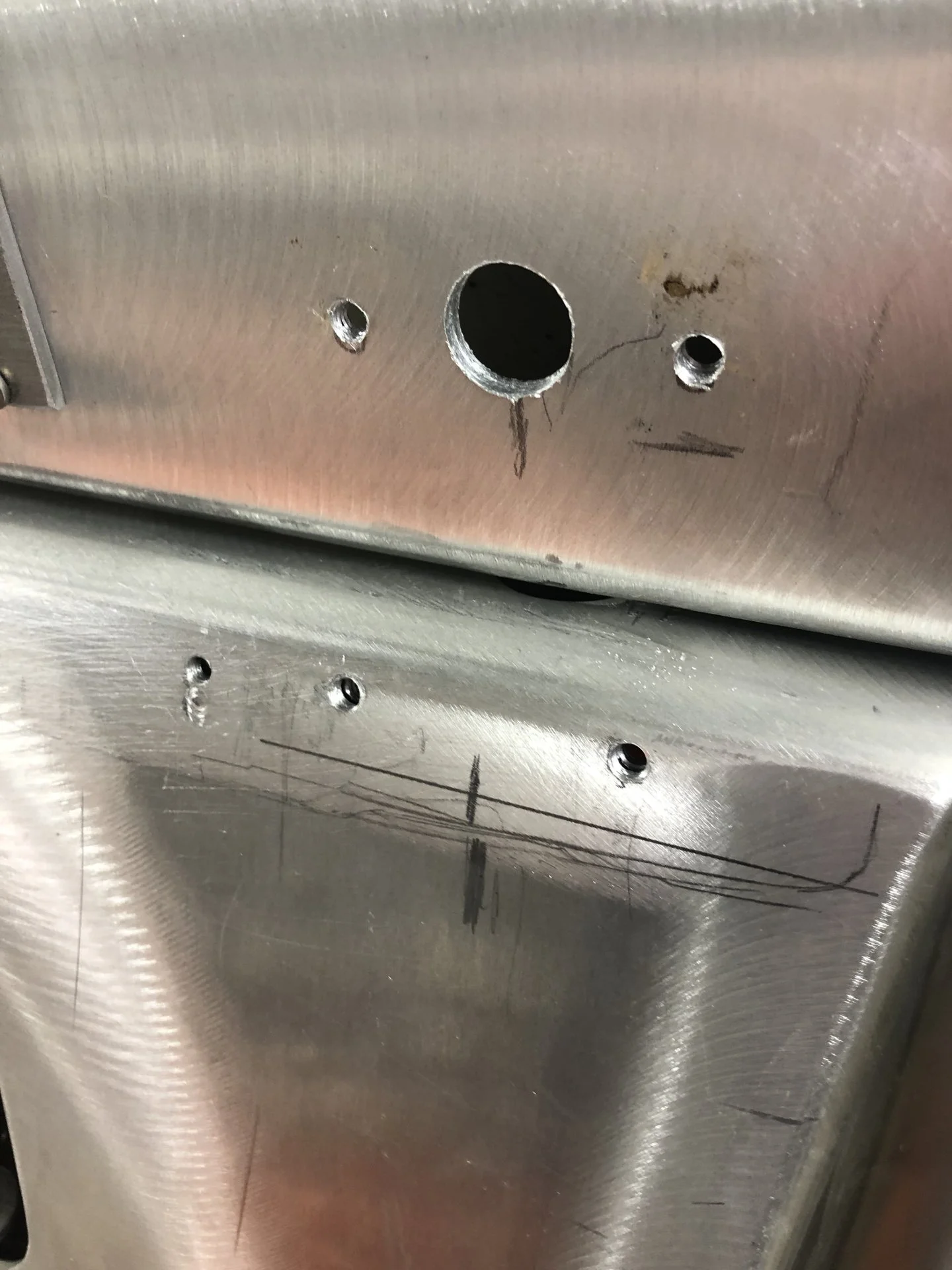

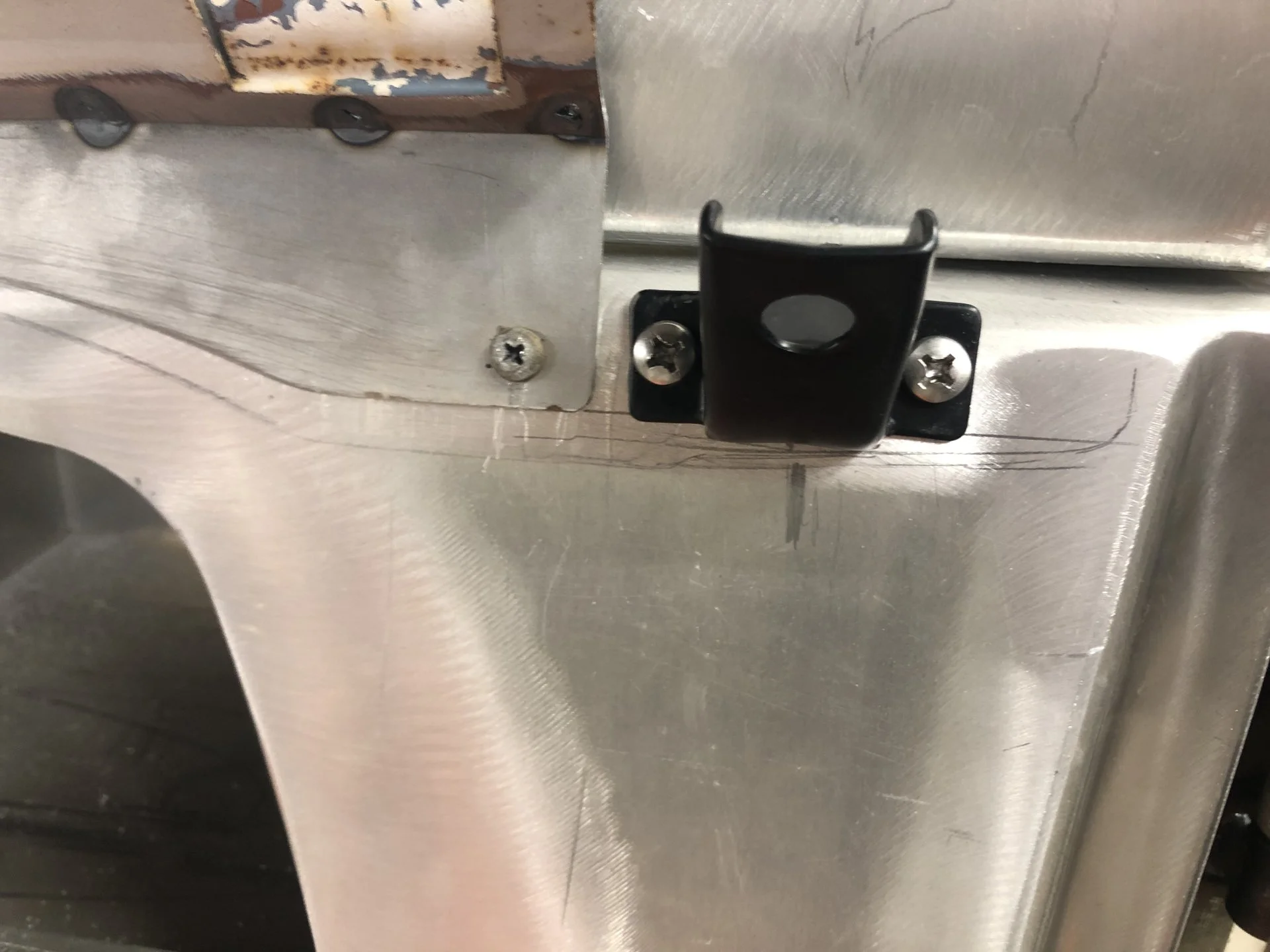

Managed to get an hour or so in tonight.

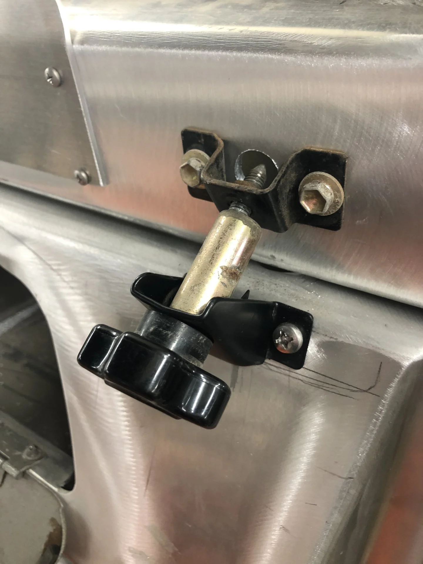

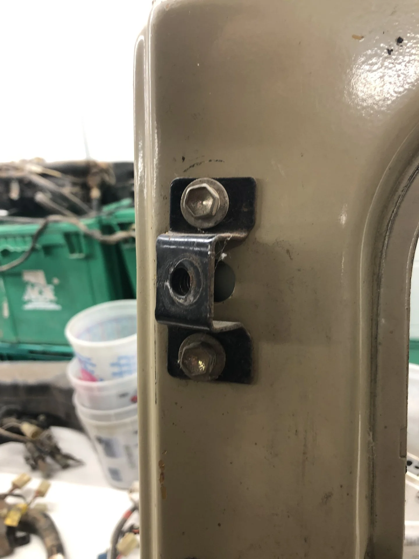

Welded up the spot welds on windshield brackets, drilled a 1/4” hole, cleaned them up and painted. Using the 79 firewall I have I measured off the dash holes and references where the brackets were. After marking, drilled and tapped with 6mm x 1.00, used a wide head machine screw to mount. Took the old brackets off the windshield frame. Using the hold down bolt I thread that in and used that to mark where they should go on the windshield frame, worked very well. Drilled, tapped mounted. Re-installed the dash. Cranked in the hold down bolts in the brackets. Factory as I can make it.

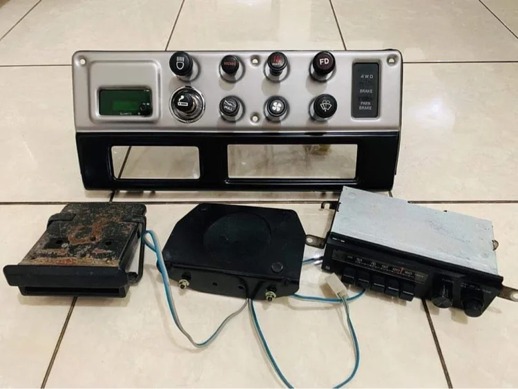

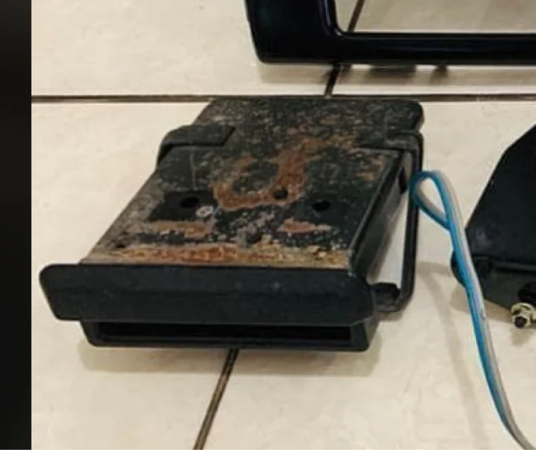

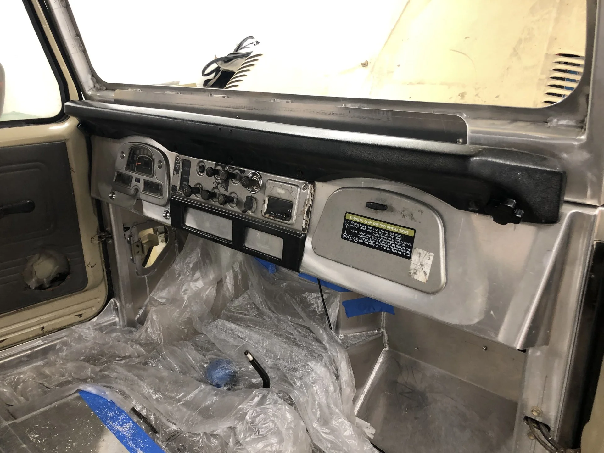

If any of our overseas friends have their eye on the ash tray assembly from an HJ47…I’m in need of one. I need the ash tray and the assembly it slides into, like the pic.
Matt.

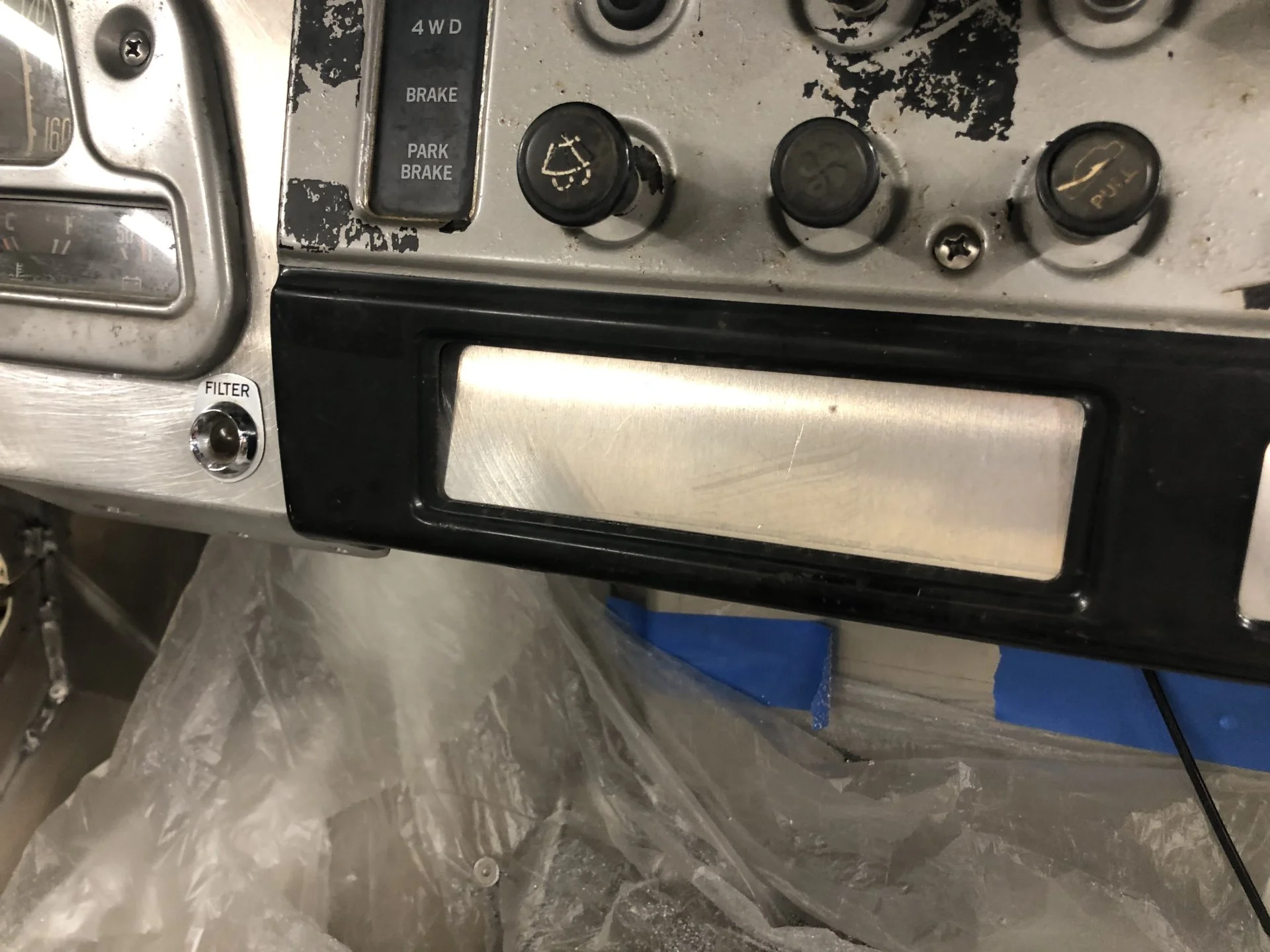

I was looking at the radio area tonight. I ordered this brand new pioneer radio about 12 years ago, talk about putting the cart ahead of the horse! Never even opened.
Most, if not all radios, have a standard 2 1/8” x 7” opening, like the pic on the scrap 79 dash, with that insert. The opening on the hj47 dash panel measures about 1 3/4” x 6 7/8”. I’m wondering if they make a radio to fit that? Possibly blue tooth or something but old school?
