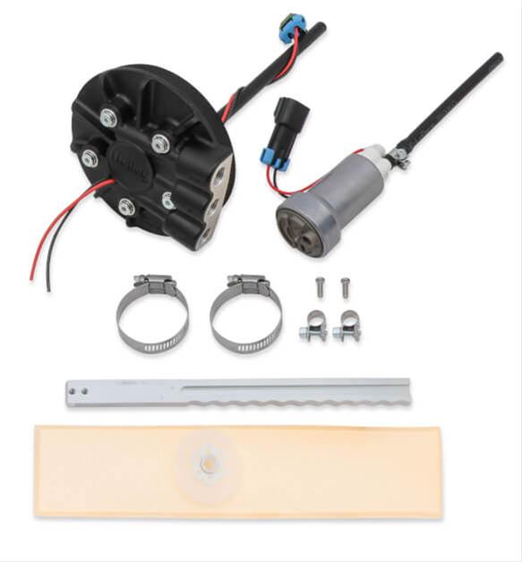

-finally after much much deliberation and measuring and looking and moving this thing around, I finally cut a hole in this bigass tank and installed fuel pump. It’s a Holly setup and come with a Holly Hydramat pickup, if any little part of the mat is touching fuel, it’ll work.
due to the body being in the way, I had to mount it toward the front of the tank, but bent some aluminum and was able to push the mat about 2/3 of the way to the back of the tank. I will have to be very very low on gas and going up a very steep ledge for it to starve.
the fuel gage sender thing was extend about a 10” and fits just 1/8” off the floor of the tank on “E”

Wondering why you couldn't use the other hole, the one that aligns with the trap door in the floor. How are you going to access the pump when the tank is installed?
