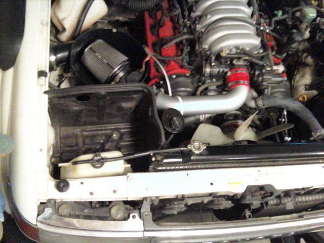

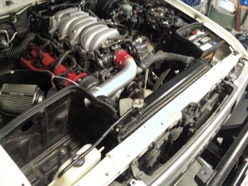

It is alive and on the road! Some iForce powa
I hate to be dense but if the 4.7L works with the 100 series tranny and transfer in an 80, why wouldn't the 5.7L? I'm ignoring the tranny may not bolt to the 3UR.
Not the easiest thing to find a 100 donor, but any of the other donors with v8 has the transfer case outputs centered in the rear and wrong side on the front.
This truck was done with LC parts and a Tundra ECU with LC harness. That complicated matters, however you do not have to deal with chipped keys. It would be easier to deal with chipped keys than what we did on this one. You can bolt the 80 transfer case to the 100 tranny. So you need a 4.7 of some sorts, a 100 harness & Ecu with keys and a 100 tranny.

Nice! That install looks fantastic. I need one of those fan shrouds!
Are you capable of making the a/c lines in house? I had difficulty finding someone that could crimp the odd sized hoses. I saw yours was not installed yet. Mine was also a bit tight around the p.s. lines, but fix that and also re-routed the brake line in front of the steering box.
Did you tuck the MAF sensor in the filter box, or is it in the tube? Im thinking of re-doing the air cleaner box.
How far forward is the transfer case?
did you cut any part of the tranny tunnel for the t-case?
AC lines are next, but we have a shop in town that can do them.
[quote
Did you tuck the MAF sensor in the filter box, or is it in the tube? Im thinking of re-doing the air cleaner box. [/quote]
Maf is in the tube
About 6"
Nope,
