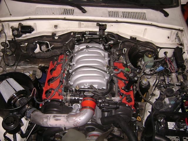

It is alive and on the road! Some iForce powa

If it isn't plug and play, I don't see many people taking this project on. That includes any work that needs to be done to the 2UZ going in. Most of the 2UZ's of this era are well past 100k miles if not more.
We are working more towards us having all the parts to do the swap in house. That is the only way to get to a reasonable $ figure to do the swap. If you have to make one-off pieces every time then it simply is not worth it. More money up front to put parts on the shelve, but then we can sell them if people want them.
This will never be something you sell from a on-line shopping cart and the just deliver and it is plug and play.

EDIT: I should clarify what I wrote. There is a tremendous amount of work that goes into doing something like this correctly and not just cobbing things together.
1. Procure replacement powerplant and drivetrain. Fix all issues and bring back to new. Considerable amount of work and money goes into that.
That is the part that takes time, but if you can take the guesswork out, the custom fab and the re-inventing, then it becomes easier.
2. Modifications to engine mounts, frame, PS system, AC system, EVAP system, then procure harness and necessary ECU's. Mods to driveshafts if needed. Lift if needed to get oil pan to clear if that is an issue over the axle and tie rods.
Driveshafts are easy, no lift required, ac system is some custom hoses, wiring is the only thing that can not be pre-made.
3. Then make it work--welding, cutting, measuring, fitting, putting engine in and out of frame.
True, but I believe we have the dialed in. We should be able to repeat it stab the motor only once.
Christo and his guys make it look easy. They are the pros. They got $$$$
;) :grinpimp:
This was not easy and took time, but I did not want to do this for a one-off project. We are looking for a viable Toyota replacement for the 1FZ.

I would rank them in about the same :banana: scale. However if we do this right I think the engine swap can be cheaper.
I like the 100 with the SAS more due to the more modern truck that you end up with. Catch is you are building a big truck with lift. You can do the 80 with v8 on stock height.
I have to say that I like driving this one, but miss the heated seats (0 F outside) and space of the 100. With money the interior of the 80 can be rejuvenated and made better.

We are nowhere near a kit or pricing a kit. As explained earlier, don't expect a plug and play kit in terms of getting it running. It will just be parts to make the swap easier.
Thats funny. Looks almost exactly like mine, right down to the way you mounted the PS res.
I need to make a shroud like yours though. Mine isnt vvti, but none the less I love driving it. Been beating on it since february of last year and it still turns me on, when I turn it on :D

Doesn't suck more that doing an axle service on a 80. Yes compared to swapping it on a 1FZ, it is more work, but honestly, it is not that big of a deal. Also, how often do you do it? There are many things on a 1FZ that is a pain, starting with P401 codes or whatever EGR code the all develop.
This is a 100 motor, tranny and transfer case.

He has it fabbed using the 95-up air cleaner assembly. Less work to re-work earlier air cleaners since he has that one patterned already.
That fan shroud is sweet by the way.
