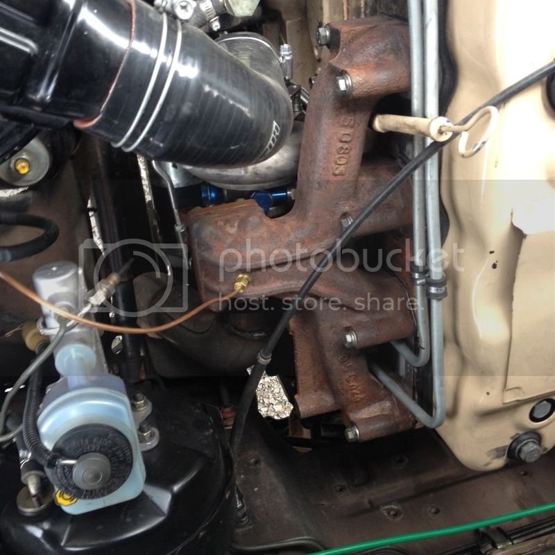

It is a 4.3L 4bg1t. I rebuilt the motor and had it balanced, combined a few things from the 4bd1t and put a different turbo on it. Fuel is turned up a bit.

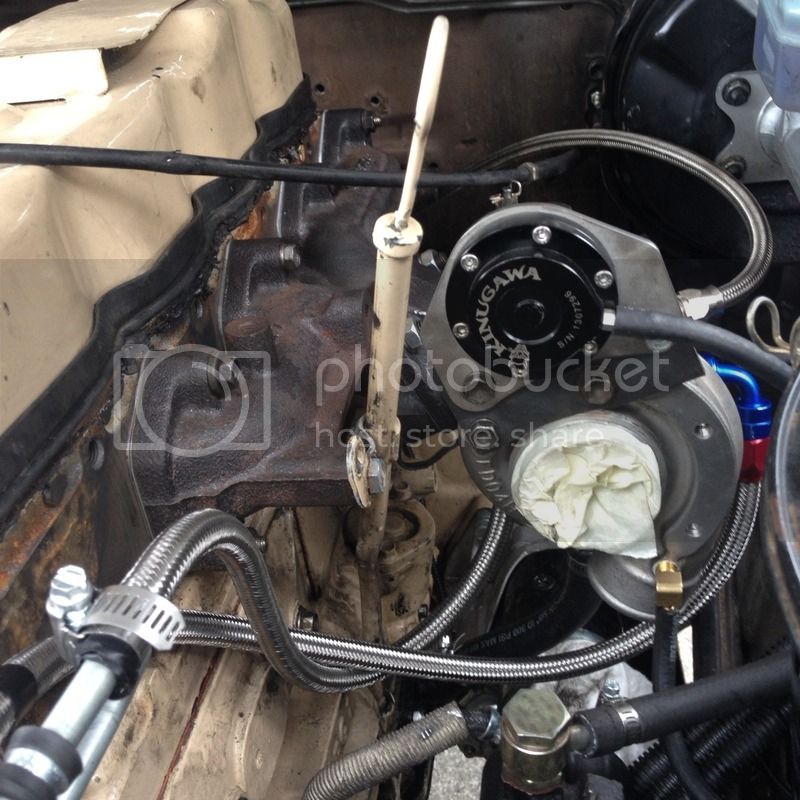

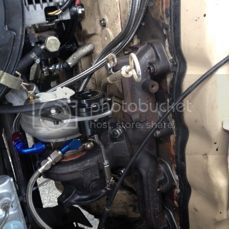

old settup

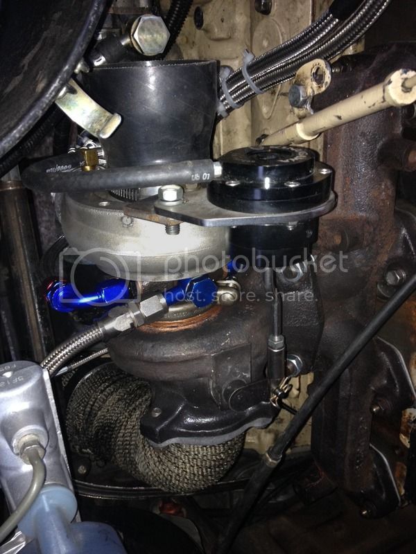

New settup, thanks to Greg, @gerg
After we tracked down all my boost leaks I am very happy with the performance. 4bd1t exhaust manifold swapped over so that it could be oriented correctly, the old manifold had 4mm of offset from the head port to the exhaust manifold... The alternator was lowered so that the inlet for the turbo did not require an aggressive bend. Downpipe made into 2 pieces so that I can actually disassemble it without a sawzall... The turbo went to a 7cm exhaust housing, extended tip 19T compressor and a 9 blade turbine wheel, all gerg's idea. Max egt's are 1,100 making 26psi at the same fuel setting as before. Engine drives much better and feels a lot happier.
Great news. I couldn't see how that previous manifold flipped could have enough material to still seal!
