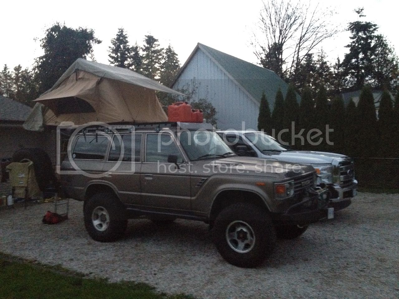

So this morning Mike and his Wonderful wife departed on there possibly 2 year long trip in this truck. that last two weeks where defiantly a mad dash.
I'll post some pictures I got from him the last couple weeks.

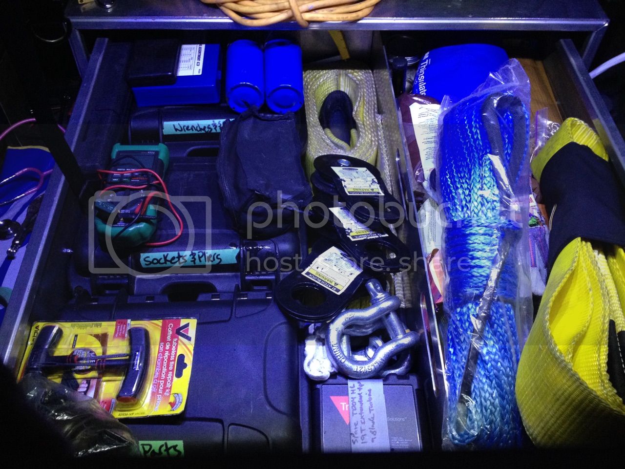

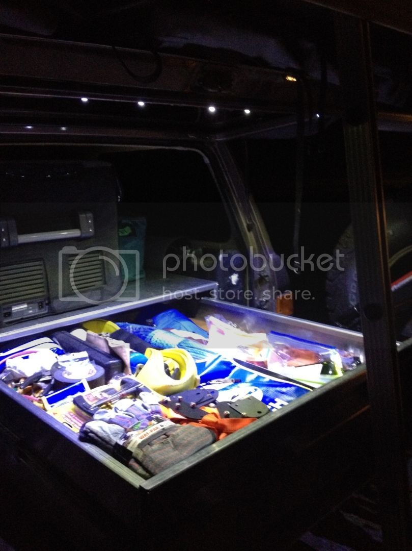

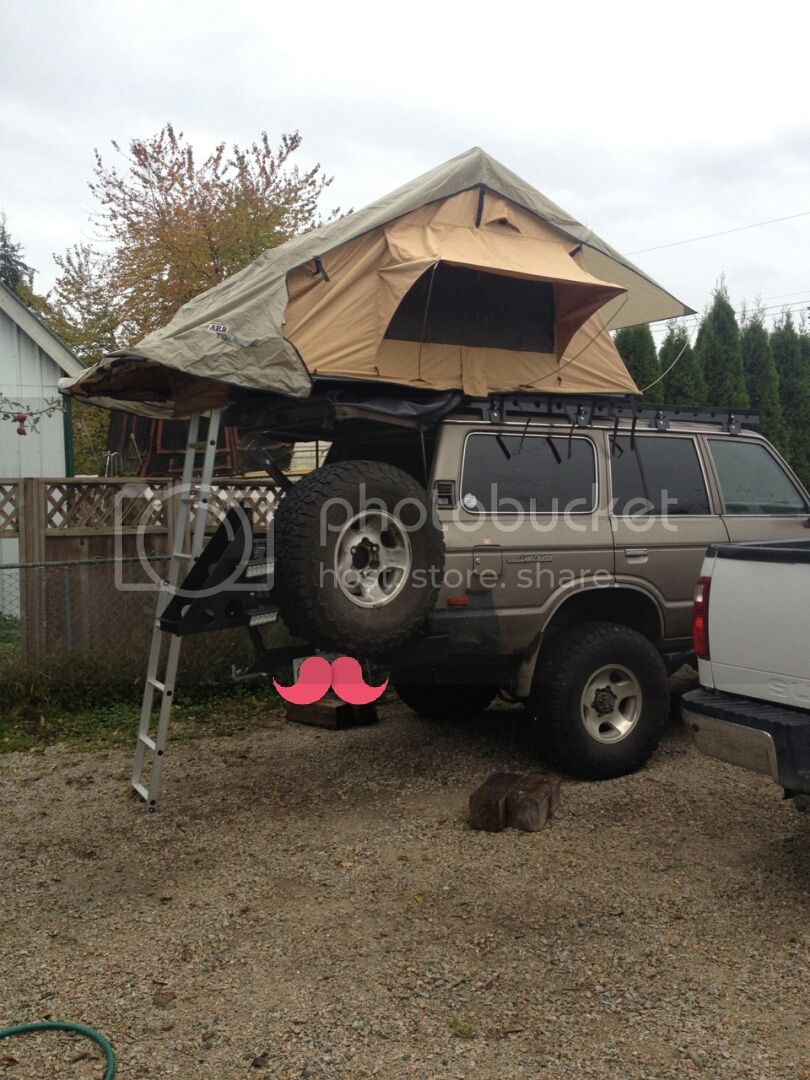

We went up and got his drawer about 2 weeks ago it's amazing, supper light but crazy strong. they units are made for the back of Police Tahoe's.
Drawer organized.

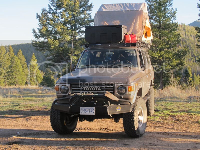

Tent mounted on his custom Cruisin off road aluminum rack.

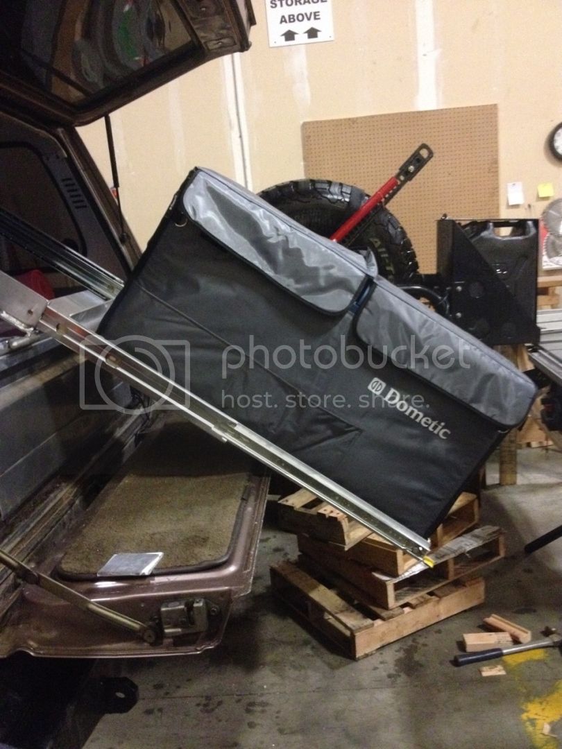

Lastly his slide out for him Dometic 96L fridge / freezer.

It is indeed a cool set up. I like the fridge tilt. Simple and effective. That is a serously big ass fridge too!i think I'll be incorporating many of his tricks into my truck. Eventually....

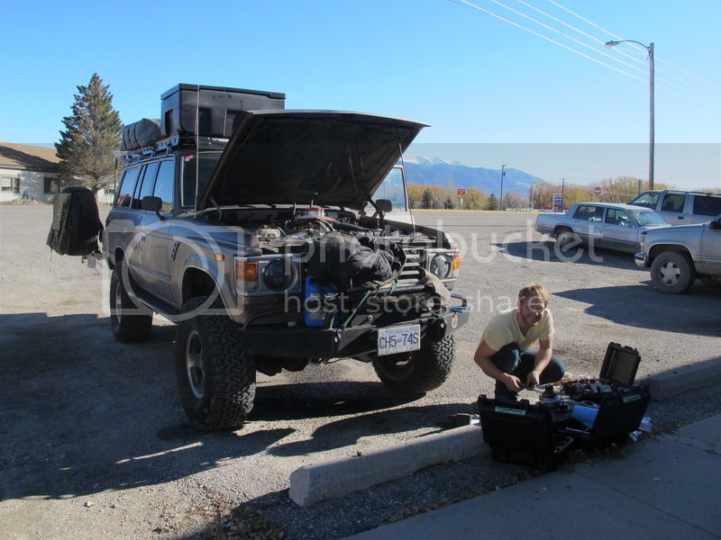

So we did White Rim trail today, and about half way through the pump felt like the injection pump kept loosing prime and then it would start back up again. Fortunately we made it back to town...
I pulled the main filter and it was full of fuel so it's not running out of fuel, it is an intermittent problem. I replaced the filter just thinking it may be a feed problem. Got a little better, couldn't get the Parker filter off so I'm waiting for it to cool down so hopefully I'll be able to get it off then....
THe problem only happens after about 30 seconds of heavy load, or high fuel rate for example pulling onto the highway it crapped out when I shifted into 4th gear and I had to coast for a bit before it picked back up.
I checked the screen in the lift pump and it was clear. Could the lift pump be the culprit? I can't imagine it would crap out in 15,000km... but maybe? The lift pump wasn't getting filtered fuel for the first few thousand km... When I fixed all that I found a ton of crud in the screen before the lift pump... maybe that killed it? It still runs now, I don't know much about lift pumps but are they are work/don't work type of deal? Or do they fail slowly?
There are NO diesel mechanics in Moab, well there are 2 but I've been to both already 1 was MIA and the other was completely useless.
Two things come to mind if the in tank screen and fuel filters are good:
1) On the IP inlet "Banjo" fitting bolt, there is (Supposed to be?) a inlet strainer that screws into the banjo bolt. These can get clogged, as many don't know they exist.
2) Fuel tank venting - If this only happens under heavy load, is the tank venting?
Actually thought of another - Are all the hoses good and clamps tight? Could be sucking some air under heavy load?
Let us know what you find.
Safe travels
Sounds like it's starved for fuel.
Either air getting sucked in somewhere, or a blockage. I'd say blockage. If it's getting air sucked in, injection timing is screwed up momentarily and the engine will most likely stutter and stumble.
If you can't find a blockage you can check for air in the system with a piece of clear tube.

I took Jeremy's advice and carried double spares of all filters... going to up that to 5 sets of both fuel filters for Mexico, because finding the replacements will probably be few and far between. I suspect this won't be the last time I clog fuel filters on this trip...
