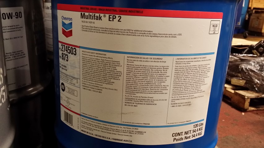

Is this grease ok for our wheel bearings?
Aug 10, 2004
364
5,083
Orlando, FL & Southampton, NY
We have truck loads of this stuff at work and use it on MUCH larger bearings, but they're not exactly high speed :hmm:
I'll be repacking my rear bearings for the first time next week (keep in mind my rig has over 400k on the odometer)
Would this be ok for a repack?
Kind confused with the NGLI 1/2/LB ratings :meh:

I would not use this for wheel bearings. The FSM calls for an MP (multi purpose) grease, which is NLGI #2 suitable for wheel bearings. Looking at the label on the drum you pictured, this is EP (extreme pressure) grease with LB designation. LB means it is suitable for chassis lubrication. If it was also suitable for wheel bearings it would say GC-LB. The Chevron data sheet also mentions non-disc wheel bearings for applications.
Your bearings probably wouldn't blow up if you used this, but I'd use a grease that clearly meets specs.
