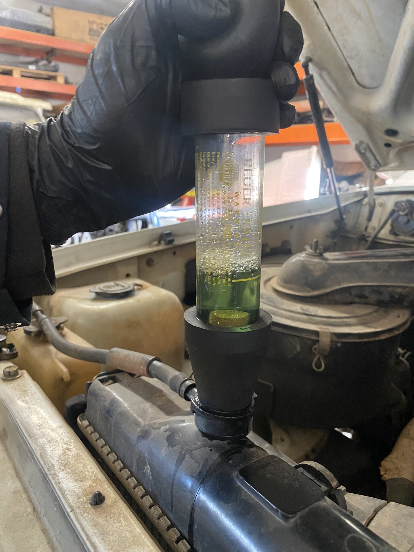

I talked to the shop about how they diagnosed it. After they had plugged in the injector it started to idle fine. But it was very smokey after that. They said later on they moved the car and such, it continued to smoke pretty bad. The test they did, not sure of a name of the tool used. They have a tool that they stick in the radiator and would turn a different color if the exhaust leak went back into the cooling system. They said it would stay green, then it would turn to blue. They did not say they did a pressure test or anything else that @BILT4ME stated. They said the quote given for $8700 was a worse case scenario, the whole head to be rebuilt, fresh deck on the block if it has pitting because of the two different metals. When I go to get my rig they are going to give me some written quotes of other head jobs they have done. As in just do a HG, machine work and a few little items. I am only 9 min away from the shop, should I be worried about causing more damage to the rig IF the HG is bad.
🤔 well a block test is a great way to find exhaust gas in the coolant system. Just weird that you mentioned HG and it failed? Anyways let’s stay on topic. If they pull the head and have it machined and rebuilt which you should make sure they do this if you’re going through the trouble. Now having block decked is a whole different story. They would have to pull your engine remove the pistons. Can’t imagine that’s part of a HG job. If you wanna chat feel free to PM me and we can talk I’m local and have rebuilt quite a few 1fz’s.
So they have a positive confirmation of exhaust cases in the coolant?
What were the results of the test?
Can they repeat the test in front of you?
Yes, that is what they said.
The color of the liquid in this tool they use would turn from green to blue often when the rig was running. They would reset it and put it back in and some thing. They also said while it's running and take the coolant cap up, you can see bubbles and gurgles come up to the top.
I will ask them when I go to pick it up here shortly.

Well I went and picked the rig up today. The shop told me that when they ran the test I was just over 2 gal of coolant low in my rig. They did preform the block test in front of me and i have some pictures that I will post here. They are certain it is a bad HG and that they seem to think its the coolant and that electrolysis is a common factor on why the 80s are blowing HG. They quote of $8700 was on the high side because they did a job for a lady who had a cracked head, so they provided a new one, and her block needed to be decked, but she didn't want to do that so they filled it in with some metal. So that price could go down. They also said they don't believe that my head is cracked or too damaged. They recommended a pressure test to really confirm if I have a bad HG. Which I think I might do to see.

The blue liquid is the start, and then the green to yellowish is the towards the end. The car was not already up to operating temperature. They drained some fluid out to do the test for me. After running for 10-15min that is how the liquid turned out.

s***, I guess not... They also recommended to do a flush every two years. I would also expect it to overheat if I was low on coolant. On the 10min drive home, the rig never got above 194 F. I'm unfortunately thinking that yes I do have a bad HG. Even if I decided to have them do it, they wouldn't be able to get me in till mid Dec early Jan. Then they would have it for a couple months, so I wouldn't get the rig back till like Feb or late Mar. Which is winter time lol.
