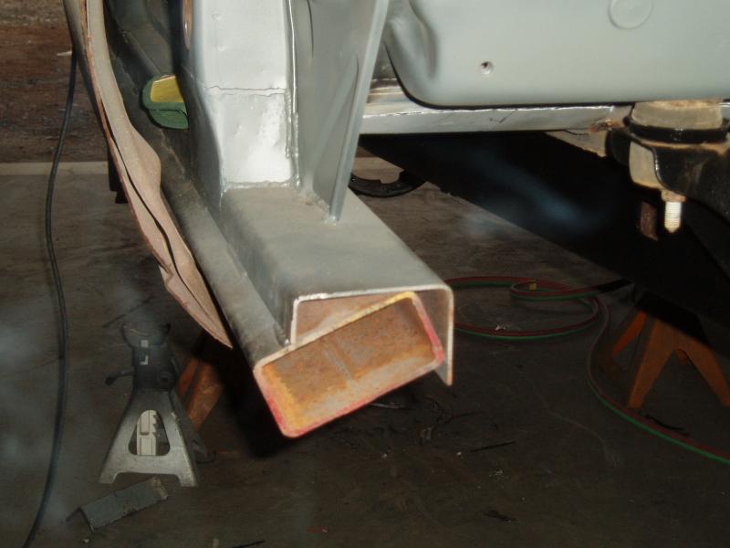

Tubing will work but it obviously won't look stock so it depends on how "stock" is stock to you.
Thats what I did...
@diesellibrarian, there's the pic i mentioned earlier in this discussion. thanks @pistonpete , i was starting to get a head ache bangin' my head on the wall looking for that picture :hillbilly:
Ok, I wasn't the only one. I swear I downloaded those pics for future reference, but couldn't find them or remember where I saw them!
Did the same on a 1st generation Ford Bronco with great results and they did double as rock sliders.

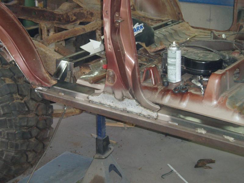

Did similar on my 2002 HZJ105.
I used 3x3" box, and sectioned it so the outer edge tapered in at the bottom by about 1"
I added round tube sliders to mine, with full intention they'd see action in the trail
I dropped the full weight of my rig on them many times when a wheel slipped off a rock etc. They are super strong if the are connected directly to the still structure and the base of the pillars.
I really like the approach piston Pete took with his. A lot less work than what I did.

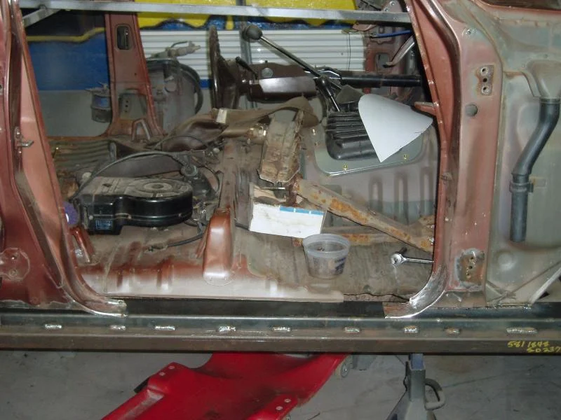

@diesellibrarian , how's your rocker repair/rework going? i've got mine done structurally. just need the aesthetics looked after. 2x41/2-1/8th wall tube replaces the entire rocker from the sill down. will post pics once i get a camera/computer interface issue figured out
