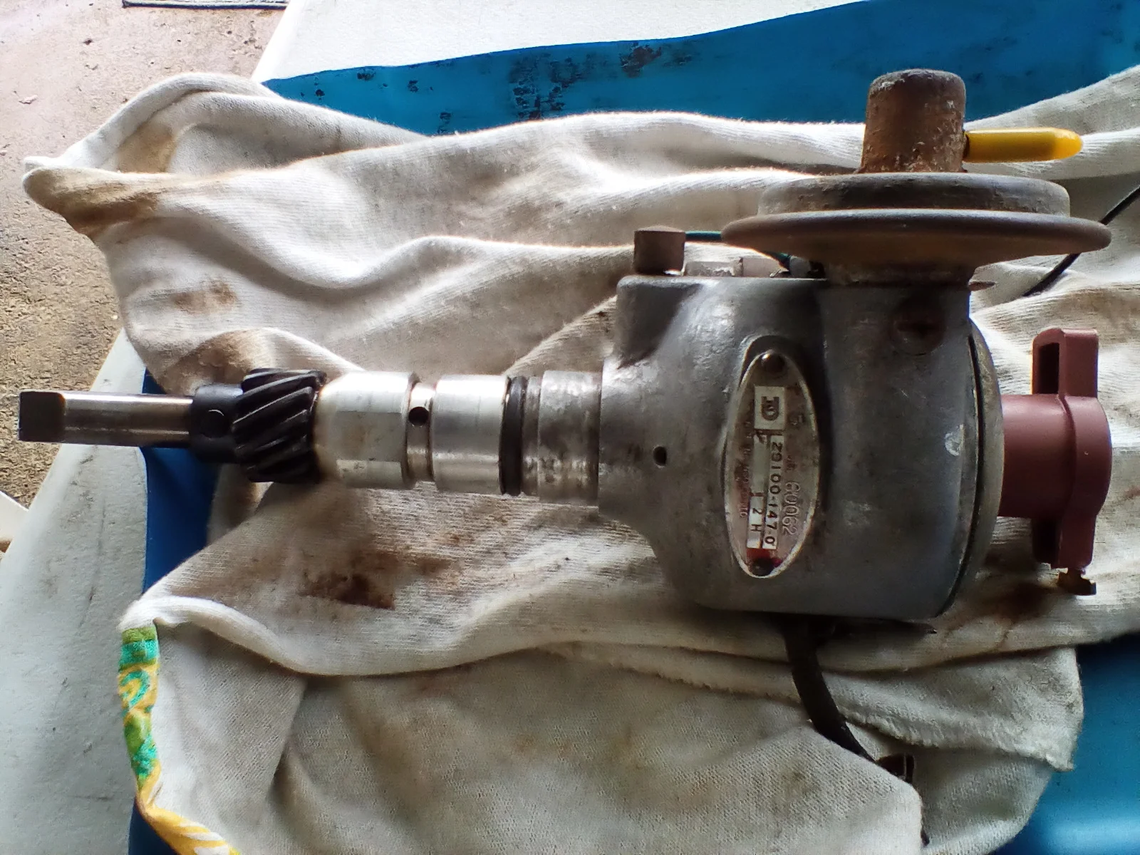

Mines got an aftermarket electronic ignition unit...1970 not sure how much yours differs...make sure it seats all the way down or your oil wont pump....View attachment 3068367

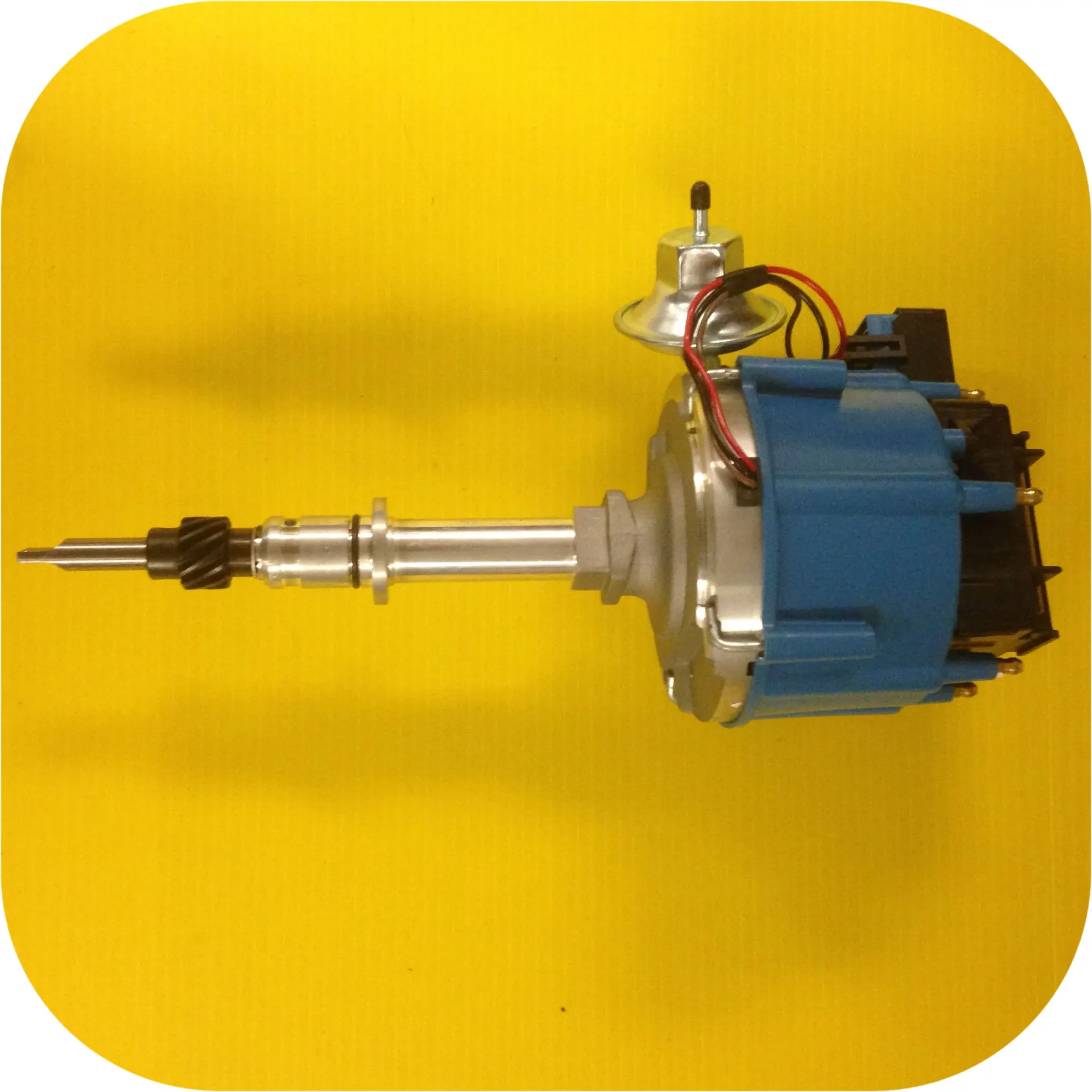

Its a generic one like this...Pics of your electronic doo-hickey....
www.jtoutfitters.com
How come? You saying it's just bound to leak because it's crummy aftermarket part?So, @mrjordann , the link you posted above leads to the picture below.
If your distributor looks like this, then you likely have answered your own question.
