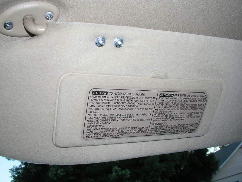

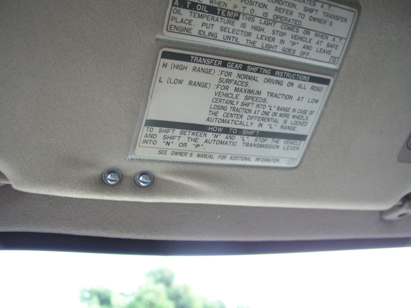

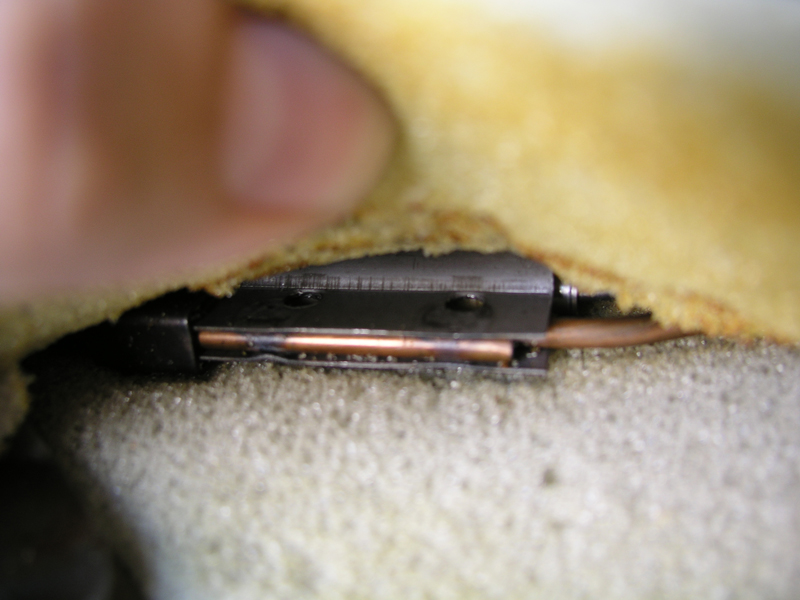

Well after a month of my visor falling down and losing most of my visibility impaired it was time to fix it. I tried pulling the post out of the visor as described in this thread (Post 16 & 19) but it was not going to happen. So I went back to the solution shown here in this thread. After getting the mirror assembly out I noticed that the frame work inside the visor had two holes in it right where others were putting the bolts.
So that made me decide to put two screws in. I used a nail and hoped for the best on hitting those holes as I poked it through the material, no hot nail needed, and somehow nailed it both times. Pun intended...

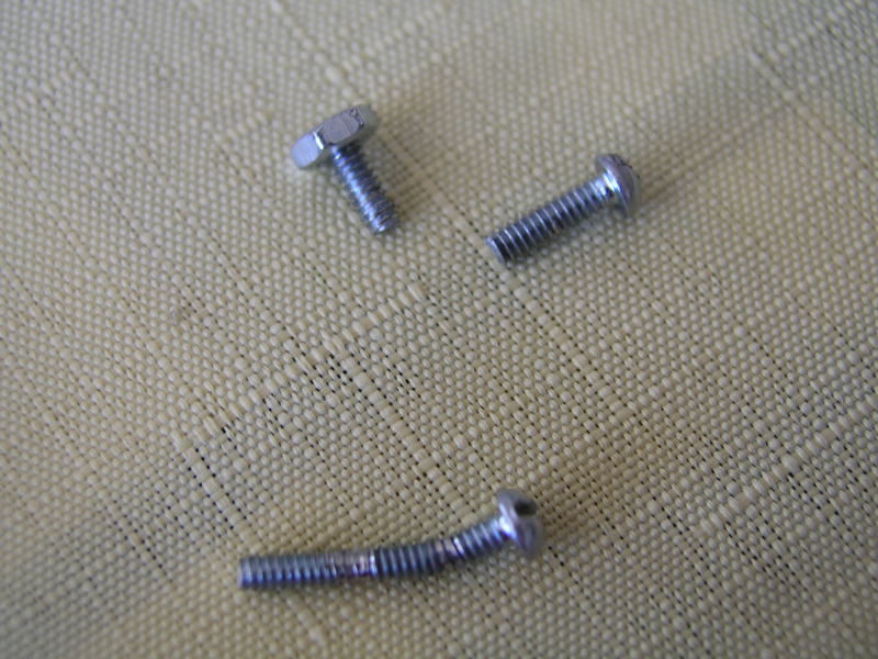

So now for the bolts, that was the hardest part! I first tired some small bolts, size 4-40 x 3/4" but those just bent and didn't tighten enough to fix the visor, so another trip to Home Depot and I got #6-32 x 3/4" and same thing, they just broke.
So yet another trip to the HD and a little drilling to get the #8-32 x 3/4" bolts to get the job done.
Full Album & write-up here: Cruiser-10-Visor-Fix
So we shall see how long this last and when it does I will first try a larger washer diameter and a tighten but I will be keeping my eyes open for oak visors at the junk yards in the mean time. :cheers:

I have fixed my broken image links and I will update you that my ghetto yet effective visor fix is still working 2 years later although I am always keeping an eye out for oak DS visors in the classifieds section.

Wondering if finding something to crimp the sun visor where you put the screws though, possibly to reseat the assembly so it holds tightly. A less-effective, but less invasive alternative to putting bolts through the sun visor.
