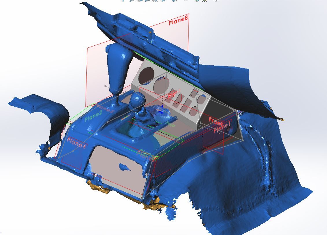

Finally getting some time to push this project forward. Shifter console is next. First, incredibly rough, prototype has been cut on plasma and test fit. The ACC plate will be interchangeable, just seeing how much stuff can get stuffed into the space for now (not everybody is going to need the extra gauges for the @NLXTACY turbo kit). Blank (roll you own), all switches, all plugs, some of each, etc...
Starting with the 91-92 because it's larger. Going to make it so everybody gets the same base, and the top is interchangeable to fit the vehicle.
