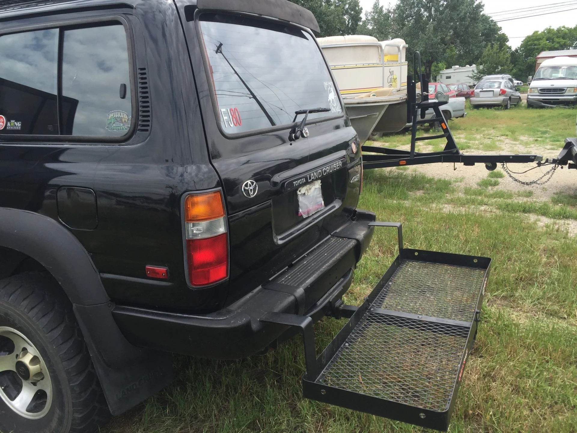

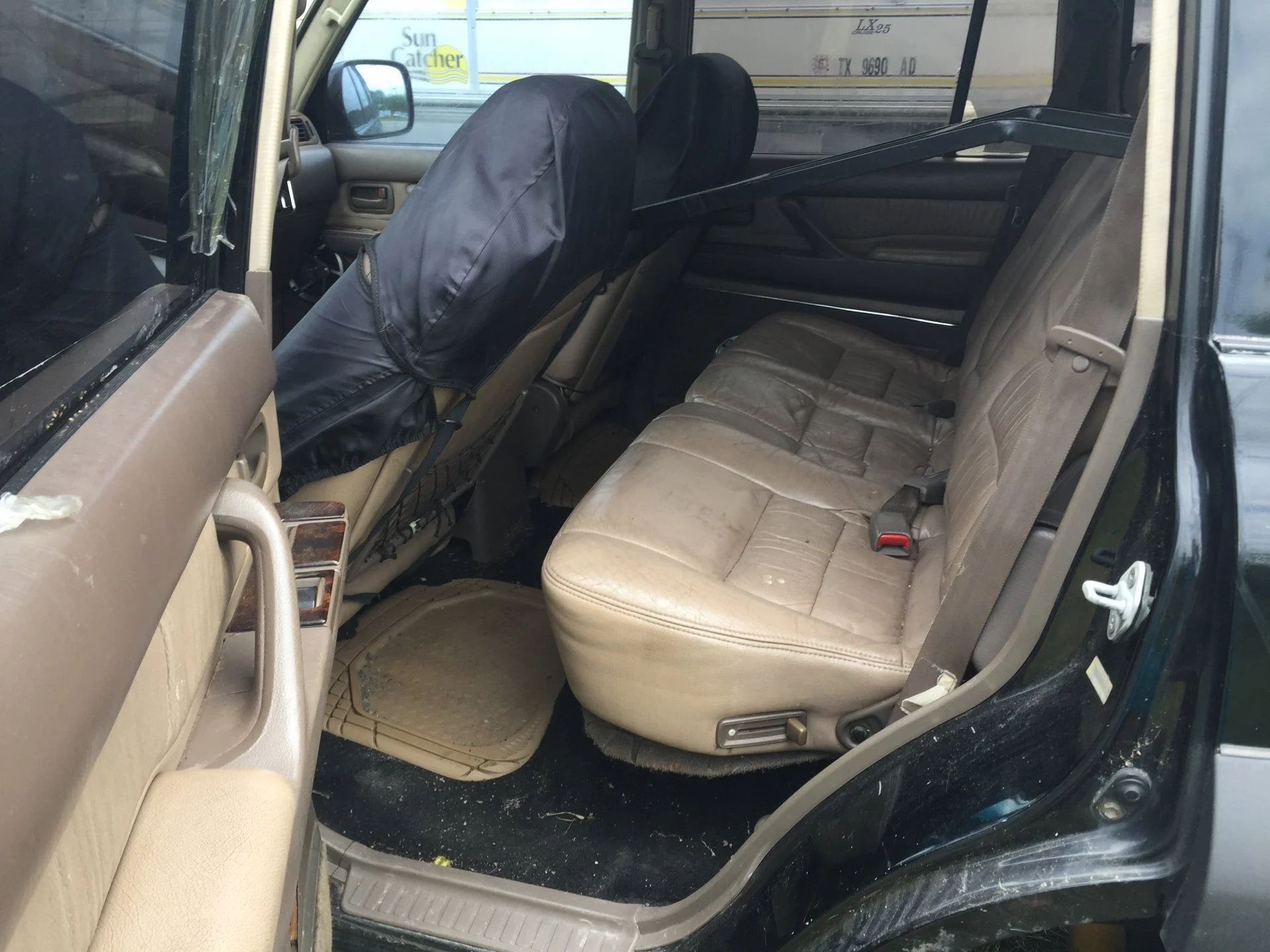

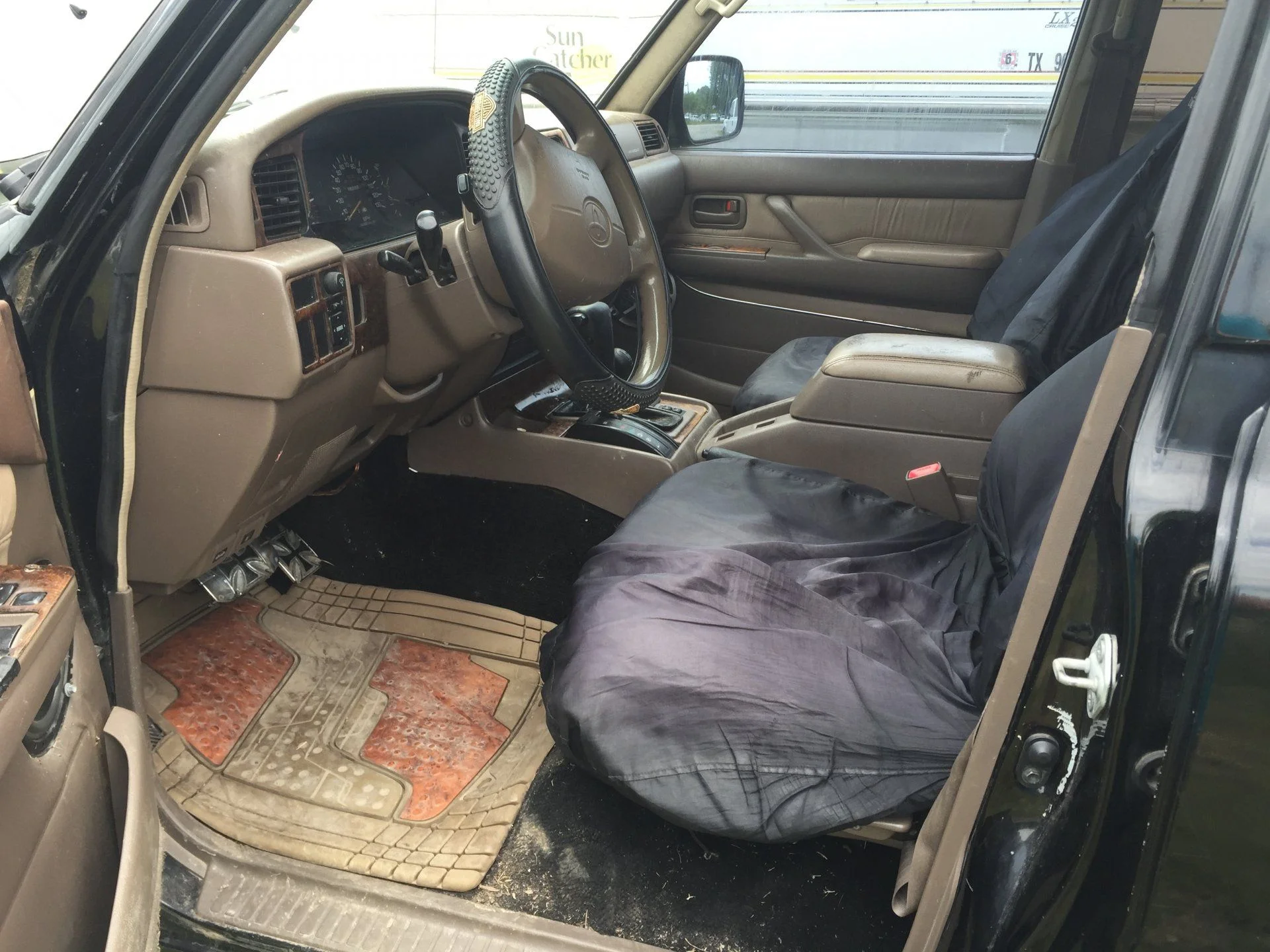

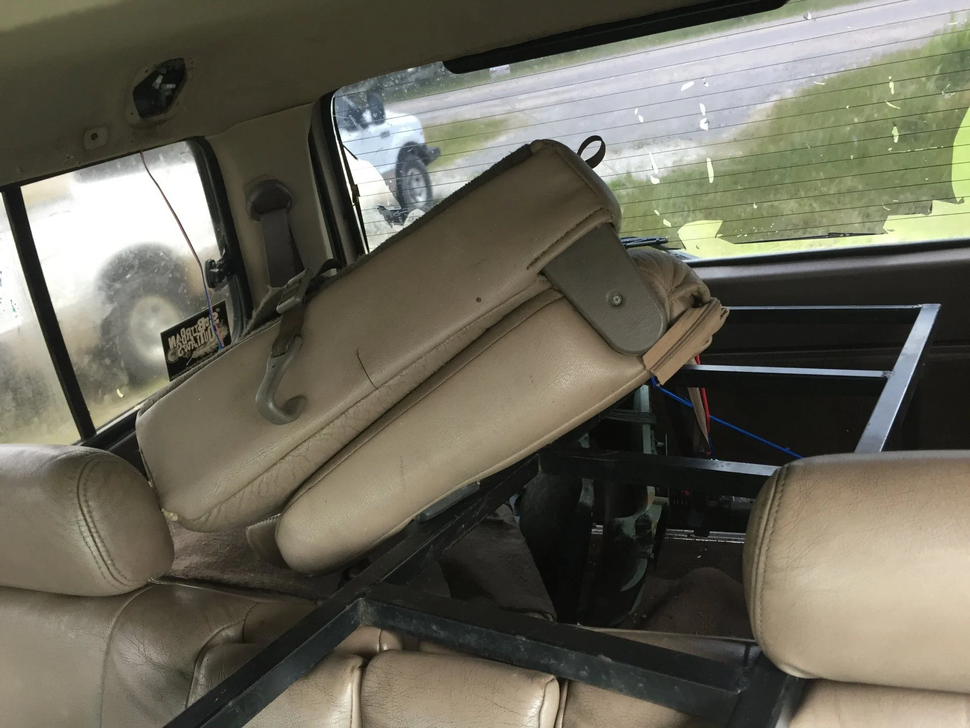

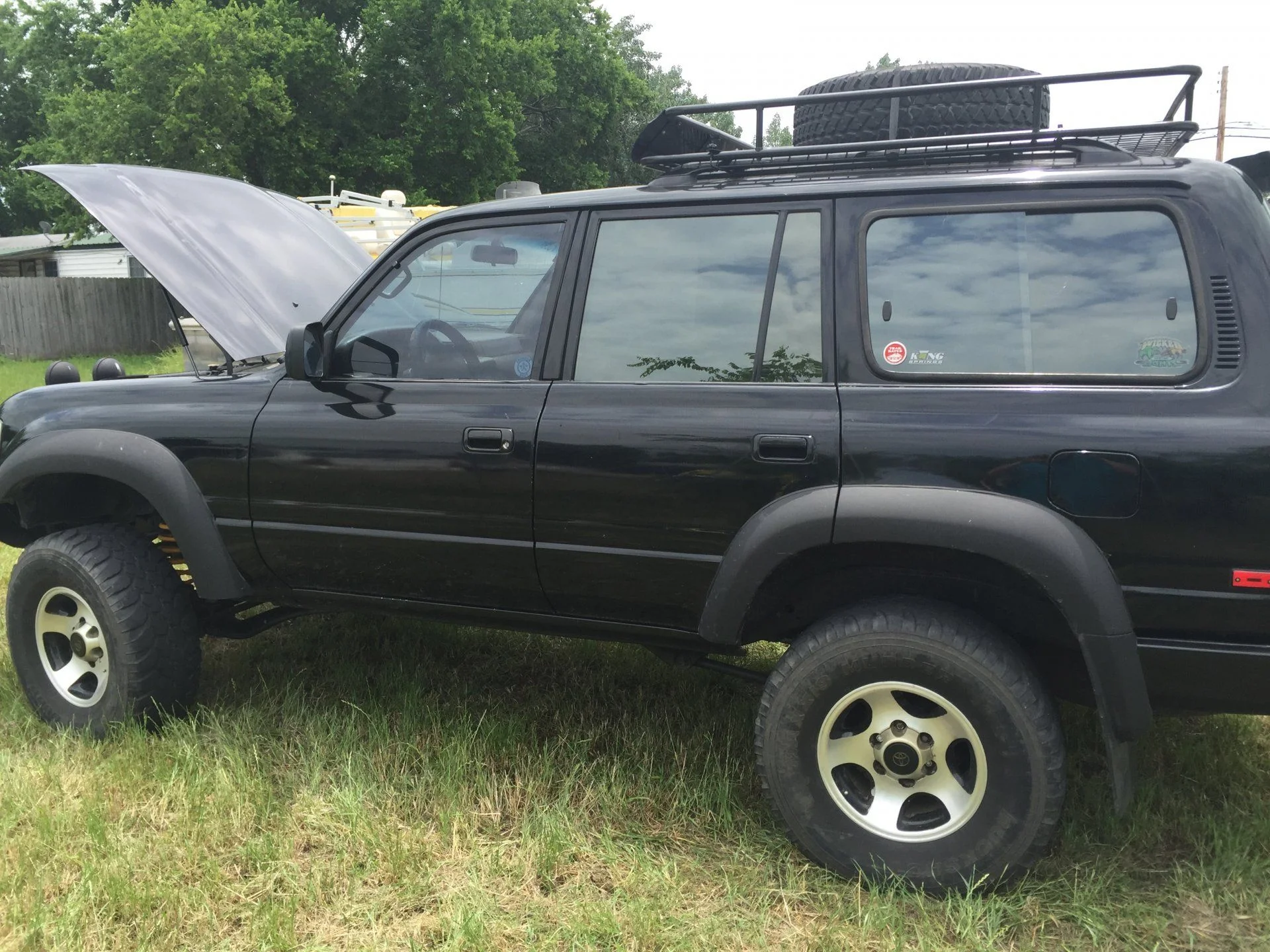

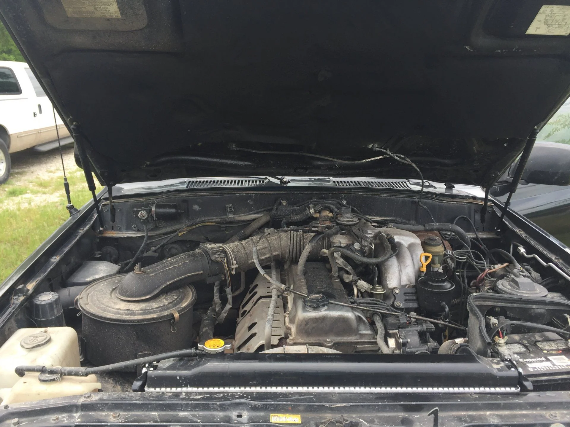

Hello all,
My name is Luke from Texas. New to the forum, new owner of 1996 FJ80, and new to the world of the 4x4. Bought a 96 TLC yesterday and am looking for info on upgrades/checks needed to be done once a rookie acquires one of these things. This will be a daily driver in town and hopefully weekend runs to New Mexico and Big Bend on occasion for camping. Will prob be 80-90 percent on pavement.
I already know that the AC needs to be charged (supposedly all of the AC system was replaced but not charged) and there is an odd glitch in the instrument panel that likes to go on and off. Funny enough, giving the steering wheel a good hit turns everything back on. I also know that the line from where you put gas in it to the gas tank has a small hole in it so that will need replacing. It doesn't leak any gas once it hits about 3/4 of a tank. A fact left out of the info given to me before I bought it. I about came unglued at the gas station as gasoline was pouring out of my new car. Besides that the thing needs to be cleaned like a hairy man coming off the long, hot dusty trail. Picked this up for $4300 including tax, title, and registration. Would love any thoughts/info you could send my way. Looking forward to being a part of the TLC community.
Nice ride! '96 is a great year. Looks like somebody already removed the side steps for you, that's good. It's got a lift... yellow springs... perhaps ironman.

To the list of fluid flushes I would add power steering fluid and brakes. Again, note the condition of the brake fluid especially; really dark, burnt fluid is indicative of neglect, and you could be in for rebuilding (or replacing) the calipers due to crud buildup in the cylinders. While you're at it, check the brake rotors/pads to see their condition.
Degrease the underbody really well and check for leaks. Same for the engine compartment, but be careful with electrical components and connections.
Grease all your u-joints, and check your steering knuckles for grease character and level (you'd be amazed how many people will drive a truck for 10 to 20 years without ever greasing anything).
