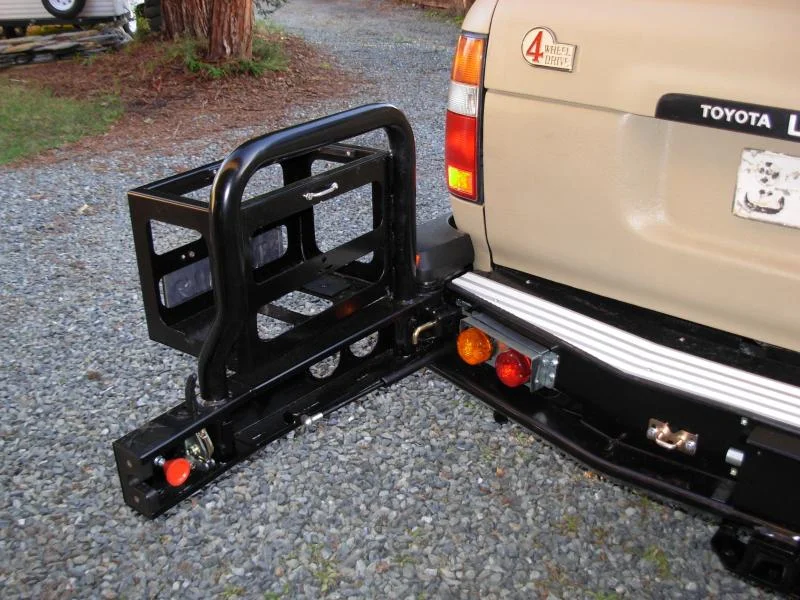

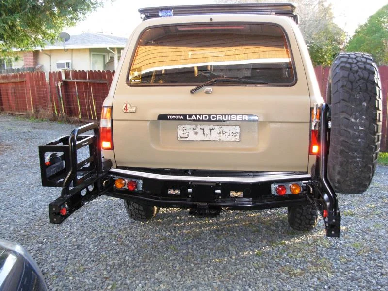

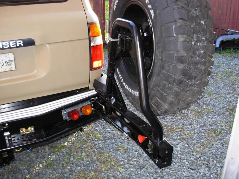

Got pics of that ARB rear bumper with the swings deployed?
Here's the bumper opened up:

Total cost of rear bumper with both tire and jerry can swing outs was approx $2500. I bought mine from Redeem at Teton Adventure Gear : Teton Adventure Gear HQ - Home.

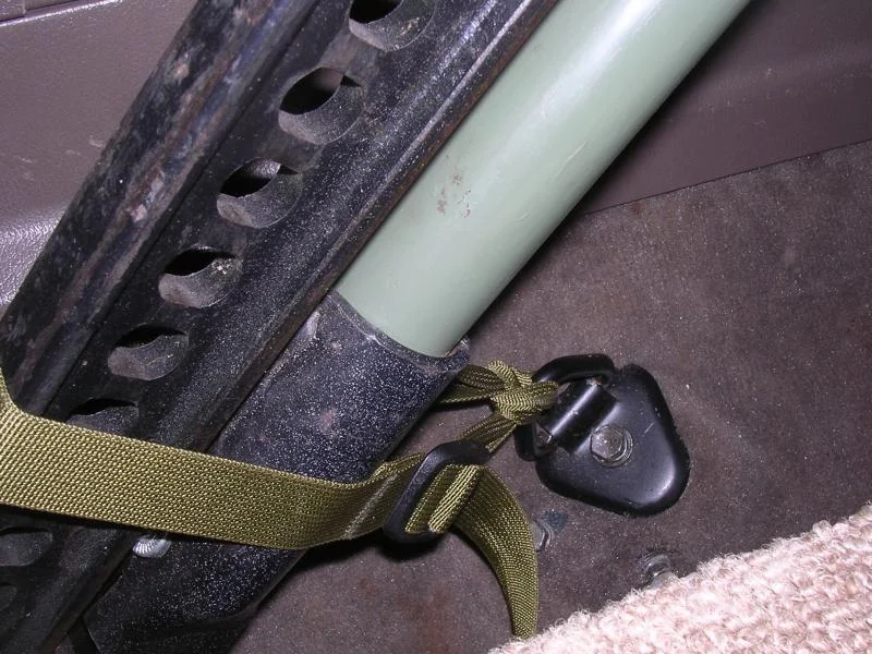

shermantank55....do you have a picture of the lower Hi-Lift mount you fabed up? If so I would really like a closer look!
Thanks.
Great Rig!
Thanks. Didn't fab much for the bottom. All I did on the bottom of the jack to secure it to the floor was to mount some tie-downs using the third seat bolts and ran the strap through one of them. Hope that helps.

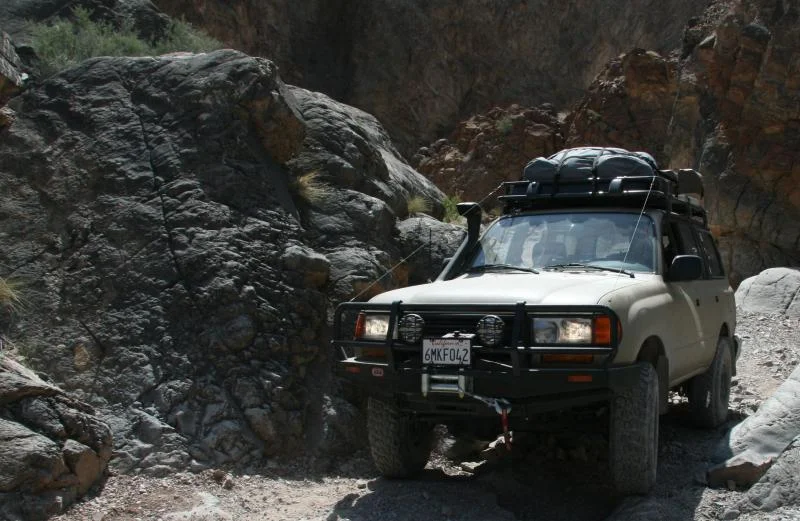

Just got back from Dingo's first off road adventure-6 days from Lake Tahoe, CA to Death Valley and back. Tried to stay off pavement as much as possible. Dingo performed flawlessly.
More pix to follow. Even got Alex behind the wheel.
