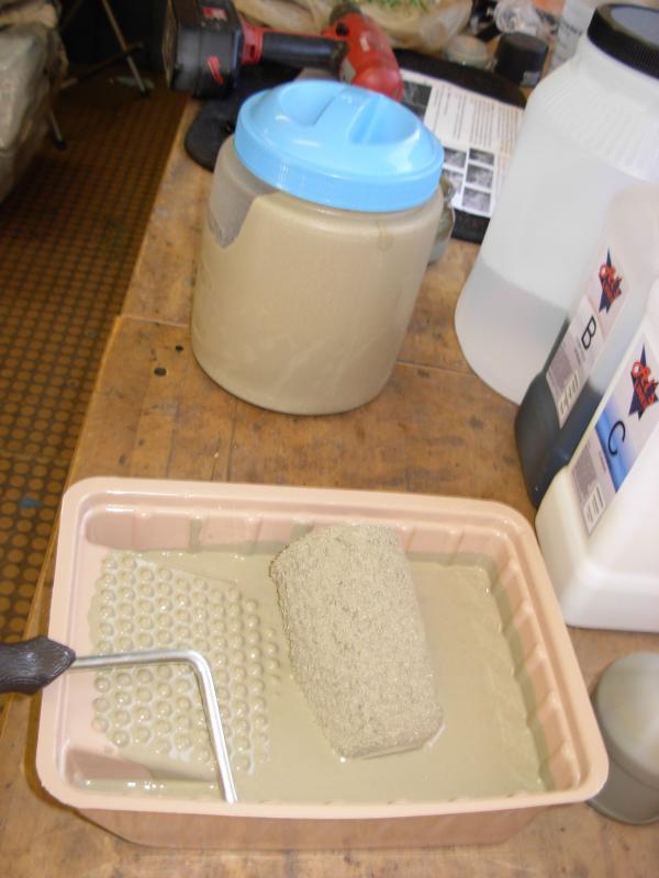

how far does a gallon of the stuff go?....when rolling/brushing.
I used 2 1/2 gallons for two coats on Dingo. Some of that was waste when the material started kicking off before I could use it.

Did you give any thought to ordering the spray gun that Al´s offers? I think this has sold me on bedlining my entire truck. Just wondering if the spray gun would save material.
I did think about it, but decided to roll it. I painted our FJ-40 with a HVLP but decided the texture would be better by rolling. Spraying would definitely go faster and may save material. See Ardentyota's thread: https://forum.ih8mud.com/80-series-tech/400405-lined-my-80-tan.html as he sprayed his cruiser with the tan Al's.
