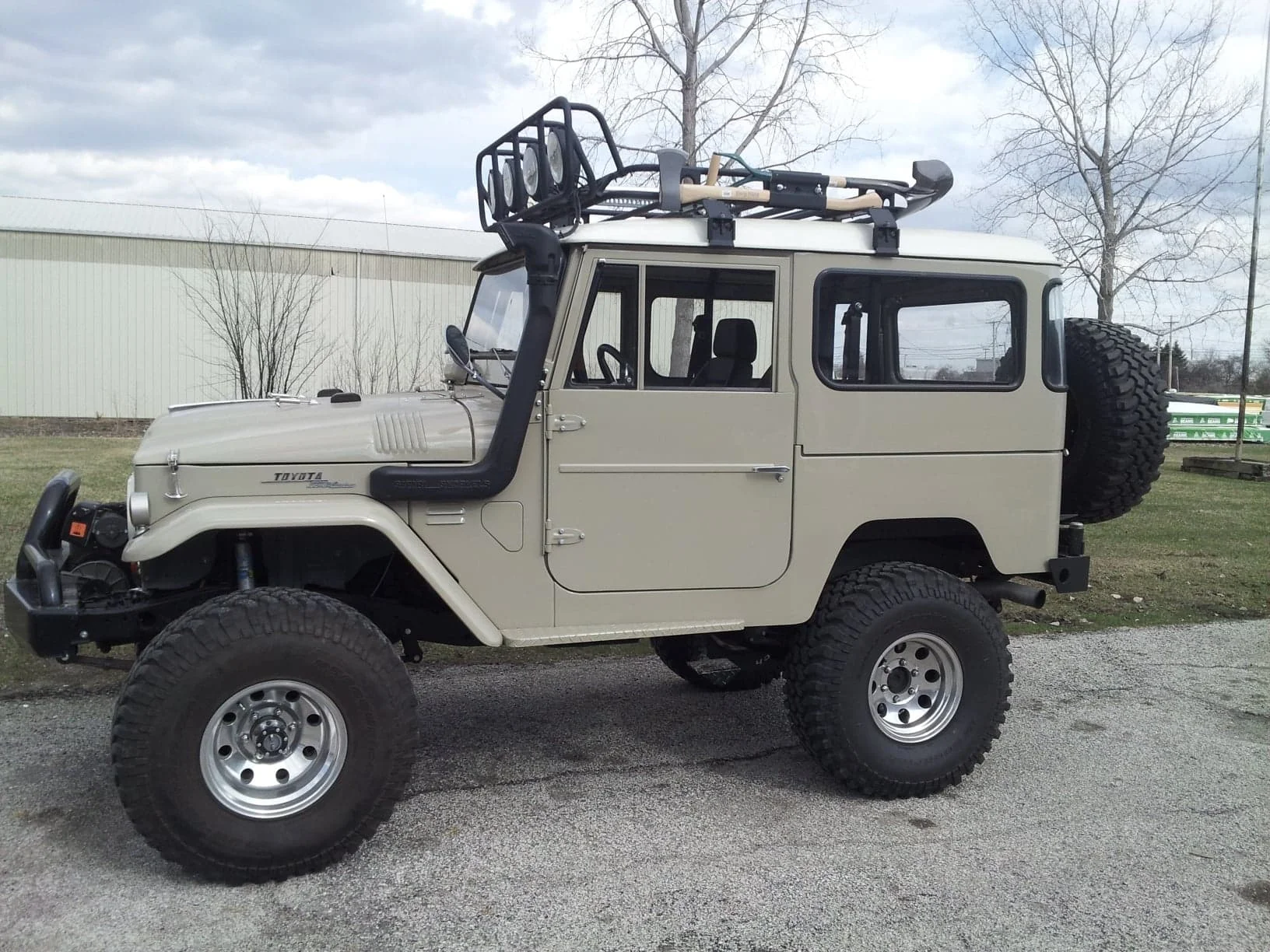

It's a Proffitts Stage 3 frame off restoration from a few years ago, back when they were still doing a lot of 4BT conversions. To make room for the Cummins, it is a SOA build. All the usual goodies, plus ARBs front and rear. H55 5 speed and split case. I'm not a huge fan of the roof rack or the current wheel/tire set up, but overall it looks like an interesting new project. Owner gets a jeep that he wants to match a CJ-2a and classic Power wagon project, and I finally get an FJ40. Not a 45, but close enough for a start.
Negotiated into the deal is a Cummins R2.8 repower motor still in the crate. And a broken frame and rotted body BJ40 with decent axles, running motor and good trans/t-case
I've been digging around here for a couple of years, but now have dug in fairly deeply on what I can find about these SOA and 4BT swaps. Seems to be a mixed bag of opinions as always, but they tend toward "it's a farm implement, too loud, too many vibrations you'll hate it" for the Cummins. For the SOA, also a mixed bag. Done properly, which I assume this is, seem to be pretty easy to live with. Just TALL. I do wheel, so the capability is desirable. Will I wheel this particular rig enough to justify a SOA set up vs an OME 2.5 and 33s? doubtful.
3 ways this can go, and I am undecided which is really the best. Opinions welcome.
1. Drive it as it is, accept the compromises of the Cummins and SOA, have a very capable wheeling rig. "Don't fix what isn't broken". This is easy, and is at least how things will start. Unfortunately, it doesn't fit into my garage at home so it may be offsite and some distance from me for now. Not ideal.
2. Plan to put the R2.8 repower into the truck, and do a SUA reversion. Sell the 4BT. I've already spoken with Proffitts about this, and they are the easy answer. I put feelers out to Valley Hybrids and Torfab, but have not heard back from them. My brother and I could do it, not strangers to engine swaps, labor and time vs money. As the H55 and adapter is already there, the re-engineering is somewhat less than usual on a repower. More money and time, but it will be a perfect FJ40 at that point.
3. What I really want is an FJ45LPB. It doesn't really need to be a true frame off like this Stage 3 Proffitts, I'd rather have a clean driver. Do I sell the FJ40 as it sits and find a 45? Maybe easier said than done. If I'm going through the repower and SUA expense and work involved, do it on the truck I want the most. That said, I do really like a FJ40, and the heavy lifting is done on the one I have. This is the most expensive option in all likely reality.
So, those are the options. There isn't really a true perfect answer, I'm just putting out there as my thoughts right up front. We'll see. If there is a unicorn out there who happens to want a 4BT/SOA restored FJ40 and by some miracle has an FJ45 and wants to talk trade, by all means hit me up. Otherwise, time will tell.
From a technical standpoint, I have found many great threads on the R2.8 conversion. A ton of very helpful pics, tips, parts, etc. I won't reinvent the wheel here as I don't have any unanswered specific questions yet.
Less clear is the SOA to SUA conversion. I can't find much about that direction. I assume this had a proper cut and turn. As I am getting the BJ40 with the project, it will have axle housings/full axles I could rehab and use. Some questions I do have:
1. Is there any reason the BJ axles wouldn't work? Will the 3rds, axle shafts, etc work with that housing or do I need to rebuild what is there? How much of PITA would it be to cut and turn the axles back to stock? Any reason this couldn't be done?
2. Are the spring perches modified for an SOA? I haven't found a thread indicating yes, but I can't seem to confirm no. Bottom line, will new springs drop in?
3. Assuming I drop an OME 2.5 kit in, with appropriate axles either re-cut and turn or new, what else will I need to change? Steering components? Knuckles?

Sweet looking truck, on teh current market I would serioulsy consider trying to sell it as is and building what you want. There are a few 45's kicking around as start points.
The Bj40 diffs should work, being a 66 I doubt it has the factory diffs in it still .
You can cut and turn them back but I wouldn't bother as you will also need to do shock mounts, leaf mounts etc. Just use the BJ's if you want SUA.
Spring Perches are moved from bottom to top but often they leave the stock ones in place as well.
Get a picture of what steering you have now and I can tell you if it will work
As you pointed out Proffits are doing a lot of different things now to then as are most shops. I would not pull the 4BT to put in the R2.8 if you really want a 45, there are still a lot of people who love the 4BT and a 4BT SOA Built 40 that has a resto at that level will be a salable item. Heck if I had a 45 I would swap you as I am to tall and fat to fit in a 45 lol
Thanks Yo. I'll get pics up once I get this thing in my hands. I realize I should have asked are spring hangers moved, not perches. I'd hate to cut anything off a powder coated frame if I didn't have to.
For now, it will be a fun toy to play with and I can keep researching. Good times. Fairly deep down the patina resto rabbit hole at the moment. Maybe wngrog will decide in a moment of weakness that he is over his 45, or the 40, and wants a full resto with the 4BT/SOA. Or there is some other unmolested prize out there just waiting in the wings. Fevered dreams.
The picture you did post shows it has a SR ( Shackle Reversal ) which is always a can of worms opinion wise and I would expect it it was setup as a SOA with SR you will need to do some changes as the non SOA Springs will need more Arch and thus lengths and geometry can change.
If you have always wanted a 45, I would say sell this. You will Probabaly always in the back of your head want one. Market is high on 40s and a restored 40 with a 4BT will sell quite well on bring a trailer.
