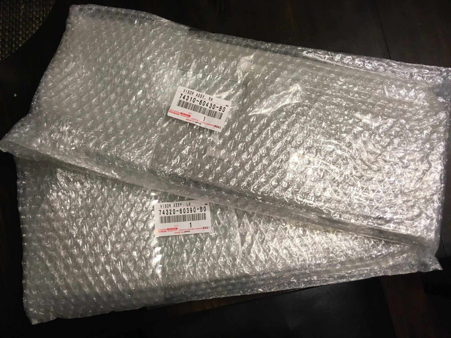

I was told that LEXUS RX330/350/400h would fit and I scored new OEM and they are close but do not fit. I think a thread similar to seats etc. wouldnt be the worst idea For those trying to refresh the interior.

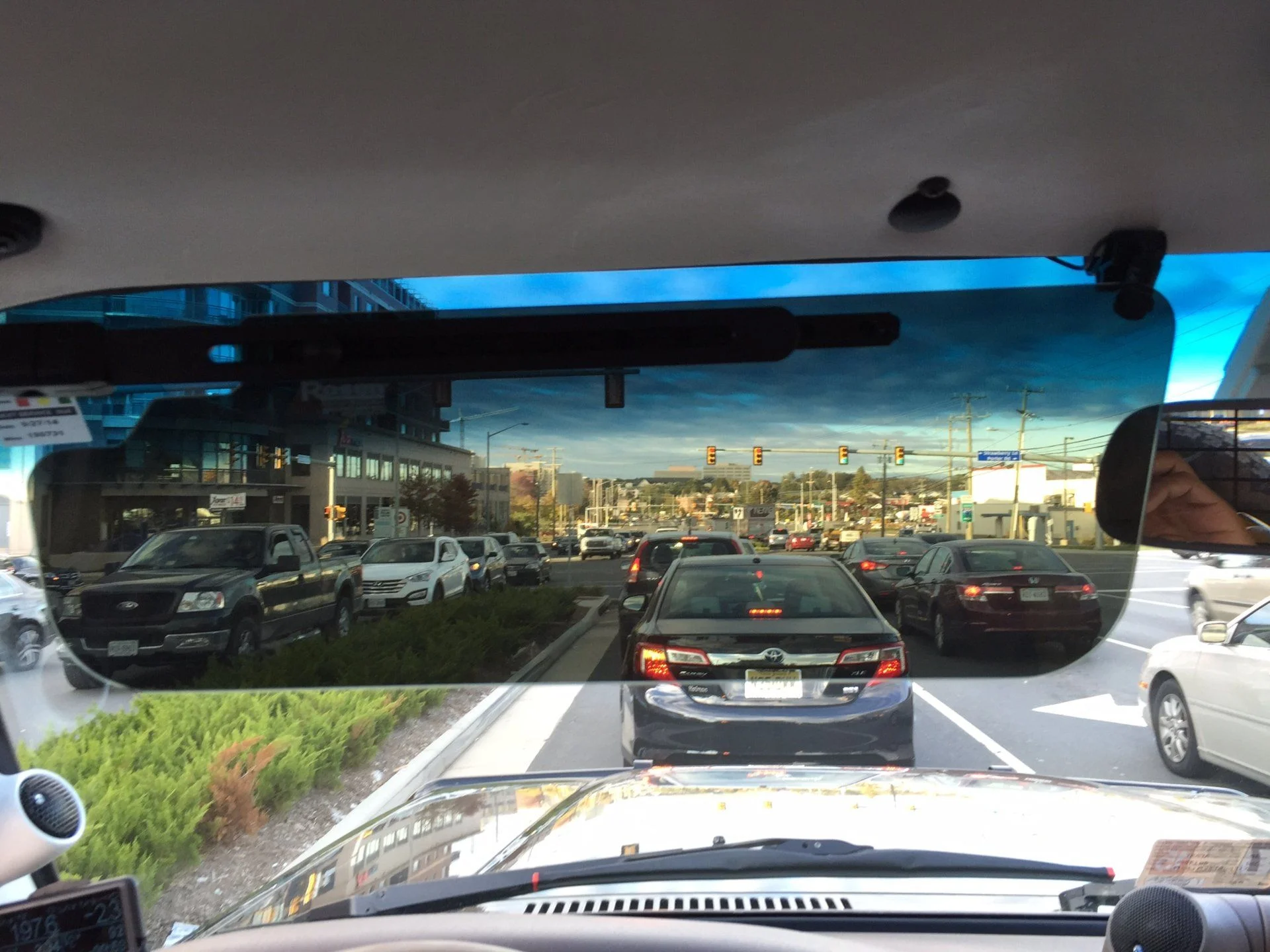

If I had Joey’s wife’s money I’d do the fancy airplane visors like he did. Maybe @NLXTACY can post up some pics. :rofl:
Just get the non-US 80 series plain jane visors from cruiserparts.net. I purchased both sides and I am extremely happy.
Get new clips too.

well they are almost a go, just a tad too short. thanks for the info.
Too short how? The LS400 visors slide out on the hinge rod and then the clip lines up with the stock 80 clip position just fine. I've had my LS400 visors in for a year now and they work and look great. They get used almost daily.

ithink they are too short to do there job, ya know how the oem visor goes up over these dont. I may still use them
I got new OEM gray ones from Japan recently. They don't have the little ears above the rear view mirror, but I needed them that way.

Aircraft are cool, but I like to block out the sun! Isn’t it crazy that the visors are wimpy on this awesome truck?
