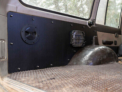

I found these on eBay, its affordable compared to the other options.
I really want a drop in set of panels. Either HDPE or Aluminum. I looked at the Aussie door cards but they shipping kills it.
The eBay seller is on mud.
I just messaged him. I'll see what is possible. Ive not had cargo panels on the truck for a while and its getting irritating.
