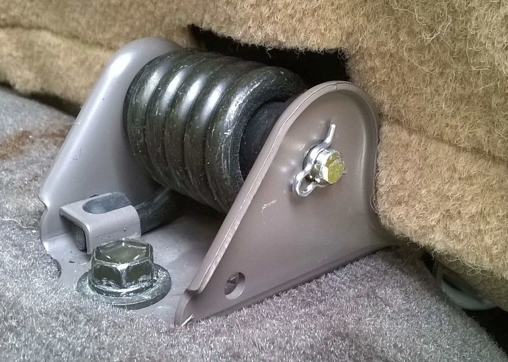

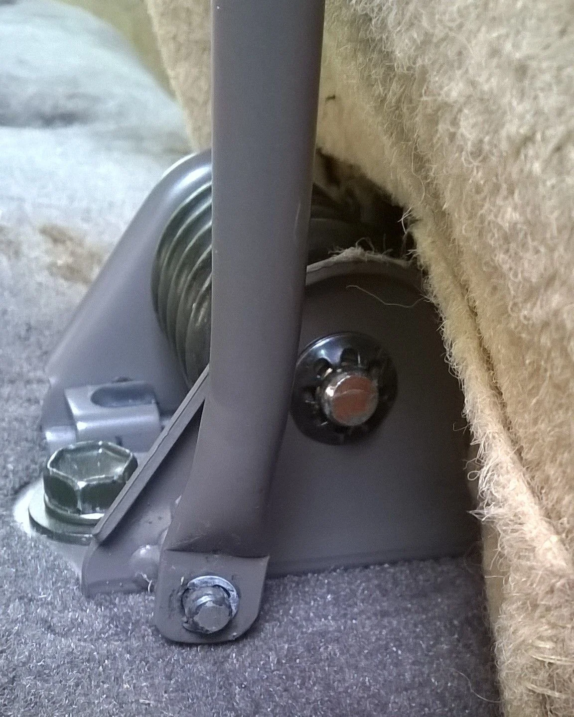

first, I trashed 3 of the 4 star thingamajigs that hold the rear seat pins in place, the originals look like this:
I checked at NAPA and they didn't have anything like that, and I don't have time to hunt them down at Toyota. Here's my workaround solution, is this legit? They're on there plenty tight, and there shouldn't be much back-and-forth movement at all. $.73 for all 4 at Lowes.

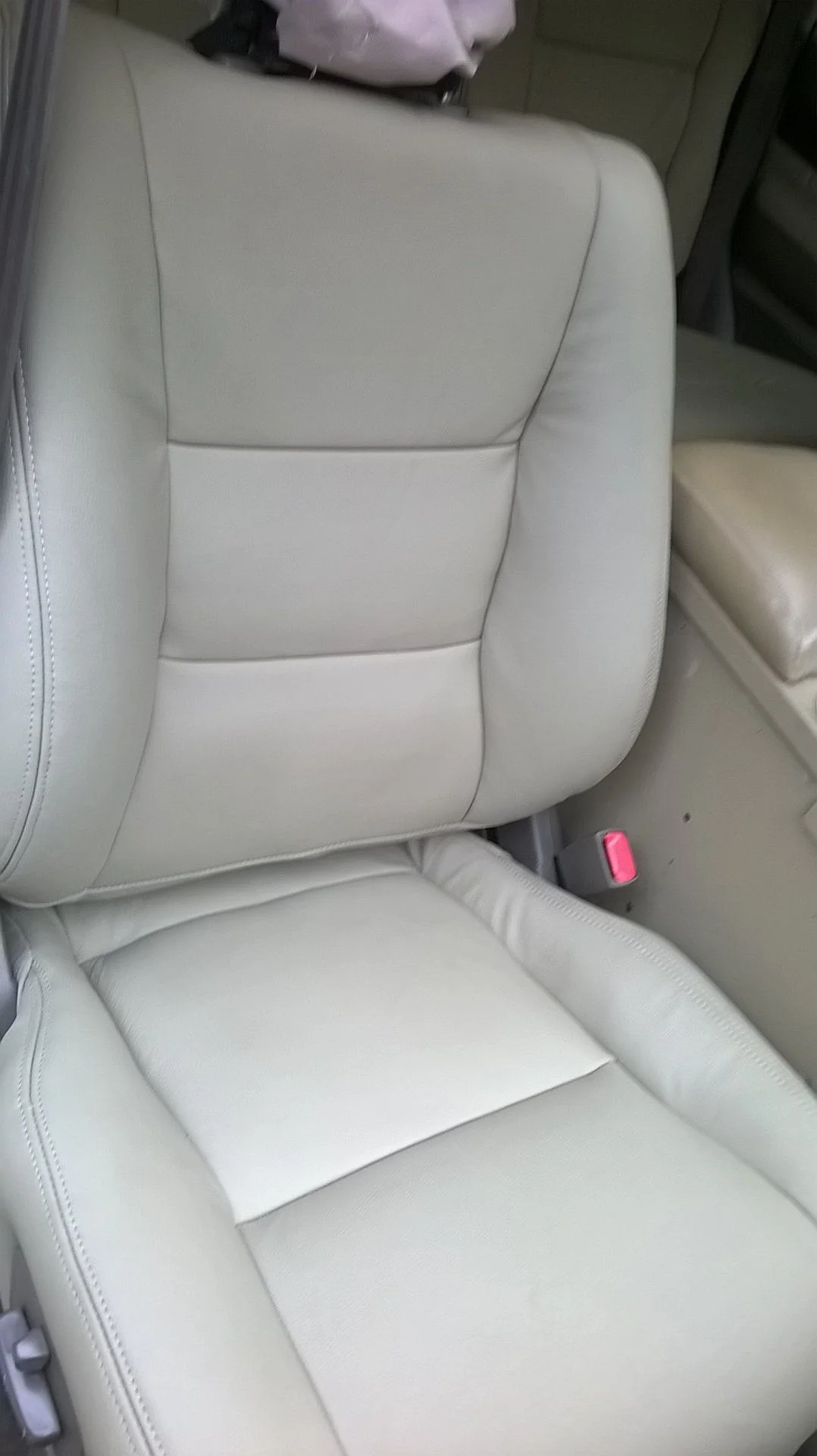

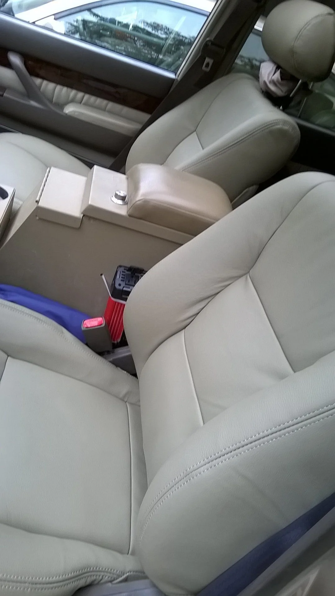

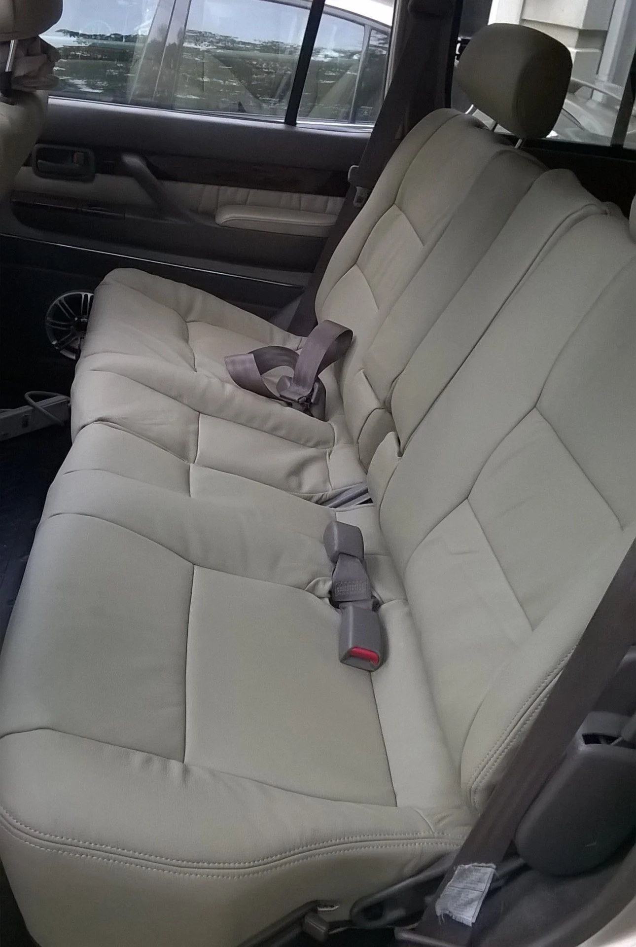

ok, here are the seat pics.

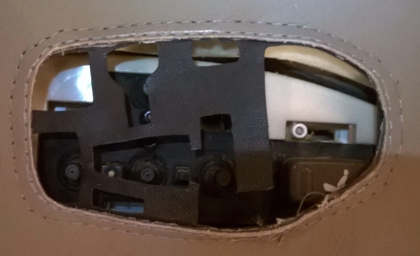

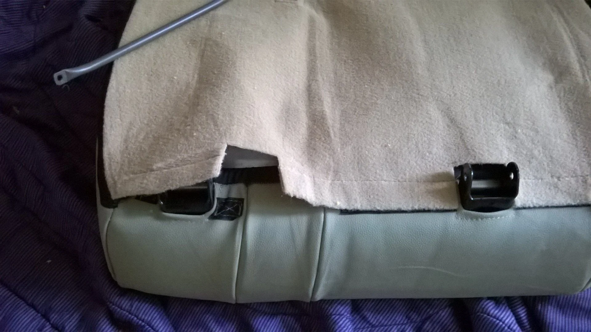

While I'm happy overall with the installation, lseat did make a mistake on one of the rear seat bottoms, which they did correct, and the replacement also had a related error, which I just worked around. The issue was the spacing between the openings for the seat brackets, the right and left seats are different widths (they're like 2 1/2" different IIRC), the first time, the opening was wrong (it was the same width as the other rear seat), which totally wouldn't work, and then the replacement had the cutout for the bracket correct, but the cutout for the cloth cover in the wrong place, here's what that looked like.
to fix it, I just cut out the rectangle where the bracket is located, and sewed it into the gap you see above. no biggie to fix, but the lack of attention to detail is sort of frustrating.

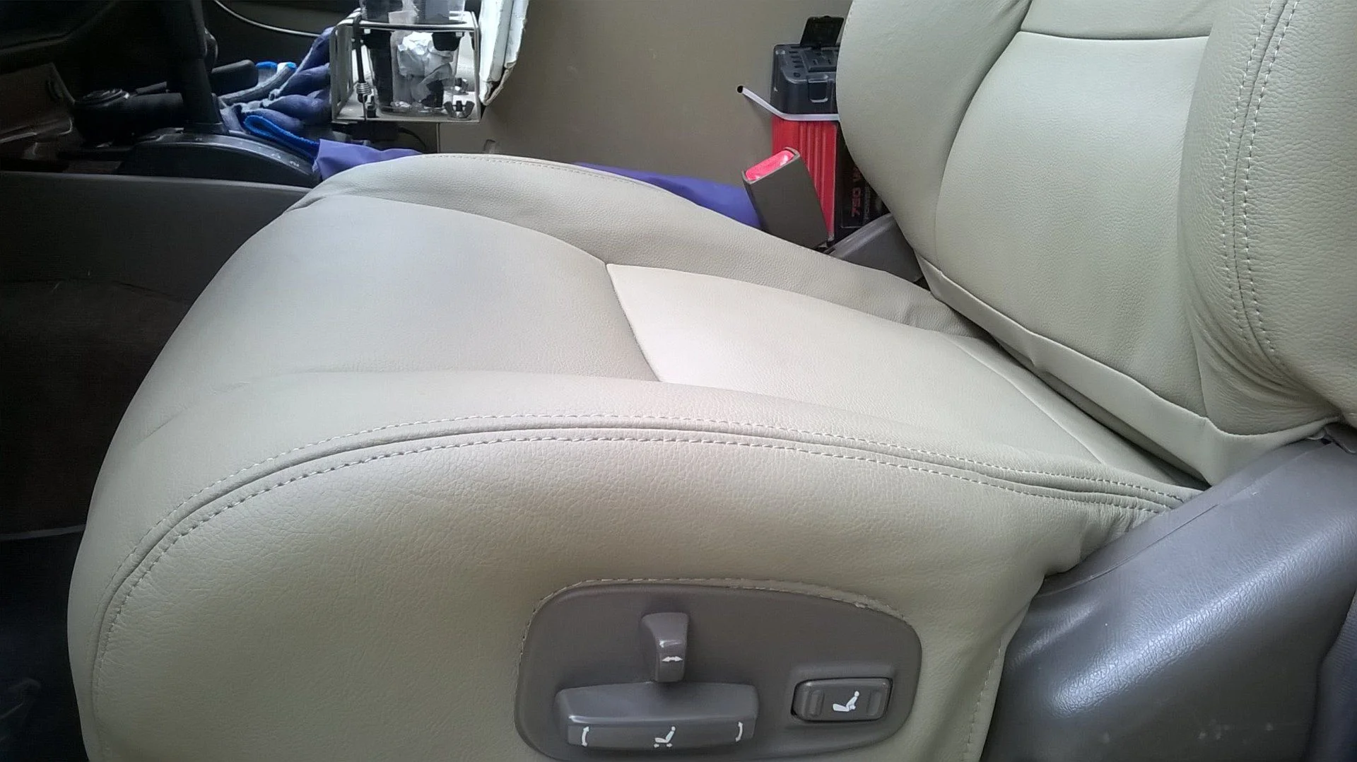

Also, the cutouts for both of the seat adjustment controls for the front seats seemed to be a bit high. I did replace the bottom foam in both front seats, so maybe that contributed to them seeming high, but I also managed to break both of the plastic inserts trying to pull the covers down to the correct position.

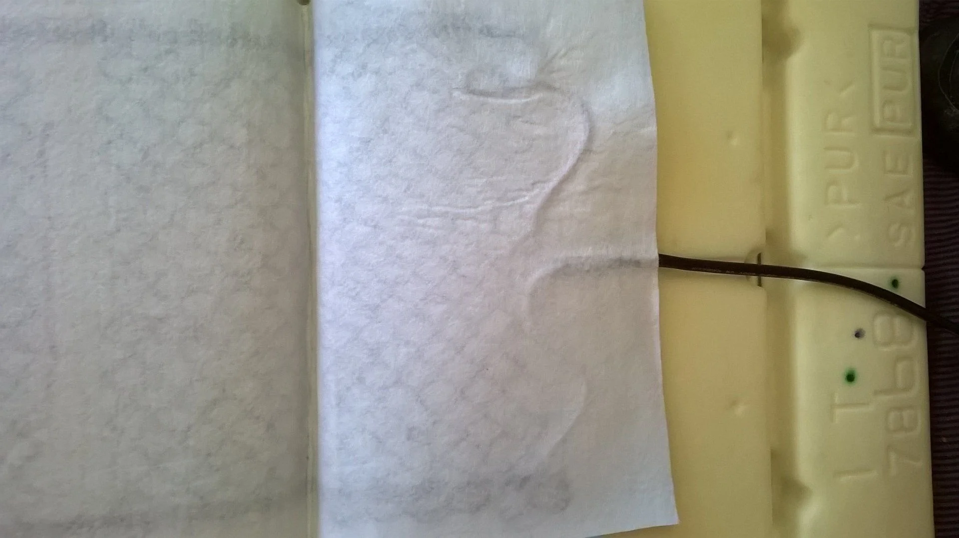

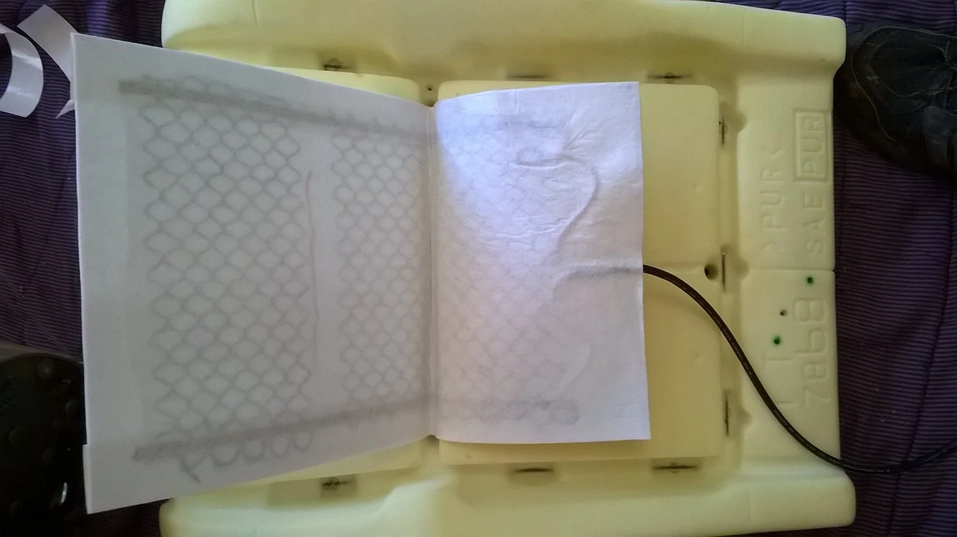

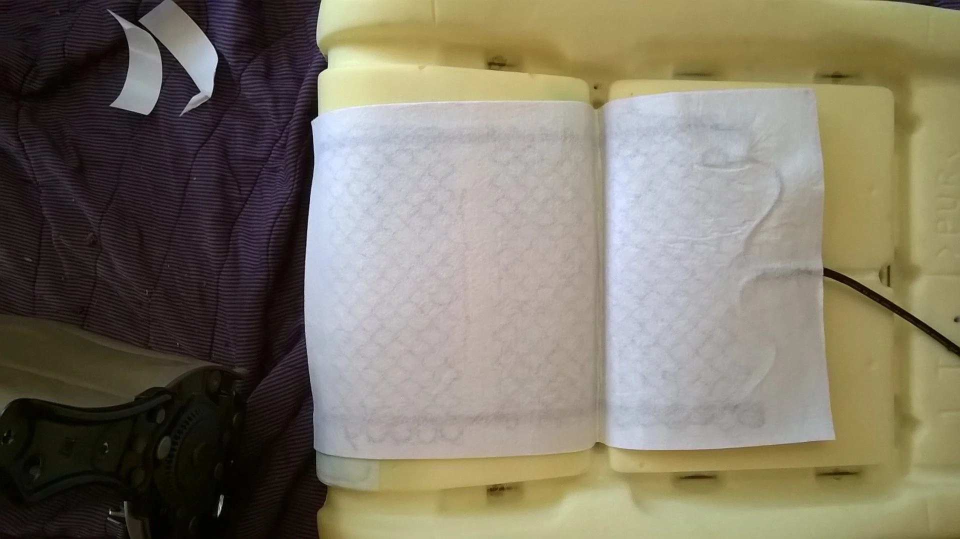

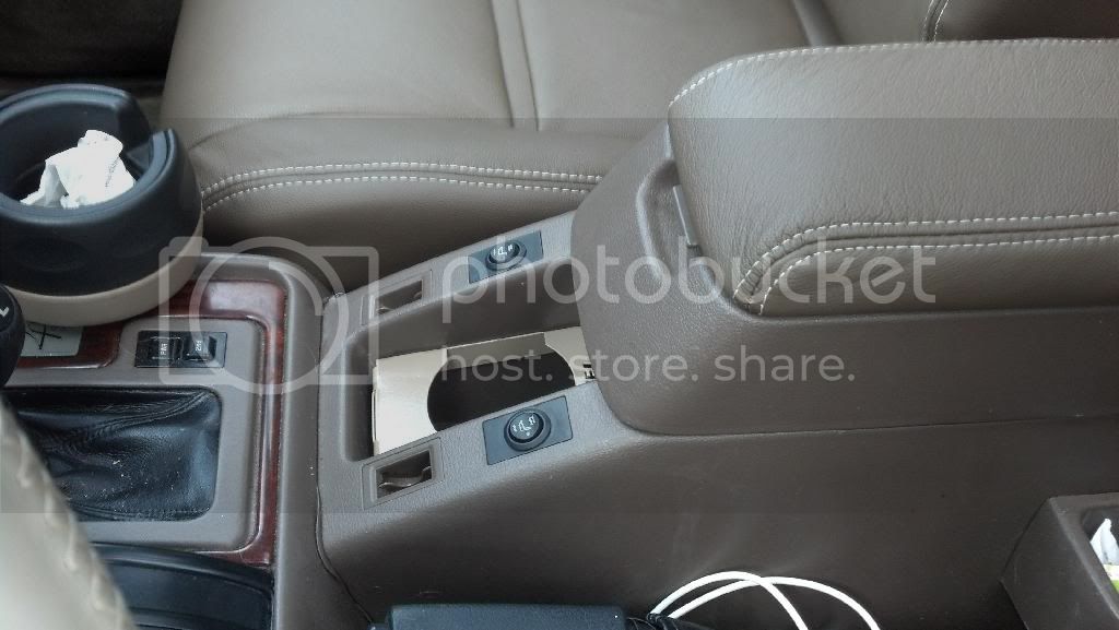

I also added the carbon fiber seat heaters from Amazon. The only very minor issue with that was the switches appeared to need a 3/4" hole, but it was slightly bigger, which was quickly remedied with a little Dremel love.

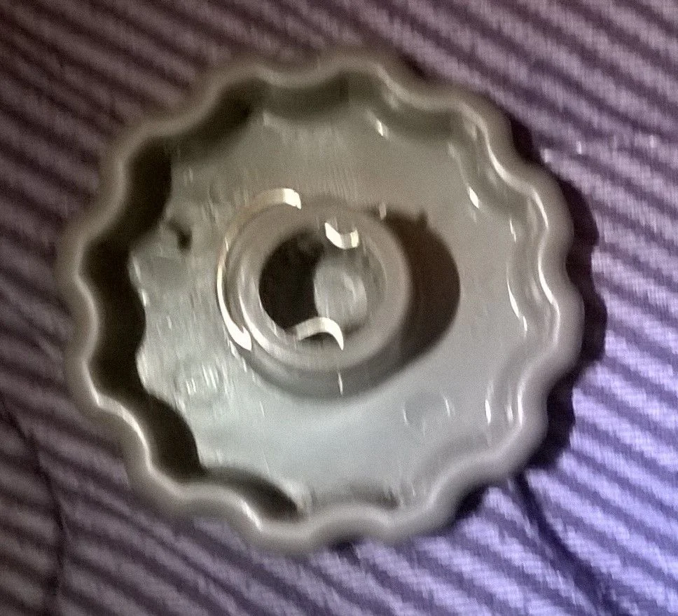

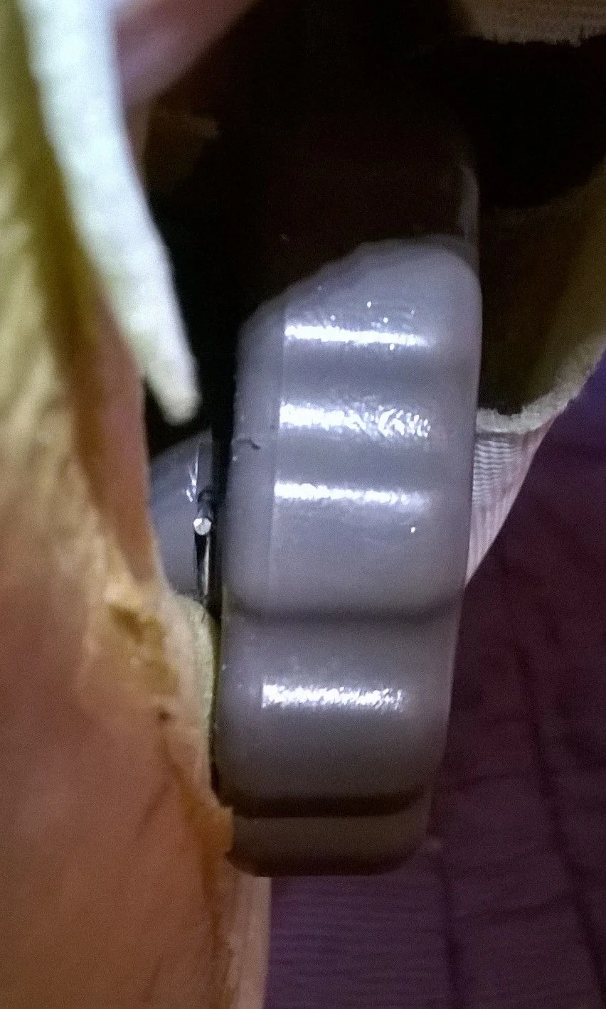

one more thing-some of the other threads talked about the lumbar knob clip but I don't recall finding a good pic, here are a couple (sorry for the blurry one!)

Thanks for the pictures. Given the price, I would say the hassle factor about matches. Good work on what looks like a tough install.

Seat Heater Switches

Re the switch blanks, I think I just was unlucky with the one that broke. I was a bit more careful, but these went in without a hitch.
