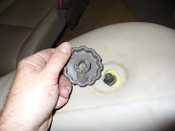

the best way to deal with this
attachment.php
Is to take a piece of cloth that is bunched together so it's in the shape of a tube and while holding each end guide it behind the knob and once there rock it back and forth. The idea is for the cloth to catch one side of the clip on the up movement and flick it off.
Putting the knob back on is easier since it just snaps on.
Hope this is understandable.

Anyway, this is the tool used to remove those type of clips on that knob. It is available at any local parts store and is generally an item that is in stock.
This tool is used for all of those pesky little plastic push clips behind the door/interior panels and saves many of clips from being broken. This tool is usually stocked as well.
Having dealt with these clips countless times on classic cars and the like and used every possible method of removing them I much prefer the tool.
Regardless of either of our preferences, that is what the tool is made for and I thought it might be a good idea to inform folks there is a tool made for the purpose.
To each his own. ;)

The problem with the tool is that it is metal and can mar the material behind the knob. Now when replacing the leather this isn't much of a problem but if you need to go back in there afterwards maybe you don't want to take the chance.
Since you've used every possible method what was it about using a rag that gave you an issue?

As has my father, my uncles and my grandfather. Through our combined experiences and schooling I think I am plenty qualified to have an opinion on this most trivial issue. An issue that for some reason you have taken offense to. Is it because I dont prefer your method?
If you take some medical tape and tape the edges of the tool this is a non issue.
Because I have found that the tool when properly used, with care, is much faster than fiddling around with it.
I prefer my method, you prefer yours. As I said, to each his own. The tool is shown above for those who would like to use it, and for those that don't that's up to them.
My ONLY intention was to inform people that may not know there is a tool available for around 4 or 5 bucks that is designed to remove those clips.
attachment.php
Now what exactly is the problem???
