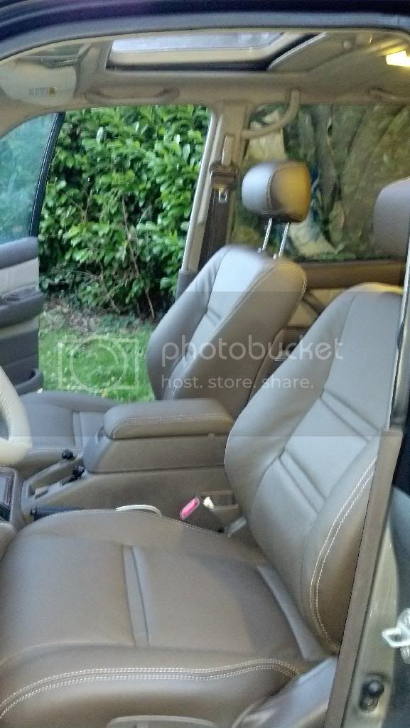

I've had the seats out all week, and finally got them finished up today. Decided to just go with the switches that came with the heated seat kit--seats are heating up great. I've managed to completely destroy 2 switch blanks in my attempt to mount them in the coin holder slots though. I really wasn't expecting that to be a problem!
Thanks again for all of the help in this and other threads. Definitely a tedious, pain-in-the-rear installation, but I can't even begin to describe how much better my truck looks inside now. You get to enjoy this upgrade ever time you open the door.
You can see in this pic how my switches are unattached at the center console. I'll try my luck at getting those secure tomorrow. Ran out of daylight today!
Looks great mtzorro. Going slow myself, but doing the armrests and center console as we speak. Any hints on the coin holder blanks/switches? How did you end up routing the wiring?
I'm not really a pro with the wiring, but following the instructions from some of the sites/videos i found on the element installs, i ordered a couple of fuse taps. It was pretty easy to run the power wiring under the carpet, pull the kick panel, then run it up into the fuse box for the tap. there's a pretty solid ground under the center console. i did have to extend the power wire on the passenger side to reach the fuse box. for mine (and i would assume others), the seat elements had to be connected before the switch would light up (and show that it was working). my elements pull up to 10amps, so i tapped the "gauge" fuse for one. i actually need to pick another for my other seat since AC only works when the AC is on, and STOP isn't switched. My next choice is ECU, but I'd welcome another suggestion.
I've got 2 more switch blanks, so i was going to try drilling into those again to mount the switches. i may have just goofed on the first one. it didn't break until i was actually putting it into the coin holder slot.
