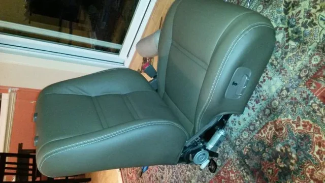

I've been working on installing my new leather seats...first I must say it's not as difficult as you might expect...and easier if you know a few tricks. I will also say that it's a time consuming job...I started on the second row and had about hours on the first one as I was trying to figure everything out and thoroughly clean everything before reassembly.
The second seat was done in about hours and that included stopping and going to Jo-Anne Fabrics to buy industrial thread and needle to sew the plastic rail back to the leather that tore off when I was trying to install it. The leather on the top front of the seat wraps over the back and two plastic clips have to come together...it's tight and difficult to do...I had a Snap-On hook tool that helped me tremendously, but it was still difficult...I actually broke a sweat doing this part and the first seat took me over an hour at this section of reinstallation (novice).
I believe the quality and fit of the leather is better than I expected and I have very high expectations...but being completely truthful there was one area that might need some attention in the construction of the seat covers...I don't think they're locking the threads when they stop stitching...when you're fitting some areas of the leather (the rear armrests for example) the threads start to come apart...I am going to have to take both armrests out and stitch them back a bit and tie the threads down. If I had known this I would have tied the threads down a before installing or added some stitches of my own. Trust me this is a very small detail and hardly worth noting, it might not even be common, but it was the only gripe so far that I would bother mentioning.

My seats now look pretty darned good. If your seats are beat, you should do this job.
