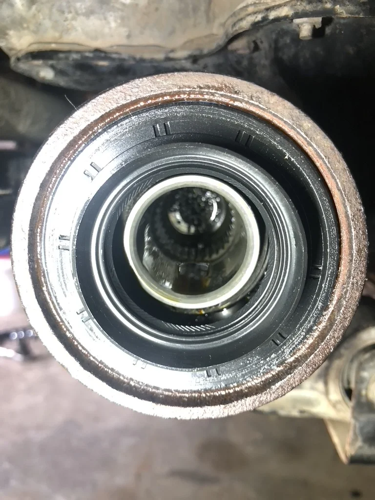

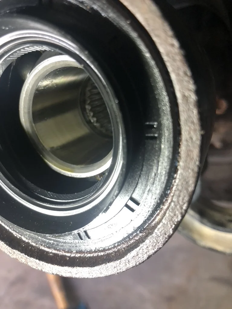

1) Seal getting knock out of place, is number. Happens most often, when steering knuckle not removed, seal not lubed or just careless. Remove FDS and inspect to seal see still seated properly. If not you have your answer.
2) Not seating FDS all the way in is number 2. Look as you see me do in video. The FDS silver (aluminum) dust seal, with be in diff.
3) Not seating seal squarely is number. Take clear picture an inspected. Also run your finger tip around seal and diff shelf.

Just nearly flush with the race-still just fractionally raised- optimal
Try not to push in even or below-
I see some use a light weight hammer and hammer all around the seal (outer perimeter). Toyota seals have a pretty tough metal casing (outer perimeter) and extremely hard to bend but if you accidentally hit the surface with lettering and part number, it can be pressed in and could open the lip a bit.
I use a heavy hammer and once the seal is even on all sides, place the old oil seal on the new seal and then a flat metal disk (such as a worn brake pad) and give a good tap with a heavy hammer...

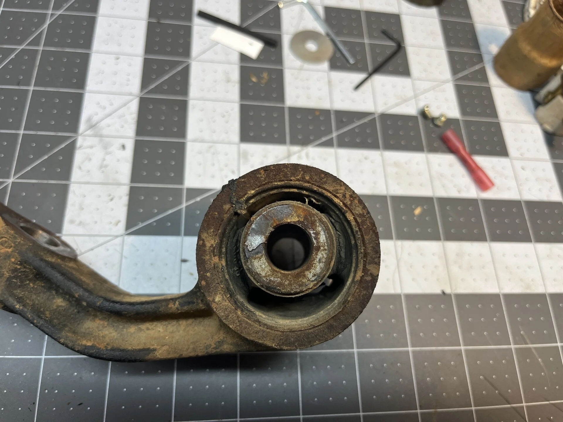

With 188k on the clock those diff mounts were pretty worn with lots of movement in them. I can’t swear that they were in fact causing the issue but since replaced no leak. I am pretty sure though that when ps and ds side blew diff oil all over at the same time it was a clogged breather. Also by replacing those my “clunk” is gone.
Were you able to move the diff mounts at all when under the truck, it was it only while driving you were able to notice symptoms? My rig has 278k on the clock, so it's something I need to look at more closely. I've been under the rig a lot and the bushings passed the visual test, but that doesn't mean they aren't an issue or contributing to my issue. The only seal I'm having issues with is the PS. I've got a brand new breather and it's working fine.
Yes, I could physically move the axle tube and watch it move way more than it should have been able to. Once I removed the mount you could see the deformation of the bushing and was way off center.
