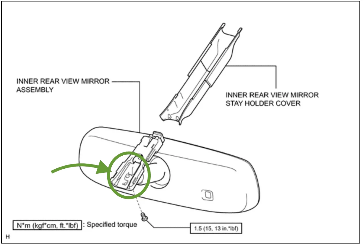

Thinking the clip that’s flush with the glass is pretty generic to mirror posts. Not sure. The arrow points to what I mean:
Thinking the clip that’s flush with the glass is pretty generic to mirror posts. The arrow points to what I mean:
Could be for newer vehicles. Older ones vary. BMWs up to late 90s for sure. They use some wacky round looking tri-clamp. But those Germans march to their own beat.

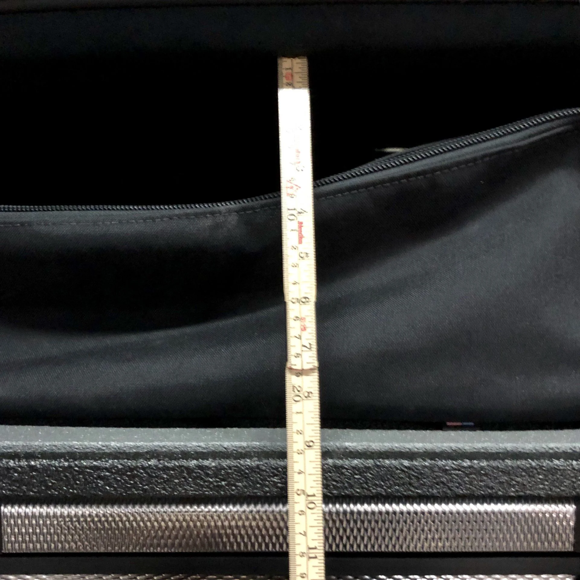

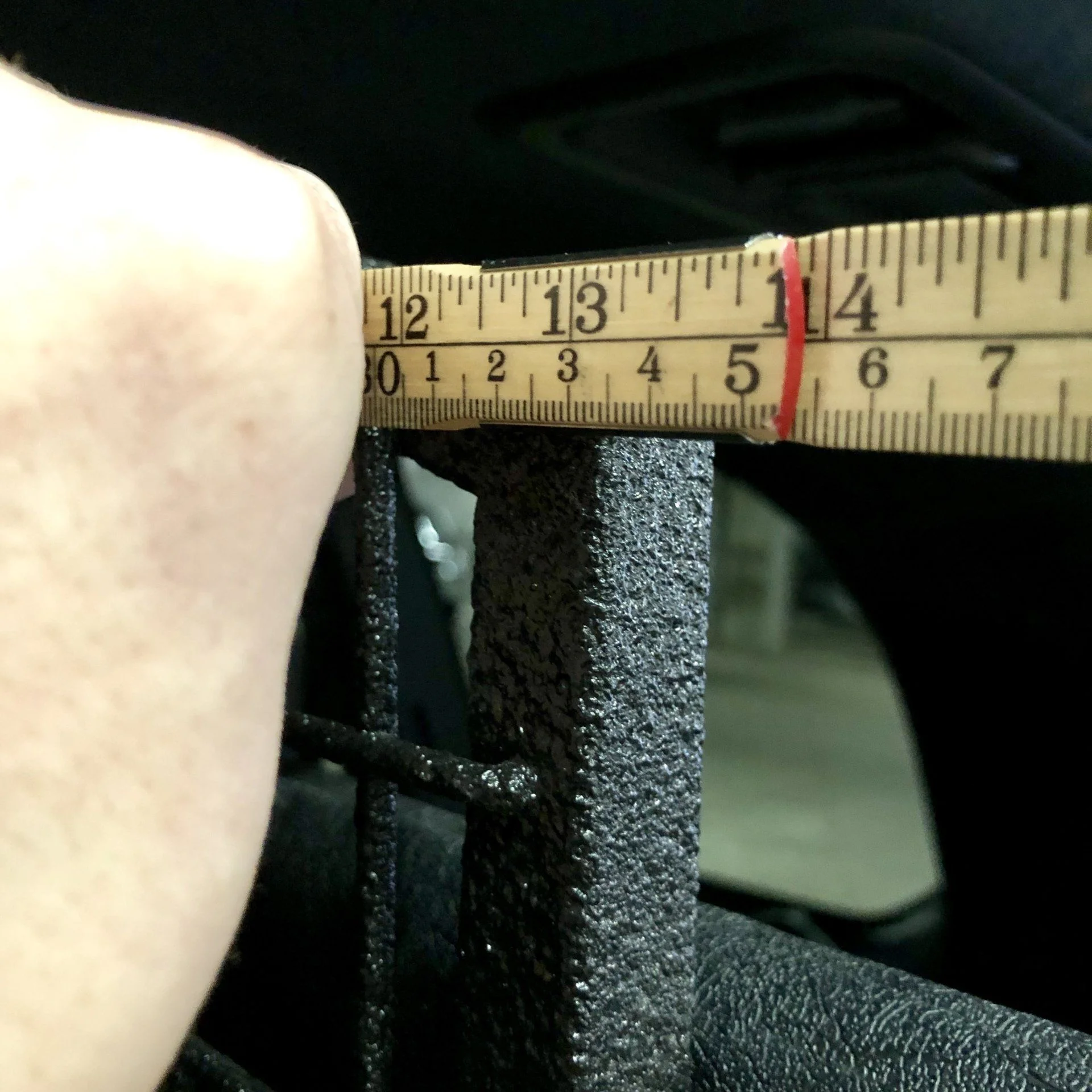

Hey Cole,
How much vertical clearance do you have on the shelf above the fridge? I have the same NL fridge and will be installing a Trekboxx setup (on order). For now, I'm thinking of running a Goal Zero Yeti 1000 to power the fridge (until I'm able to spring for a dual battery setup), and would like to squeeze it into that space directly above the fridge, if possible. Also, the battery weighs ~42lbs...do you think the shelf would accommodate that (maybe a question for Dave)?
Thanks!

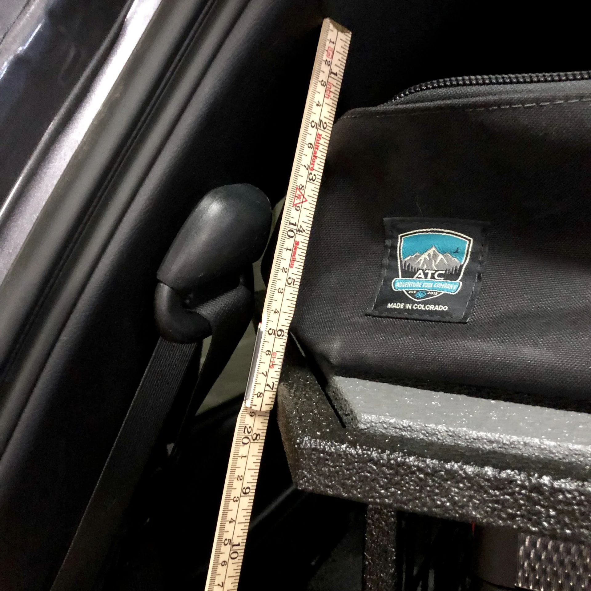

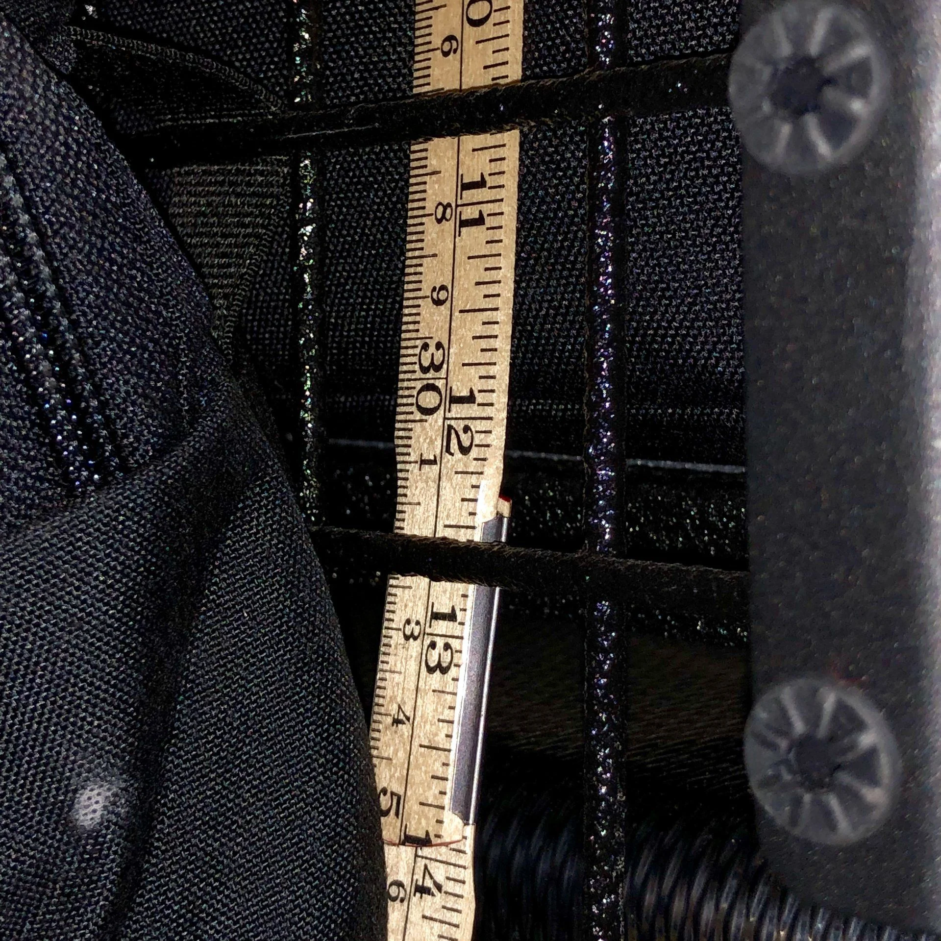

Sorry, I'd almost forgotten about this. Regarding clearance for items stored on the shelf, take a look at the contour of the roof line in the cargo area. There's more "head room" on the interior though the space slopes toward the rear and sides of the vehicle. The lines of the Trekboxx cargo system take this into account so you can roughly use the cargo barrier as a guideline though it also leaves a bit of clearance between itself and the headliner.
The ruler is slanted a bit in the photos so I'd reduce the measurement a bit. The rear-most section of the shelf has about 8.75 inches between the headliner and the shelf. That's with the 60L NL fridge... the 60L ARB fridge has much more room since it's a bit wider (and maybe longer). The forward part of the shelf has a little over 12 inches of clearance between the shelf and the headliner. The headliner slope is gradual as it's about 13 inches from the rear of the shelf to the point where you get full access to the 12 inches of height. You'll also notice that the contour on the side of the reduces the height to about 7 inches.
The Yeti 1000 would fit, technically, but it'd be difficult to access / remove as you'd need to install it first then mount the shelf. If I may, I'd consider putting 2 of the Lithium 400s up there if that would work for your needs? They'd fit and they're just 16lb each.
Here are some photos to help...
View attachment 1872750 View attachment 1872751 View attachment 1872752 View attachment 1872753
I appreciate the detailed photos! I also have the 60L NL fridge, and already purchased the Yeti 1000. You're right, it'd be a very tight squeeze, if even possible (and practical for that matter).
David W. also suggested the possibility of squeezing the battery in behind the fridge onto the slide itself, which would be great if we can make it work (in terms of the available space). I'm going to look into this as well. Thanks again for your help!
I bet that would work. You may have to get creative with mounting the fridge but if anyone can figure it out Dave can.

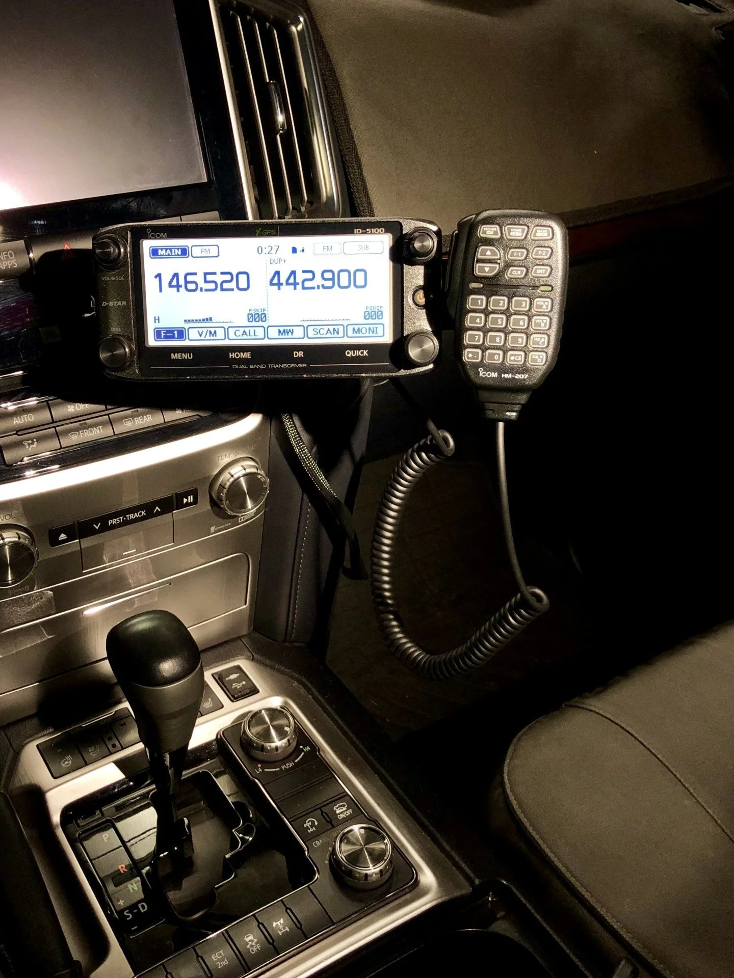

The Icom 5100A is hooked up. It's definitely a high quality radio though a bit more complex than the old Yaesu. Time to spend some time with the manual. The one surprise with this unit is that the mic plugs in directly to the radio itself instead of the faceplate. This made wiring the extensions a bit more complicated and messy than I'd like. The mic also use RJ45 cable so the connector and cable is on the bulky side... I'm looking into trying to find right angle connectors and making my own cables to clean it up a bit.
