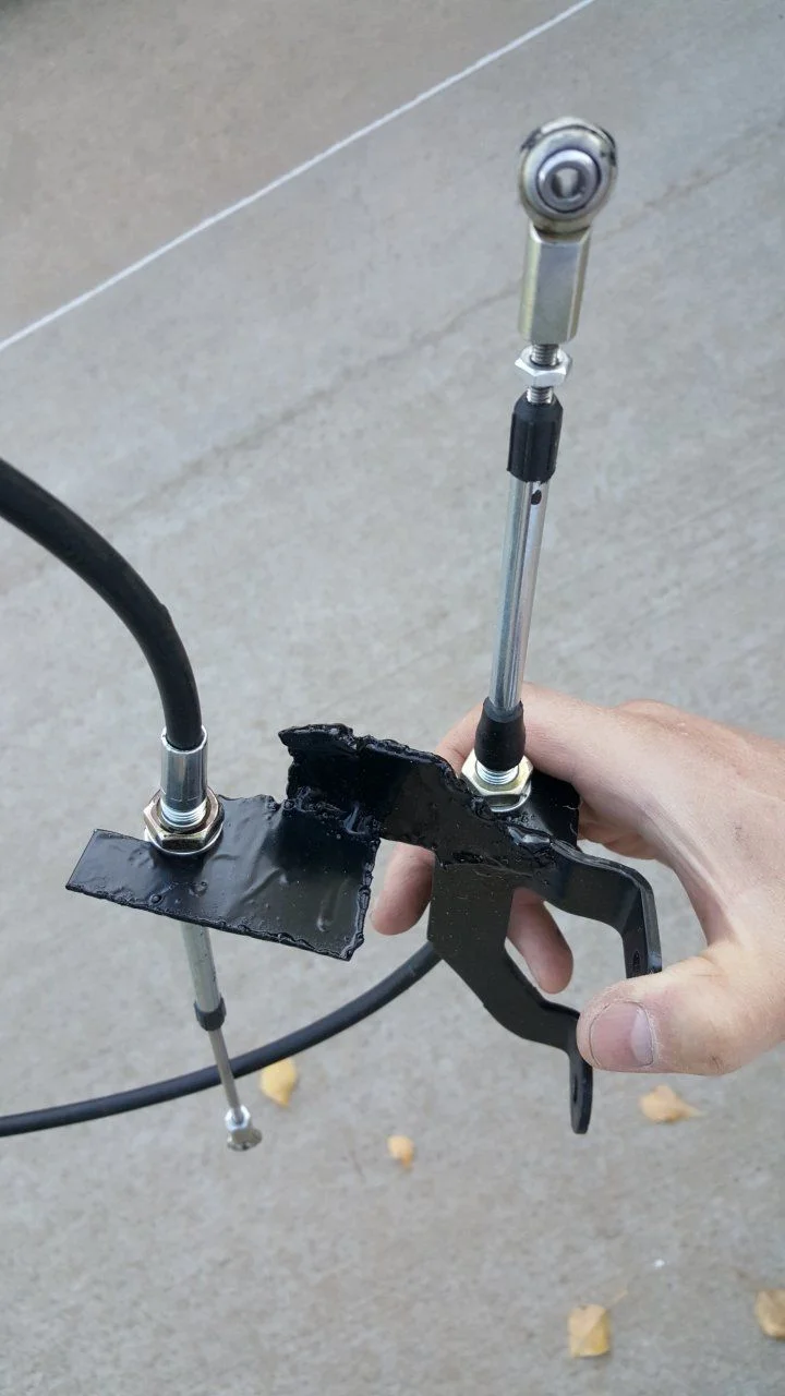

Finally got my linkage to work. A little janky , but it us going thru the gears nice. A little off going into low, but with the Dakota digital sensor, I'm not too worried about getting it spot on.

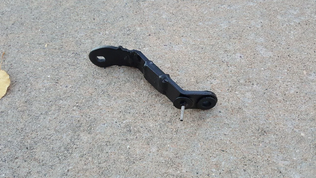

Totally done with the transmission shifting. I hooked up the DD GSS-2000 (sending unit and "brain box") and DGS-3 indicator. Unfortunately, the sending unit is designed to bolt to the transmission without the stock tranny gear indicator thing, so the DD sending unit won't fit without that. You also can't send the GM signals to the DD "Brain box." So, I mounted it upside down (outside of the truck) and screwed it to the body by the shifter (console). I had to modify the arm and bit and I made a rod, but everything is going through the gears as it should.

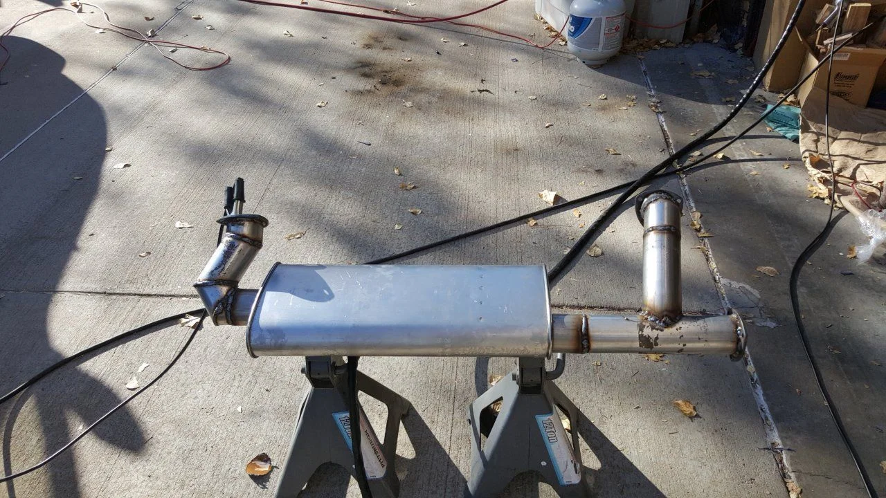

Got the passenger side exhaust done. I had to weld on another 2" off of each header bc I was short when I initially did it.
Passenger side is a little wonky between tcase and frame. I did some janky "lobster back" work to get up and over the damper and to follow the angle of the rail. Not sure if other people have had to do this before?
More exhaust janky-Ness.

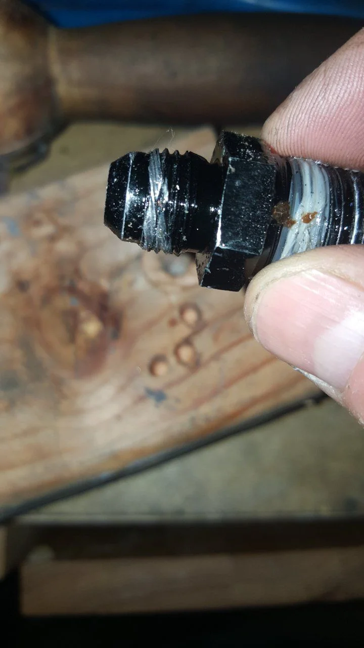

Dealing with leaks in the power steering system. Must of had a spark hit a line when I was tacking up the exhaust, because there was a burnt hole in the line. Spliced that up and then I didn't get the fitting tight enough. 2 qts power steering fluid on the driveway. I'll just have to repour the slab when I'm done....

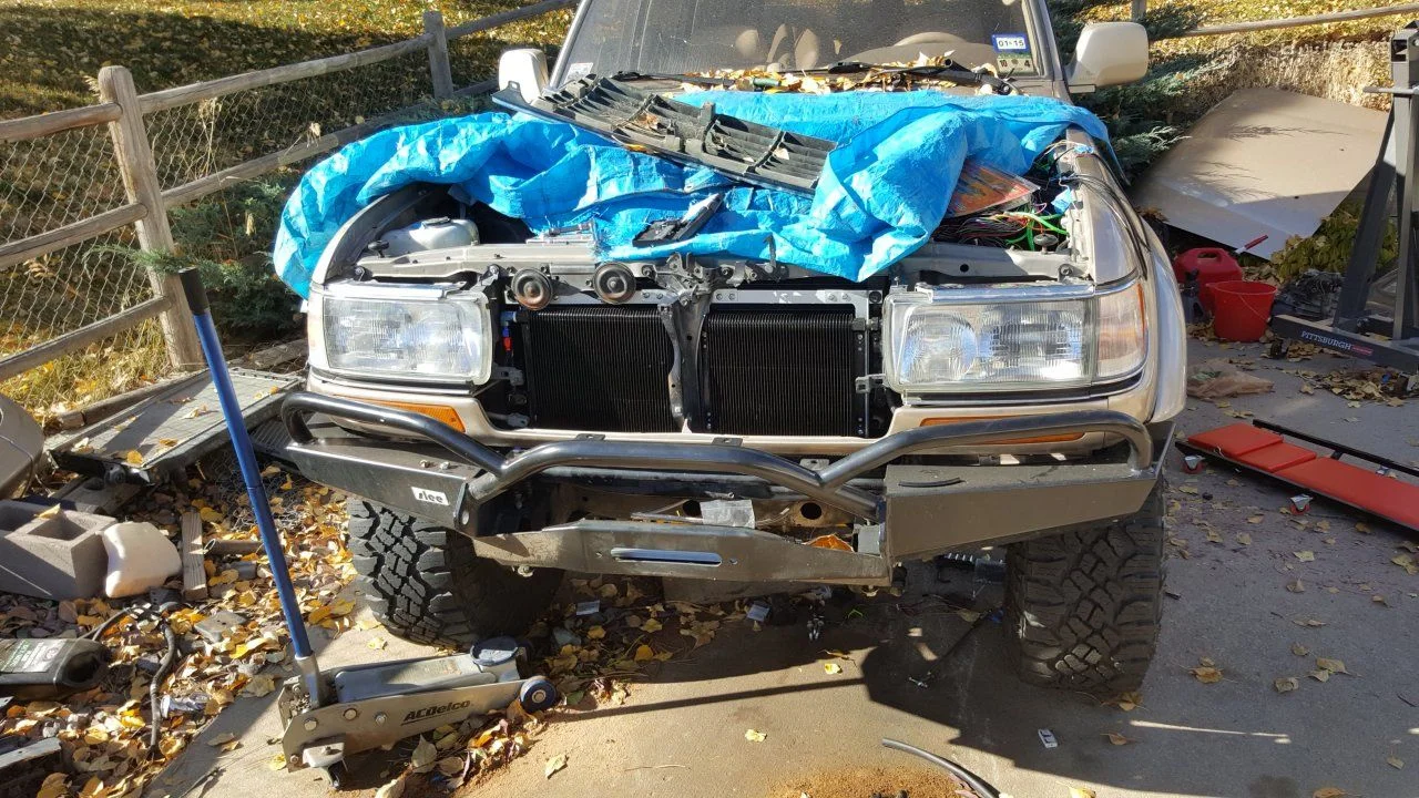

I need to fix power steering, address p1518 code, weld exhaust hanger on back, tighten everything up, reinstall hood and drive shafts. . . . Then she can go on her maiden voyage.
Found why the power steering fitting was leaking. . . .

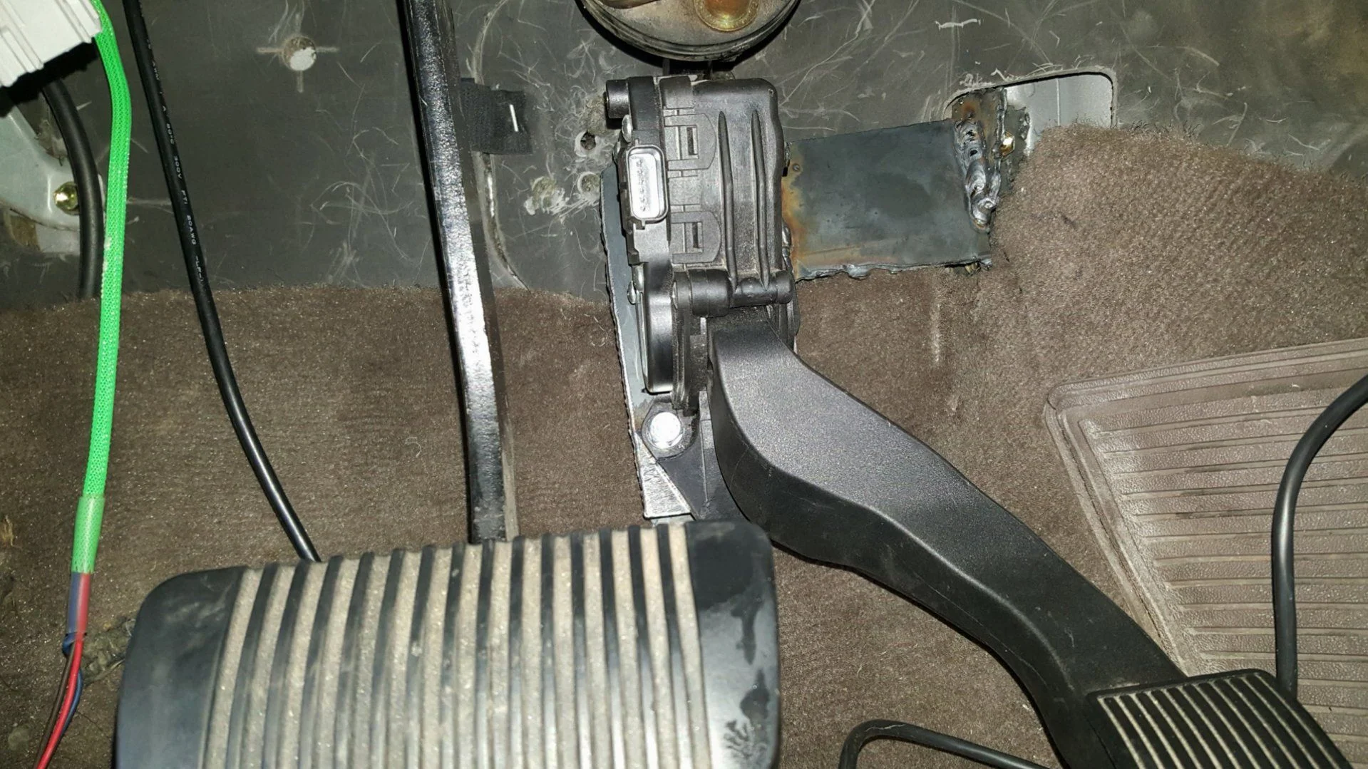

Not yet. It's dark when I leave. It's dark when I get home. And it's cold. It's hard to get motivated to go out and work on the vehicle. I mainly just need to hook up the brake booster and mount the GM gas pedal....
got the gas pedal mounted. not the best solution, but it will work for right now.
