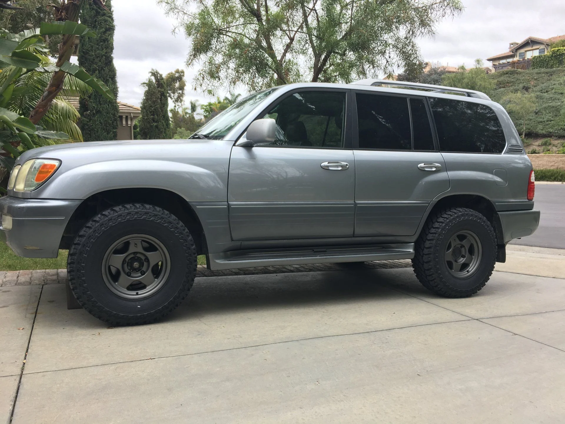

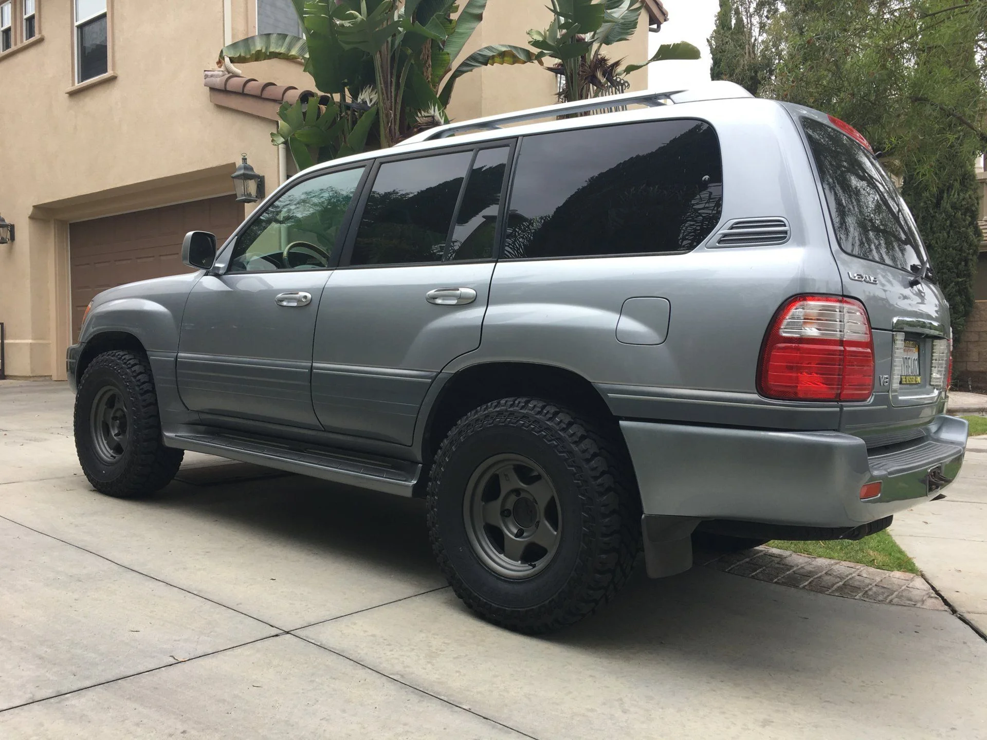

Got my leaking AC repaired and installed stainless steel brake lines. No pics of that, but here's some from the desert this weekend -
ih8mud, gonna be hanging out in a carwash for the next few days
Are there some other new goodies attached to the back of it? :D
haha yeah, 4.88s and front and rear ARB lockers. The cruiser drives nice now - great to have the stock gearing back.
Did you have the ARB lockers for a while or is this something you just installed? Any reason you went with air lockers vs electric lockers?
I might get this down the line, but still not 100% sure which ones.
I just got them installed today at Cruiser Outfitters (@cruiseroutfit) - I ordered them a little while ago and they pre-built the diffs so installation only took half a day.
I've never really looked into e-lockers. I had air lockers on my old tacoma and they worked great. I trust Cruiser Outfitters and they've always been stoked on ARBs - plus, I already had a compressor for airing up tires so it's not too hard to add the locker manifold afterward. Plus I know the ARB carrier will strengthen the front diff and make that less of a weak point - I would assume the e-locker would do the same, but not sure.
