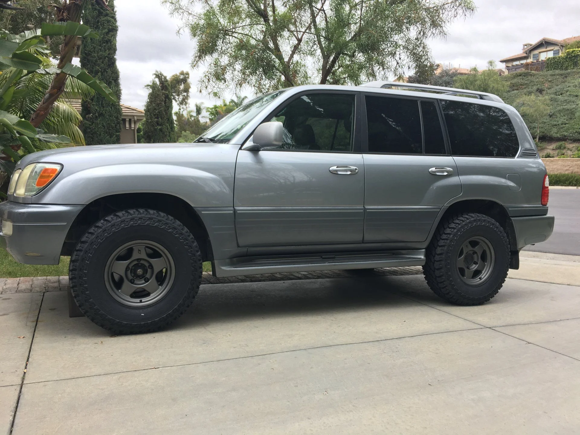

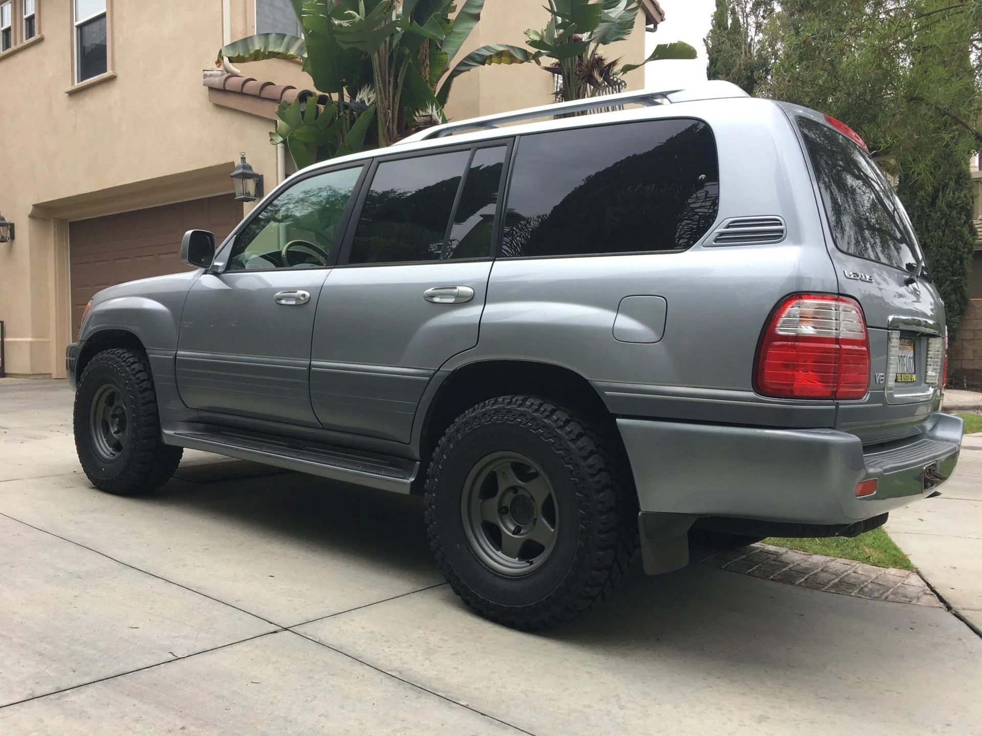

Glad to hear - that's a good looking truck! I kinda want to buy some more SCS wheels and run two different sets cause I love how they look.
Ordered mine last week and they arrived in 3 days... SCS had Matte Gunmetal and Black available including the lugs.

No regrets on the Slinky setup. Very happy with it, and I want to upgrade to stage 4 at some point - would be ideal to be able to dial in the dampers for the right amount of weight/speed. For hitting trails at speed I'd recommend a full overhaul - shocks, torsion bars, springs, bushings, UCAs, extended sway bar links, extended brake lines and bumpstops (which I still need to do - next on the list.) But it's super fun, and especially when aired down a little, surprisingly smooth.
I will say, the Icon Stage 3 setup will probably get you very similar if not almost identical results. And you could also piece together a great setup with Slee shocks, radflo, king etc. But it's nice that the Slinky setup is a complete package, and the dual rate springs are super nice for both offroad and around town.
I think you would like the 4.88s. yeah it would be slightly low but if you're not living on the highway you might not notice that much. It feels good to get the acceleration and gearing closer to stock. Still no fast car, of course, but better around town and it feels like the engine/trans is working less to get up and go.

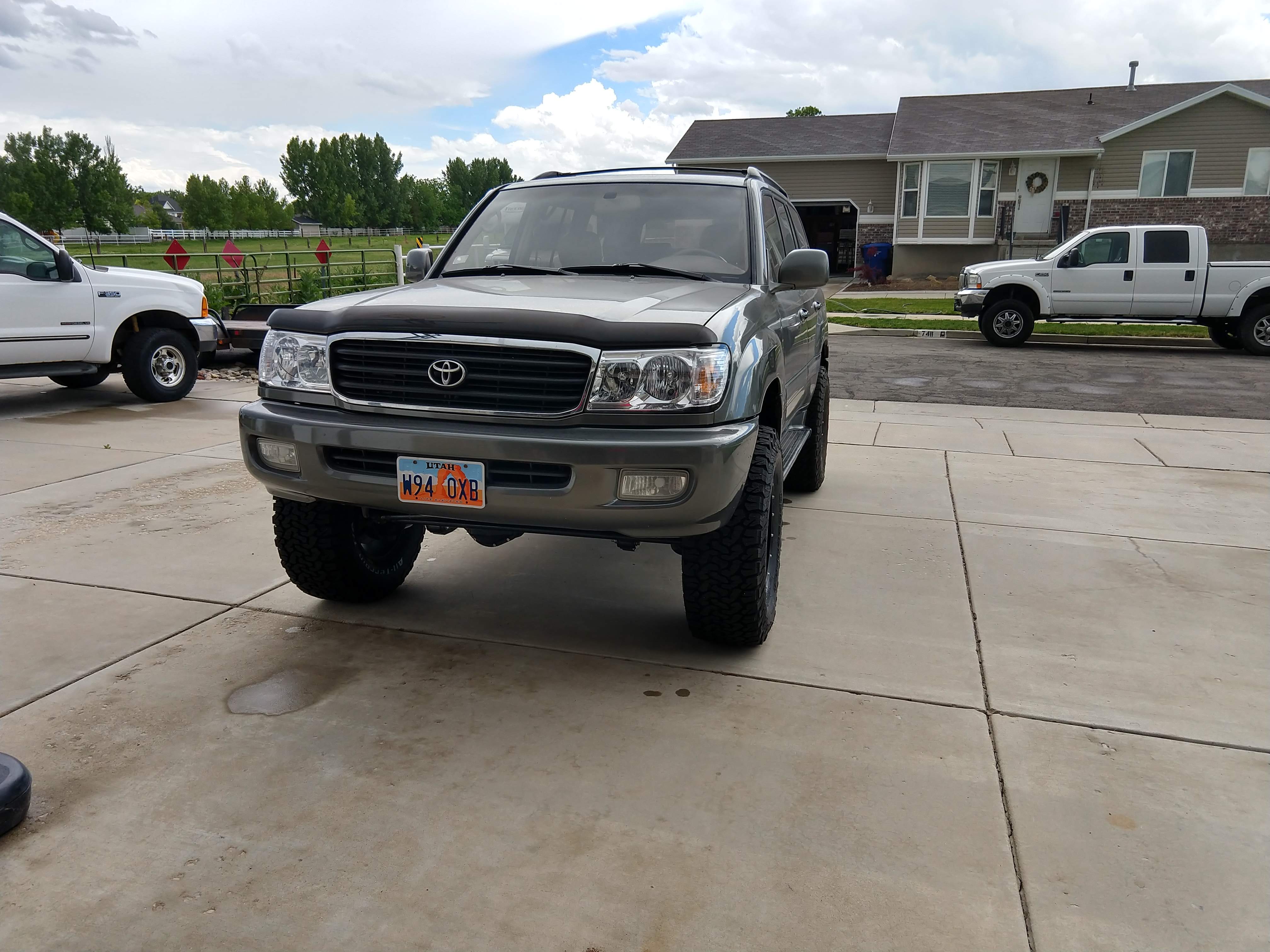

I didn't have much luck finding the marker lights when I needed one, so I ended up with Depo housings. It's the headlight and marker light in one, and I'm actually pretty happy with them. Got them from @ranma21
Those look great. I have an LX though, so I wouldn't be able to use those. I'll message him about the stand alone clear lights though.
81621-60220 and 81611-60240. Should be ~$65 each.
Perfect - was just going to look those up. Is that the land cruiser version? thanks man!
I run the eagle eye headlights which to me seem about like the Depo lights. They are pretty good I suppose we could say. I have been happy with them.

It became apparent that my LX had been wrecked on the passenger side the replacement was obviously not OEM so it had bad cracking and would take on moisture.
I'm replacing my LX lights with the front end off a '99 LC with glass. The LX headlights are plastic and all fogged and chipped up. I can swap them for very little money (have to paint the hood and bottom trim piece)
