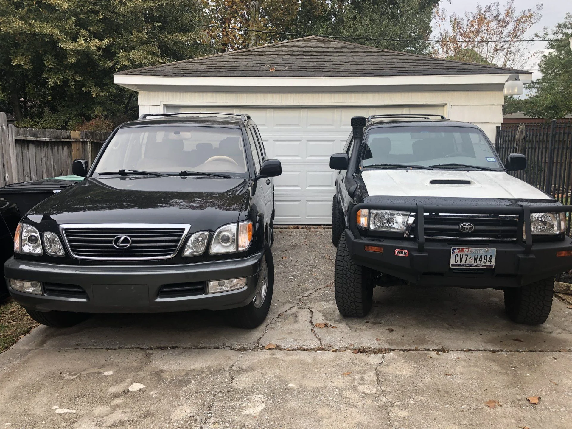

Uh oh... look what I dragged home:
More info! Mileage? Interior? Deal?
Well, my brother in law was looking for a 4Runner 4WD so I was helping him. Cruising Craigslist, EBay, LetGo, AutoTrader, OfferUp, etc... I was also looking for Tundras, Seqouias and Land Cruisers.
I said to myself, “if I see a cheap LC or LX 80 or 100 I will pick it up.”
This one popped up on OfferUp for $5,000 and I was at a janky little car lot within hours. He said it had an odometer discrepancy (it read 97k miles but looked like 250k). I had my buddy pull a Carfax while I explored it. Crawled underneath and it looked bone dry except two torn outer CV boots. Inside, the carpet looked clean, it had new front and middle seat covers (except headrests... kinda odd) and the third row was very worn. Steering wheel was worn through but it had a nice cover. Shifter leather was decent and all the lighter wood was there and not faded or peeling. Door panels looked rough, especially the tops.
The driver side headlight has a chip and moisture.
Pic of the seats and console:
So I started it up and it ran just fine with some whining (maybe Power Steering Pump or pulleys) but ran pretty smooth. On the test drive the suspension handled fine (although the AHC did not work) brakes had a slight shimmy from a high speed stop and the pedal feels better when I double pump the brakes. Everything works electronically except the AUTO AC button. Rear air is fine, ice cold AC and Hot Heat.
My buddy gets me the CarFax and it was corporately owned from day one to 40k miles and the rest of the time it was owned by the same person in Colorado. Almost every maintenance record was at a Lexus dealership in CO until 296k miles. I am still going through the Toyota Owners site over all the work done. It had a cluster swap at 347k miles but no documentation.
I felt like it may have been a flood car that was not documented so I aimed low at $3000. They said no. I told them to make me buy it today. They said $4500, I said, “I will drive it home with $4000 in cash in your hand right now.” I drove home with paper plates 20 min later.
BTW, I did offer to fix it up up for my brother in law and sell it to him at cost but he wants a 4Runner.
I have spent some time on my beloved 3rd gen (sport hood, ARB Bumper, Snorkel, new grille, 99-02 Headlights, door weatherstrip, and redid my driver seat foam and seat cover) but I sure do like the ride of the LX / LC. I was thinking of baselining and going through the LX and putting a lift on it (or fix the AHC) and sell it but I know the cluster swap / odometer discrepancies will hurt the resale. Decisions, decisions...
