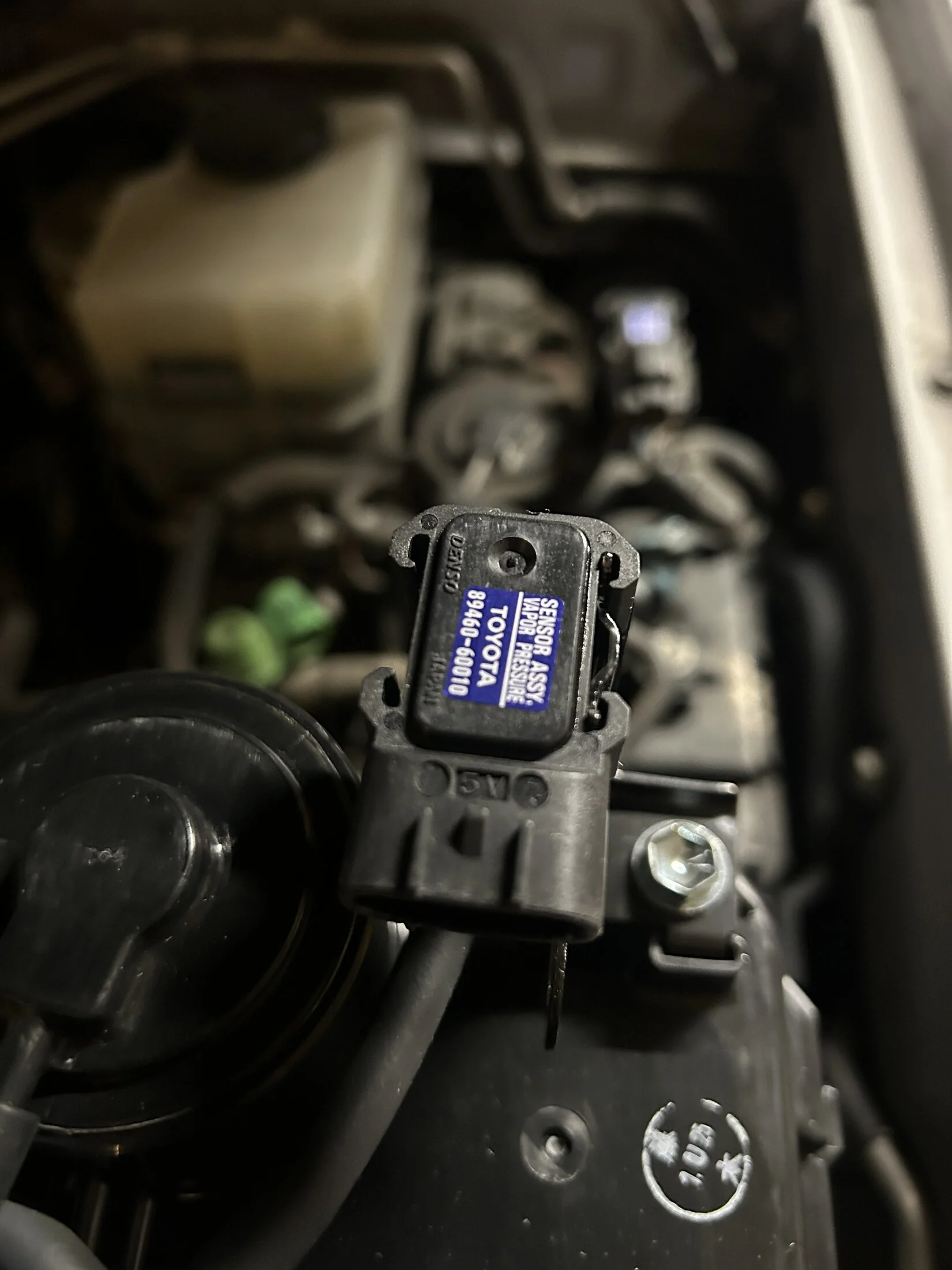

Exactly 2595 miles later we got home without CELs. I ordered a Charcoal Cannister and it would show up the next day. The next day, my wife took the LC to work, and barely made it back home. Check engine light (P0100), and limp mode. I could not restart the truck.
I put the new Charcoal Cannister in and replaced all the vacuum hoses around there. I was happy to see the Rockauto Charcoal Cannister was a Toyota / Denso unit. The electric valves were Toyota stamped as well (around $350 shipped). I pulled the PCV valve and cleaned it (it was clogged) and cleaned the Throttle Body butterfly. Unhooked the battery and let the Computers reset, fired it up and it ran awful and smelled but it started. It popped another code, P0100, and was not running great but was relearning and getting better albeit a very high erratic RPM. I bought a Hitachi brand MAF sensor and replaced that and the codes went away and seemed to fix most of those issues.

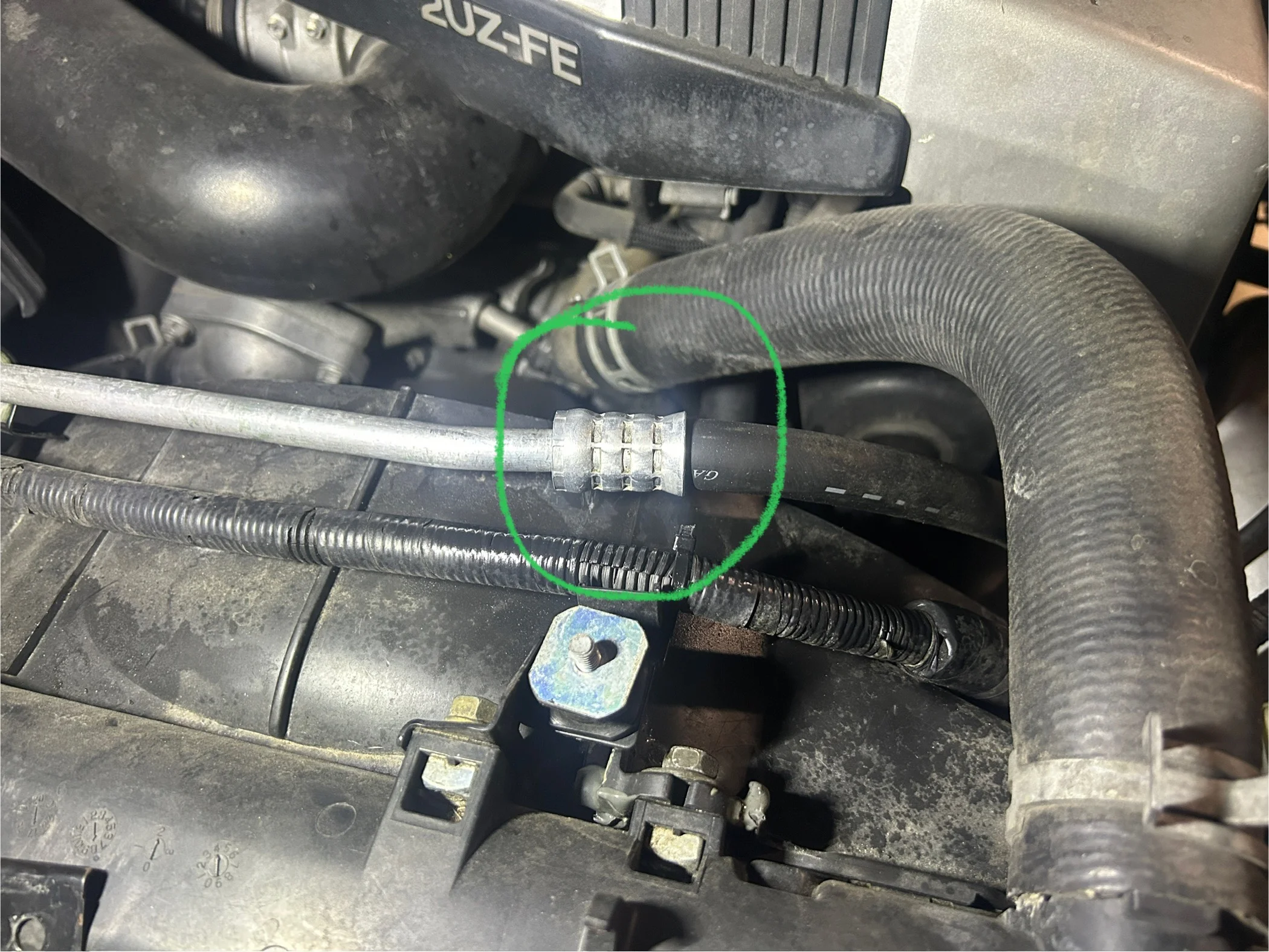

We started losing the dryness in the HVAC system. I noticed the discharge line that got pinholes in the rubber part that I replaced a while back was leaking at the metal to rubber connection. Got another one on order.

P0100 MAF, is one to watchout for and fix ASAP. Bad MAF, more than most anything else, damages CATs fast. When "some" MAF's fail or going bad, result in dumping fuel (rich fuel mixture) into CATs. CAT "may" then ignite and burn up.
P0100 MAF, is one to watchout for and fix ASAP. Bad MAF, more than most anything else, damages CATs fast. When "some" going bad, result in dumping fuel (rich fuel mixture) into CATs. CAT "may" then ignite and burn up.
I swapped the MAF out last night and took the truck for a drive and WOW! What a difference! The truck is more peppy, reacts faster, and accelerates smoother!
I feel like I should have done this a long time ago but had no idea it was going bad over time. I have cleaned it periodically with MAF Cleaner and never got noticeable results.
Glad it help!
I see weak old OEM MAF or junky aftermarket, cause issues more and more as our fleet ages. Without see a (CEL) DTC P0100.

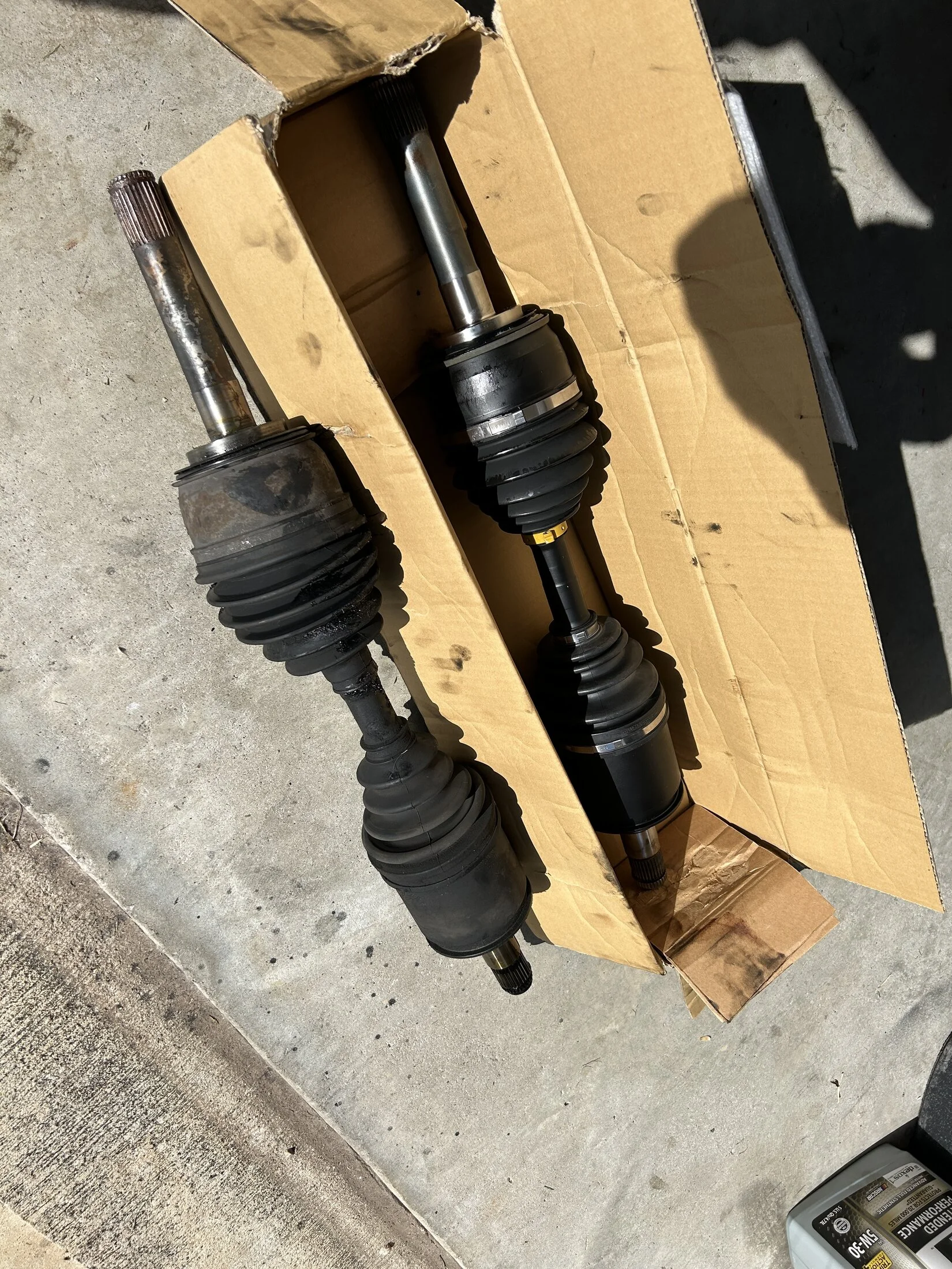

Oh wow! I completely forgot to update but I ordered some hub flanges (and all associated parts) and while examining the axle splines I decided to order 2 CV Axles (and 2 for the LX470) while there was a sale going on.
I installed these before the Thanksgiving trip to CO so I would feel sure footed and all of the driveline clunks have gone away, Especially, the P-R-N-D clunks and coming to a complete stop then accelerating from the stop.
The Flange tool came in handy again and I had to use different thickness C Clips on the new Axles. Feels like a new truck with the Axles and Hub Flanges.

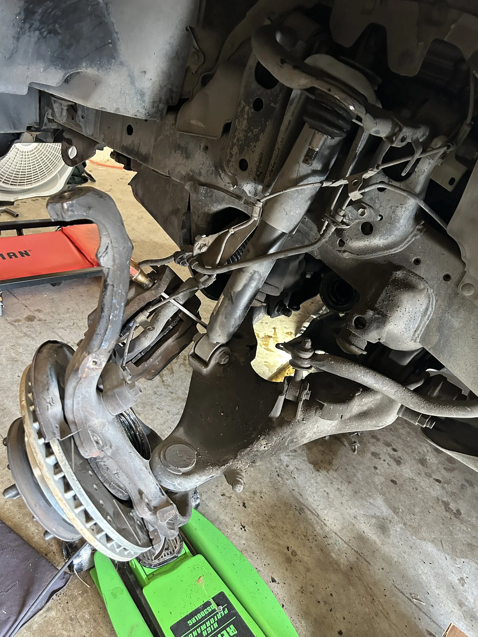

OUCH,:rolleyes:
Looks like caliper weight pulling on brake flex line and wheel speed sensor wire. Which we never what to allow brake flex line or wheel speed sensor wire, to hold weight of caliper. Also, never pry out a wheel speed sensor if they don't easily pull out. Either work around, leaving in placed by freeing wire housing block. Or tap out with 3/4" round wooden dowel from inside when wheel off off. Why? The inner workings (hose, wire) can be stretched and damaged, or wheel speed sensor prying can break speed sensor plastic casing. Most flex lines and speeds sensor I replace, are due to shop damaging them.
Personal I always replace diff side seal for FDS (AKA CV), when R&R FDS. Otherwise it's a 50/50 chance, we leak gear lube from old seal.
I also typically, R&R knuckles rear seal to FDS.

I barely tried to get the wheel speed sensor out. I didn't try hard because i didn't take it out when I rebooted these axles a while back.
There is no weight or tension or the wheel sensor wire and very little (if any) on the brake line. I have a screwdriver through a caliper mounting hole and through the sway bar that supports all the weight.
