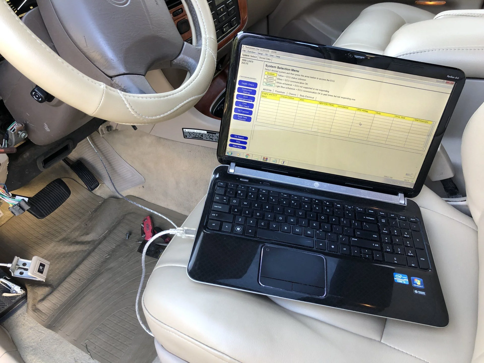

After a few hours over the last couple of days I finally got Techstream running through my 64 bit laptop. I started playing with it but had to leave due to our annual Christmas Eve Eve oyster fest with some extended family.
Hopefully, I can get this headlight electrical issue sorted out.

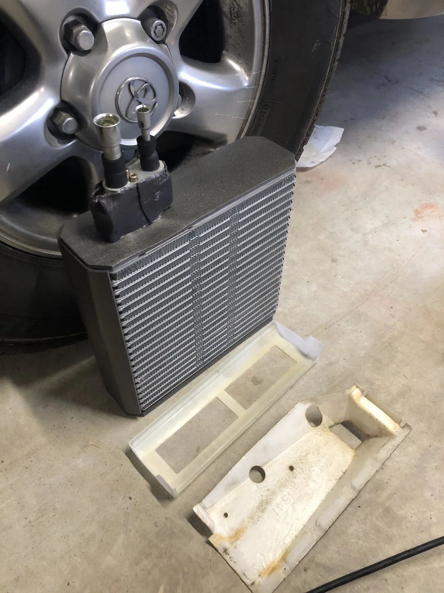

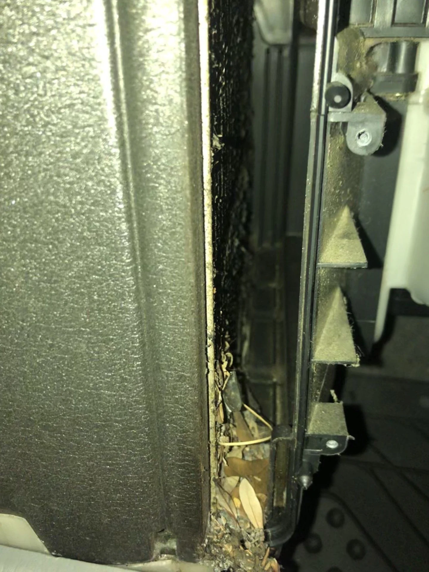

the leaky Evaporator Core was getting worse and we were filling up with Freon every couple of months so on Sunday I knocked it out.

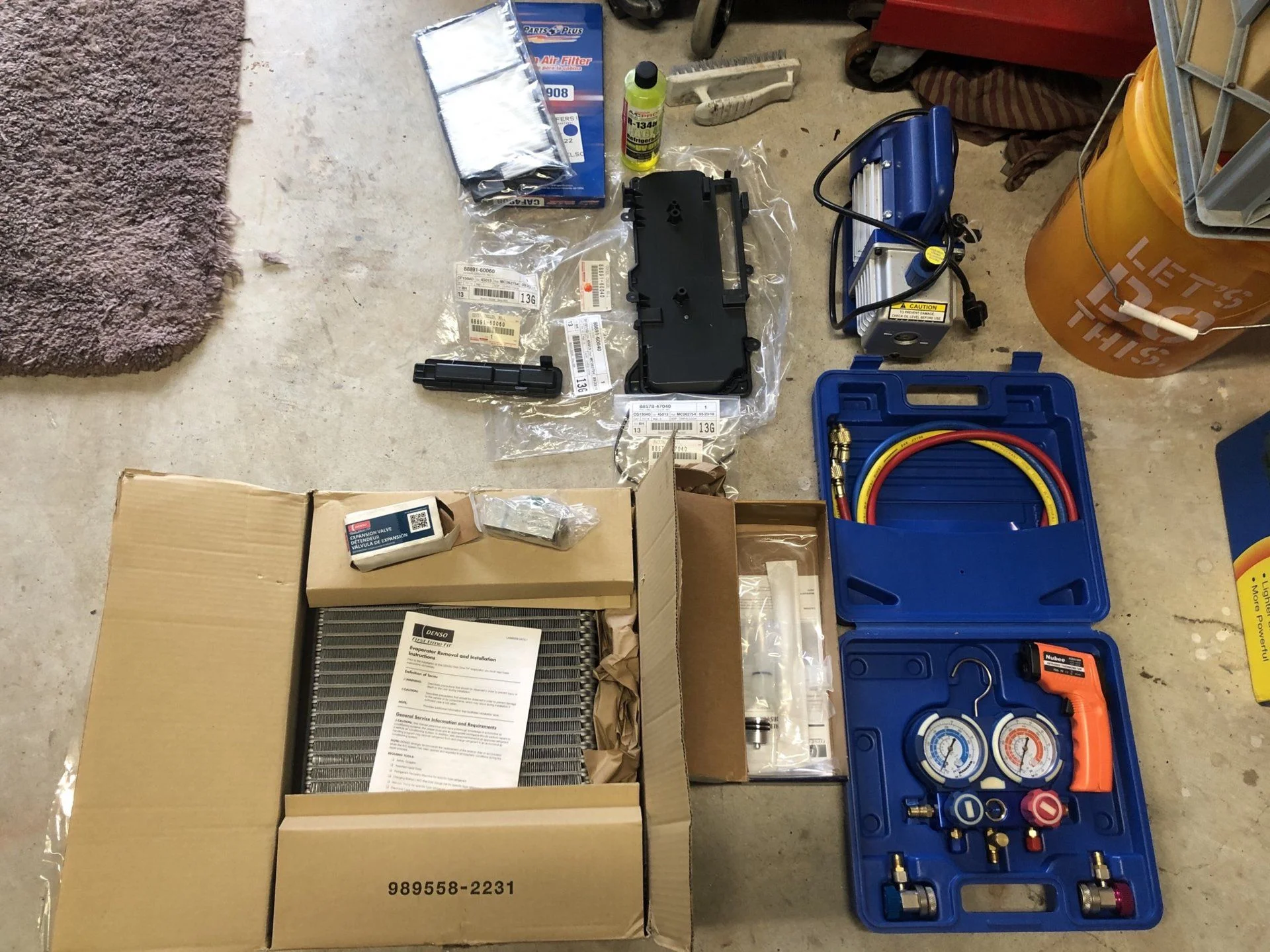

I bought everything to replace the whole system but decided to just replace the Evap Core and Dryer since I have everything to vacuum down and refill the system at home.

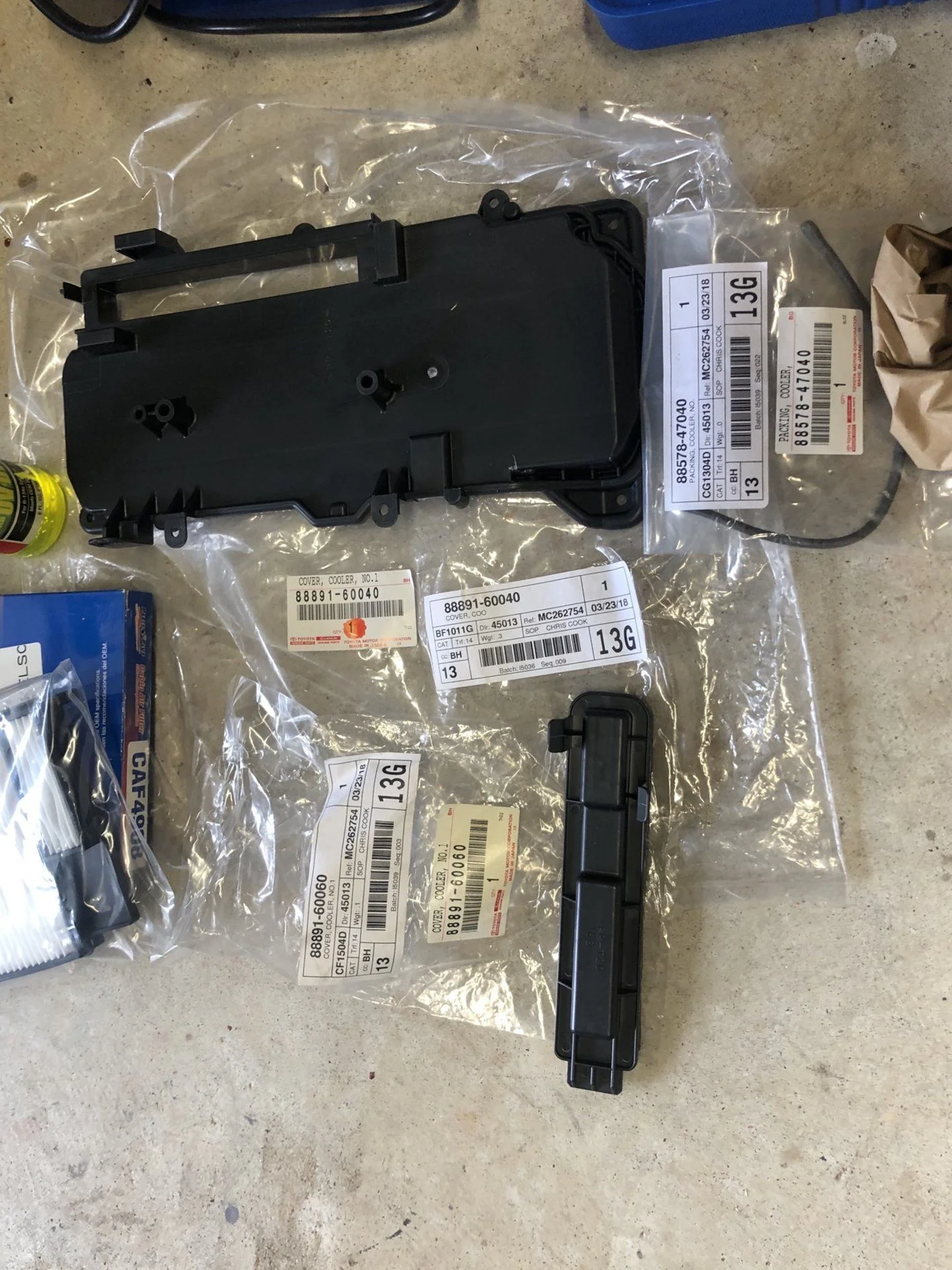

While doing this I also replaced the evap core housing cover with the cover that allows for the cabin filters.
The Cabin Filter addition items and new bottom seal for the housing (keeps those drips off the passenger's feet).

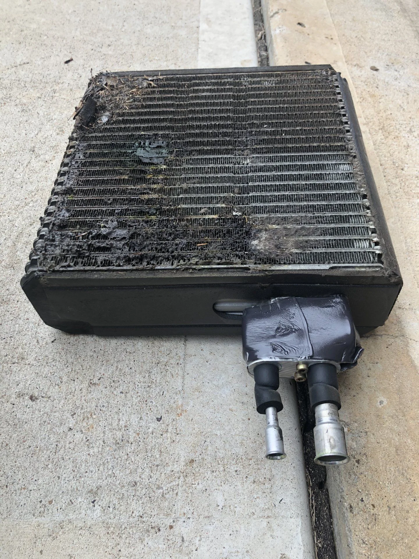

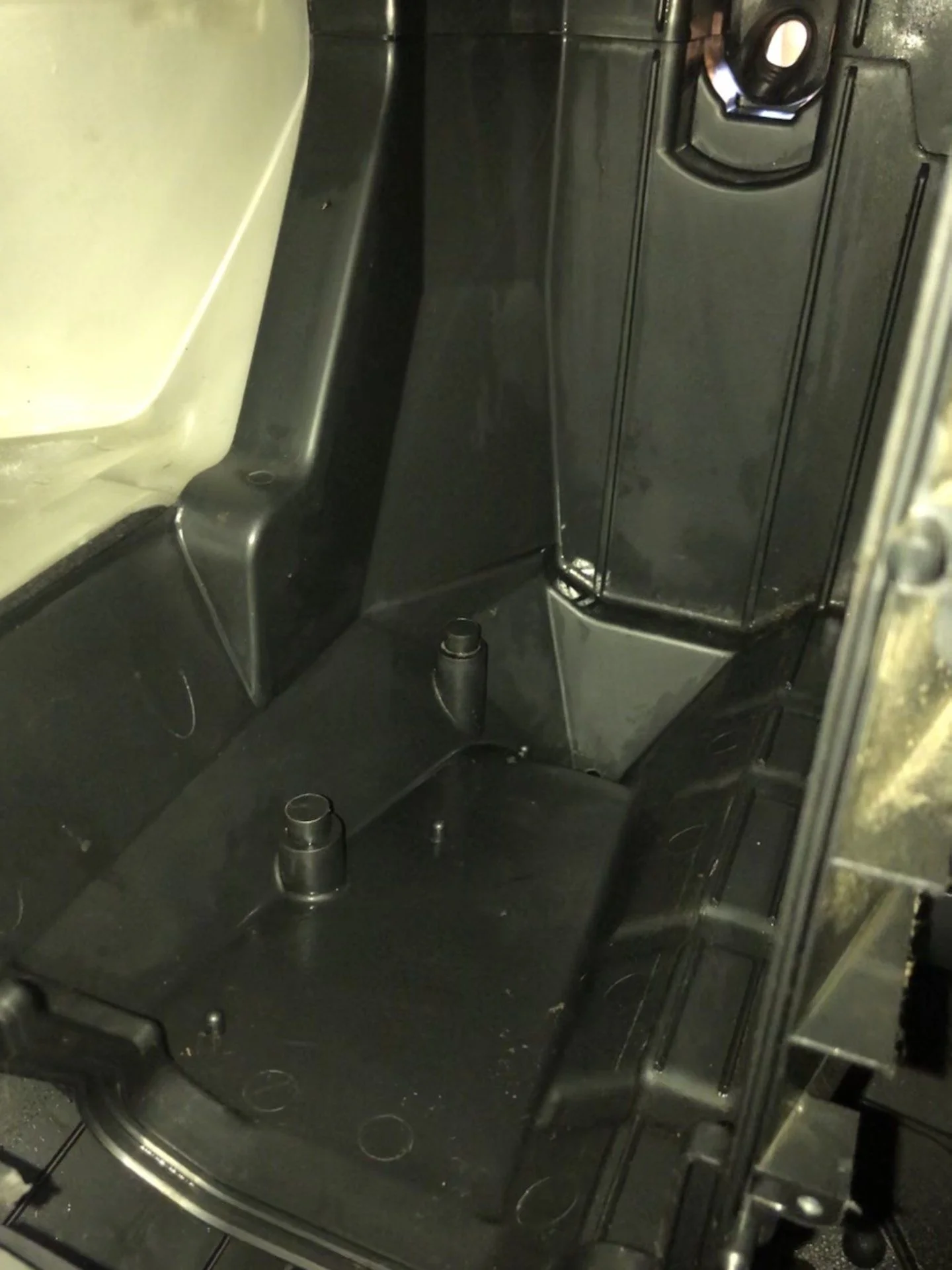

Here is the old one. The green slimy looking spot is where the leak is. I figured it would be down where all the crud was.
Look at all that nastiness.
I vacuumed the solids out then I sprayed some carpet cleaner in (for foaming action) and let it sit. Came back with water to rinse it down, then wiped it down. I also ran some weed wacker string down the hole and spun it to insure it was clean.

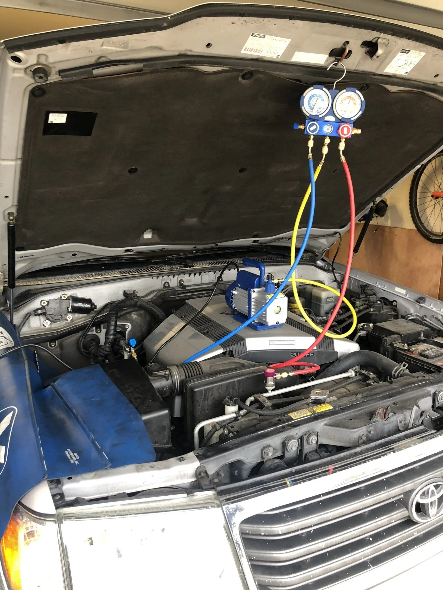

I put it all back in with filters and vacuumed down the system for 5 minutes.
It held for roughly 30 minutes while I installed the new Evap Core Cover, door, and filters. I also repaired the relief cut below the glove box during that time.
Charged her back up with X2 12 oz cans of Freon and it was blowing 45*. All done.

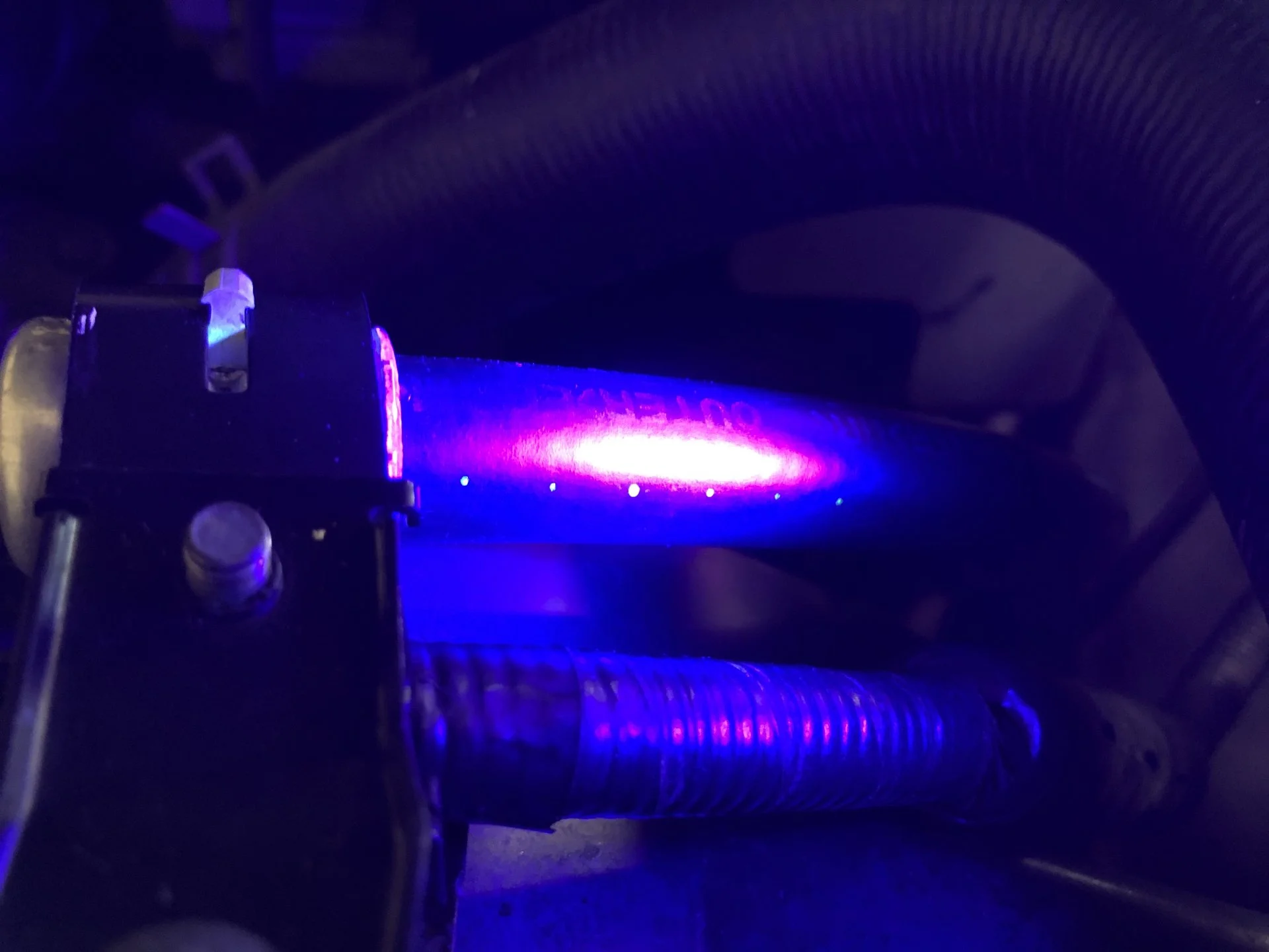

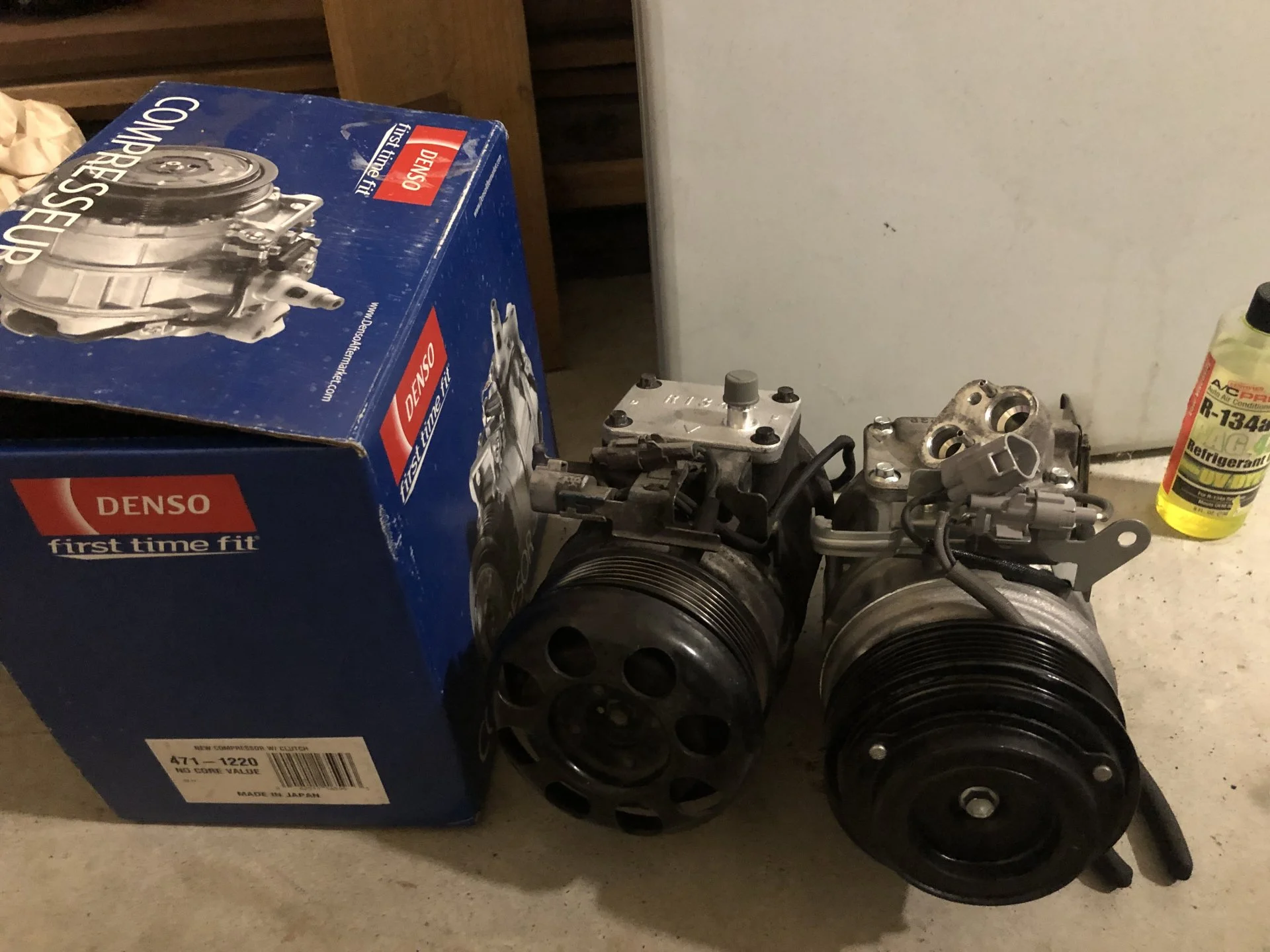

Been a while since any work needed to be done. Earlier in the summer, the AC light would blink occasionally so I figured the AC compressor clutch wasn’t engaging so with roughly 200k miles I decided to replace it. The hose from the Compressor to the Condenser also got pinholes in it so I did those at the same time.
So I'm guessing it's a UV dye and you use a blacklight? That's pretty interesting.

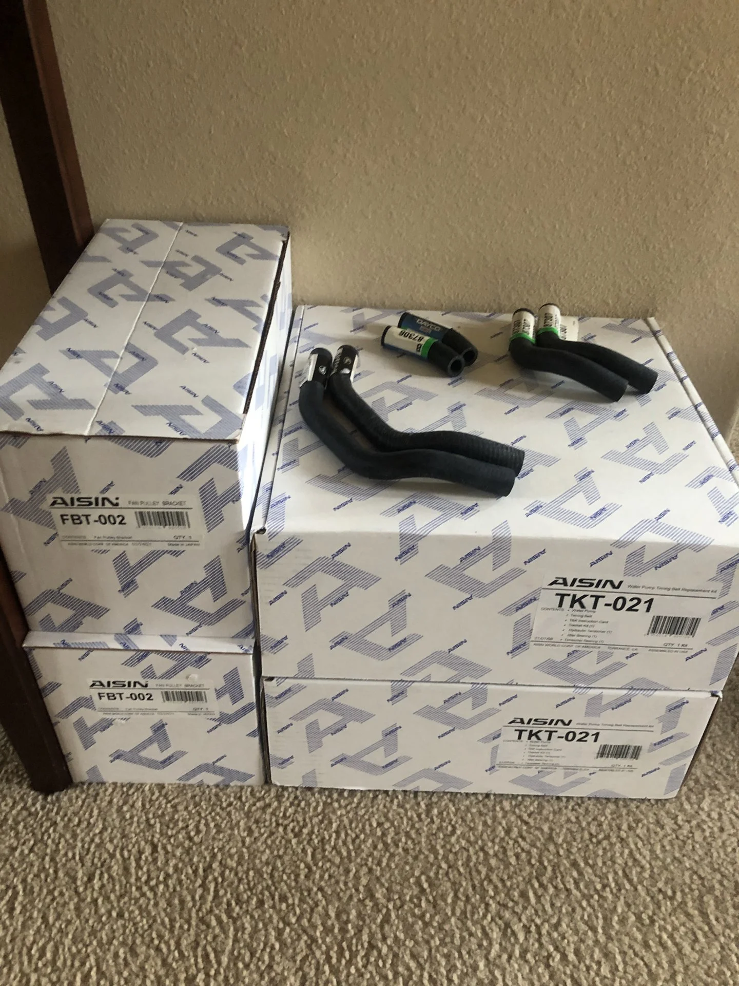

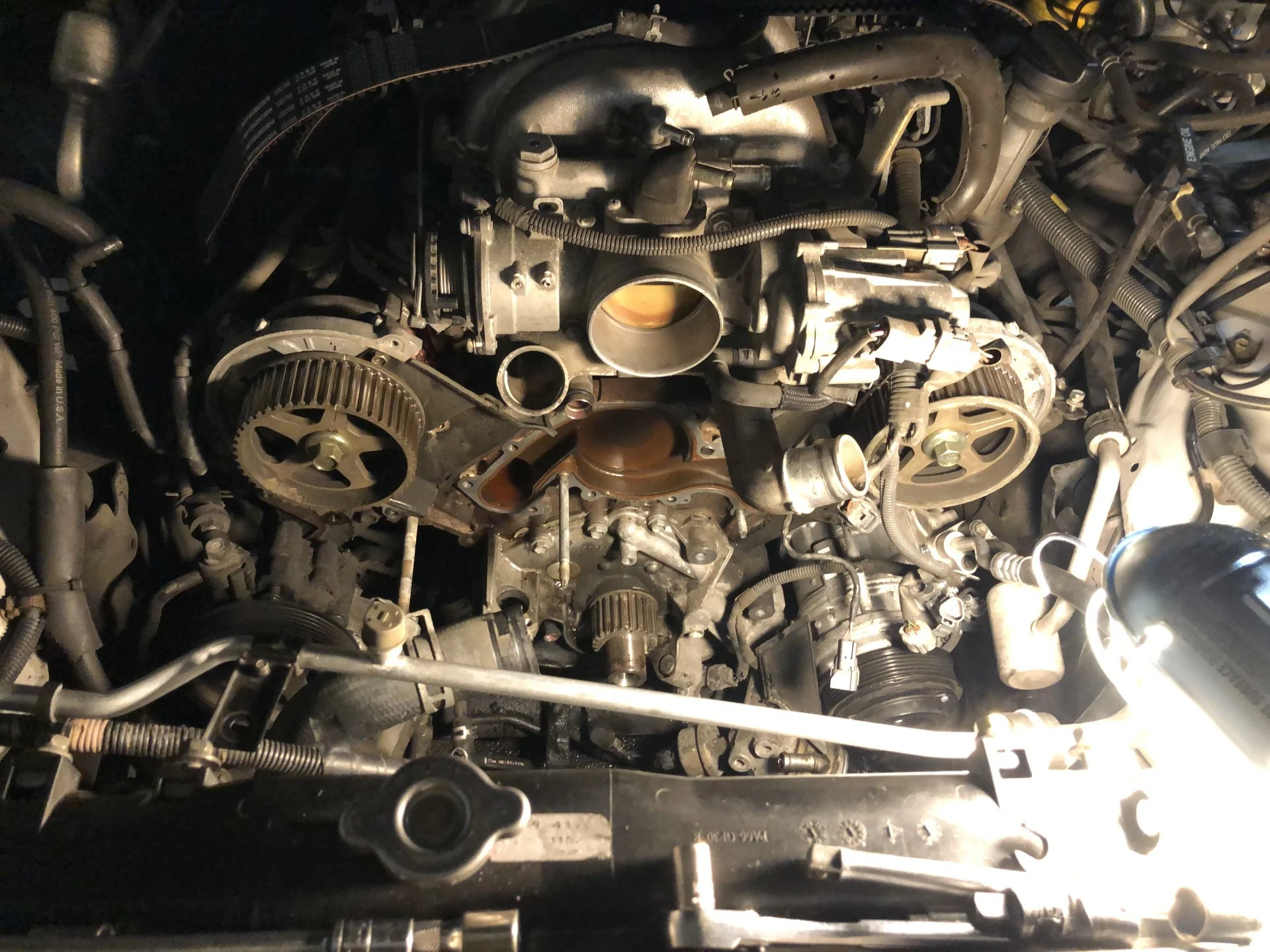

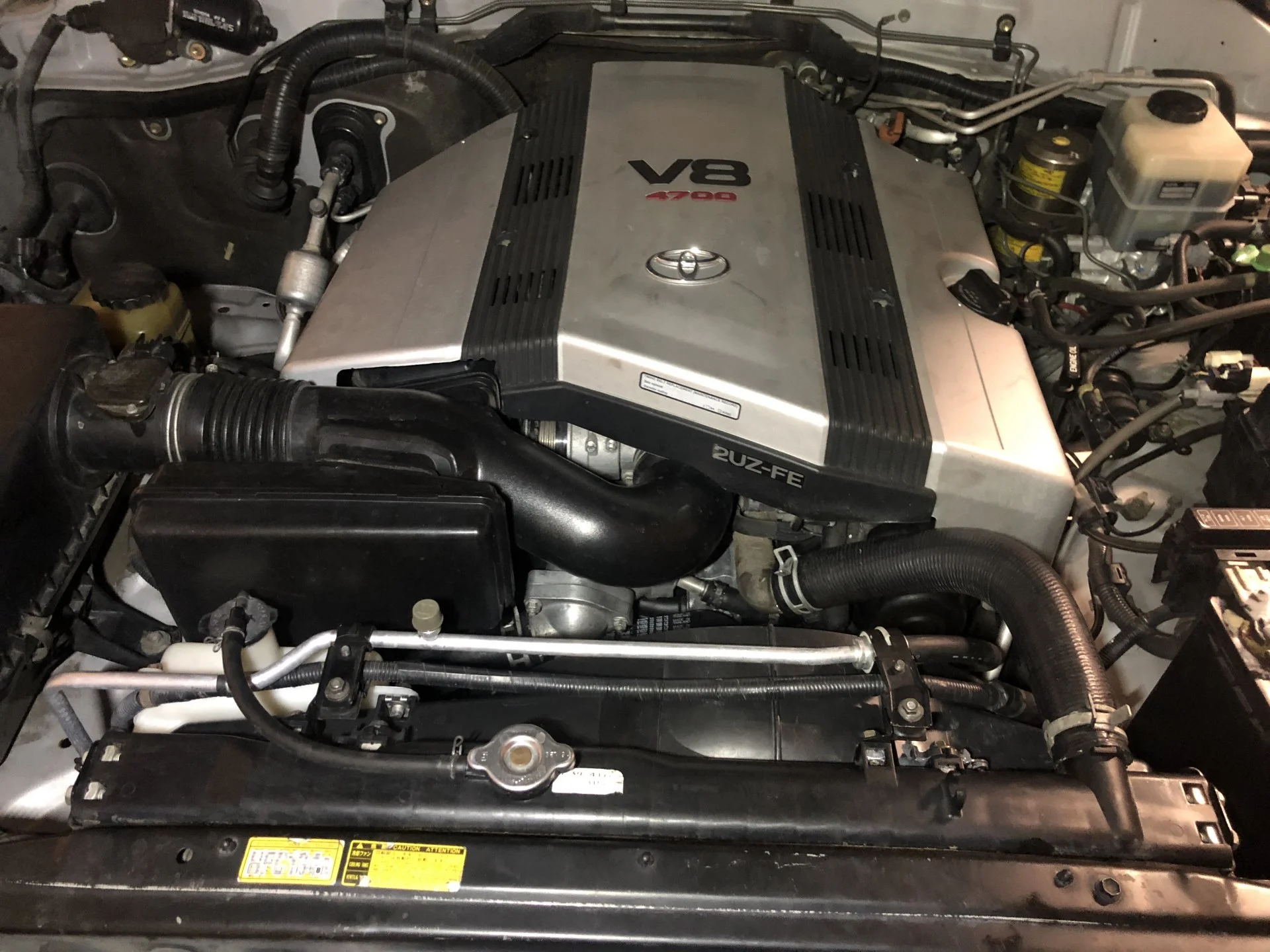

About a week ago, we were dropping my dad’s Trailblazer SS off and swapping kids over to the LC and my wife said she heard a noise when she started it up. It started making the noise again right there. I popped the hood and saw the fan wobbling… Fan Bracket. I assume it wasn’t done with the first timing belt job around 100k.
It was wobbling pretty good fellas. While waiting to turn right on red, I felt and heard it lock up once. I didn’t know if we were going to make it home but my wife was driving a chase car (my 3rd Gen 4Runner) so we went for it and got home with no issues. Amazingly, I bought two kits a month prior to do both timing belts (LX470 also) as it was close to time. I got new fan brackets, water pumps, tensioners, timing idlers, heater hoses (in that area), thermostats, serpentine pulleys, tensioner, and belts. All Denso and Koyo parts and Mitsuboshi belts.
It wasn’t too bad of a job. Having to remove the AC compressor was my least favorite part.
I also cleaned out the Throttle Body butterfly while I was in there with WD-40 and I toothbrush.
All done and back together. I will burp the system over the next couple of days.
Should be good for another 100k miles!
