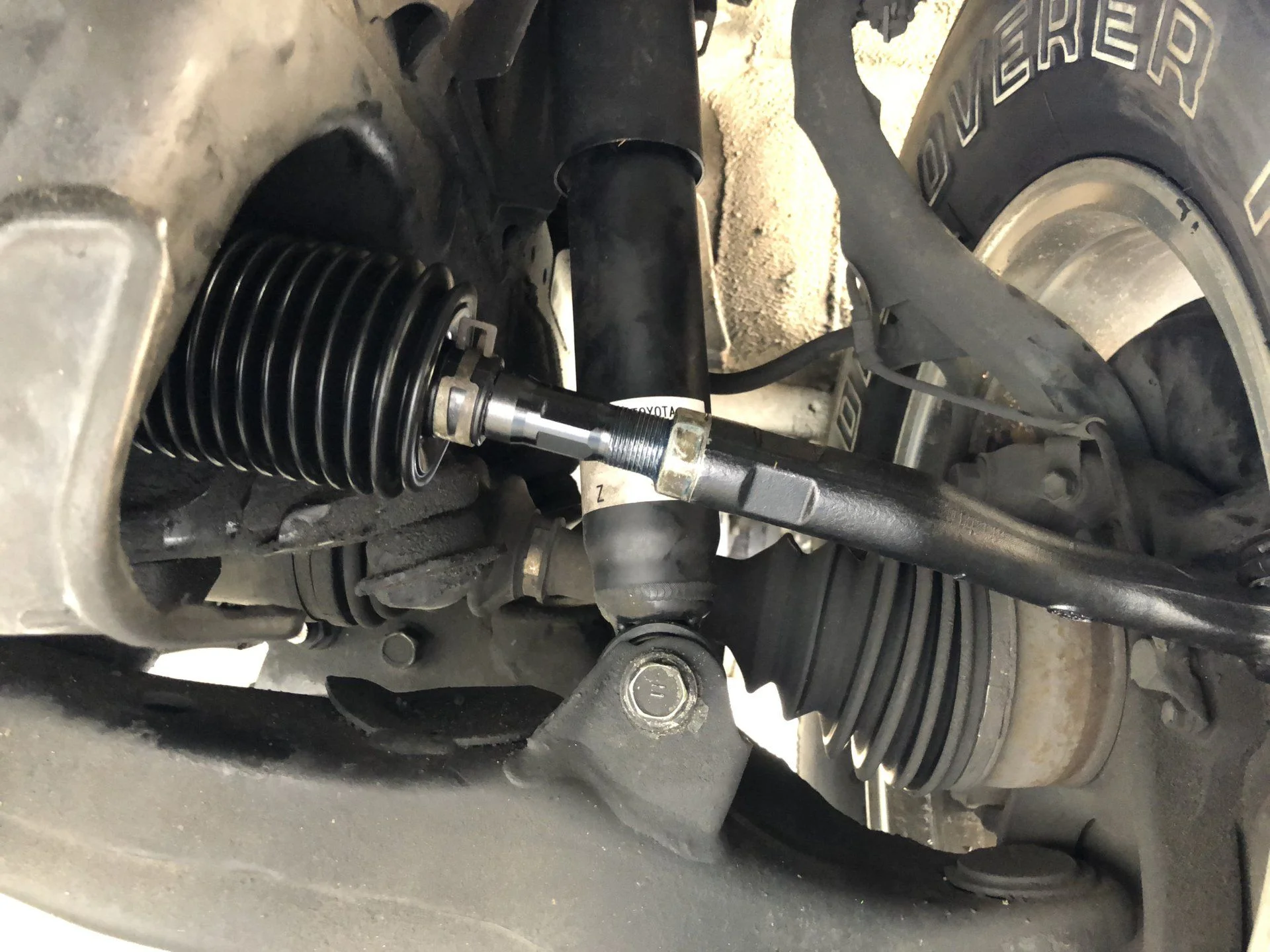

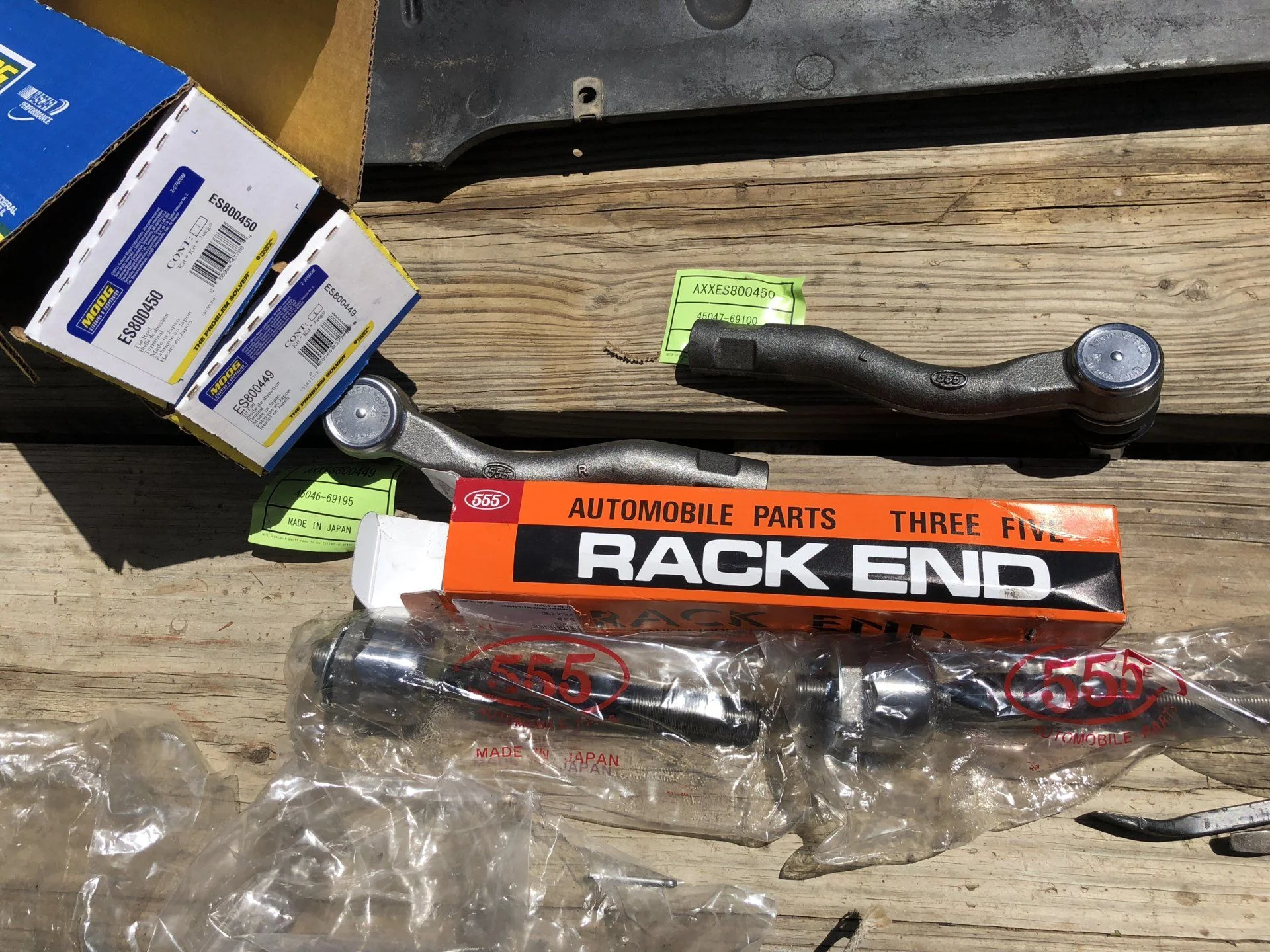

Had a couple hours while the kids napped today so I knock out the tie rods. 555 inners and got Moog premium from Rock-auto and to my surprise they were 555’s too. Digging in I measured almost 1/8” play on the inner driver and 1/16” play on the passenger. That is a lot. The outers were still tight. they were an unmarked brand and had been replaced at some time. The outers were missing the cotter pins.
Very little power steering fluid in the boots/ bellows but def more on drivers side. I will put some stop leak in to preserve the rack for a little longer.
Shot them with some engine enamal and 303’d all the rubber. Degreased and 303’d the boots/ bellows and cleaned the clamps.
All done. Anti seize and marine grease where it needs to be.. I also readjusted the driver side Torsion Bar back down 1/4” to level it. Time for an alignment. Amazingly, I found my missing steering rack nut too. It fell in front of the rack and got stuck in the PS lines... I still cannot believe how rust free this truck is.
Got an alignment today. Firestone lifetime alignment (sometimes it takes them a couple times). The front end is so tight now. No more torque steer to the right and diving to the left when letting off the gas. I figure that came from the inner tie rods being so loose.

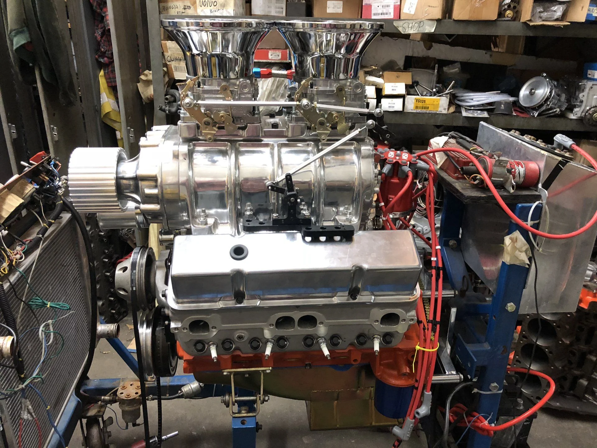

Ok I'll ask. What is that motor going in?
...still looking for an adapter kit to the LC... :rofl:
Funny, we are not sure yet...
Pops has always wanted to build a blower motor so he did. It is a 400ci Dart Small Block, Scat Crank and rods, JE pistons, Jesel rockers, Weiand 6-71 polished Supercharger, no expense spared... It should put out between 750-800HP.

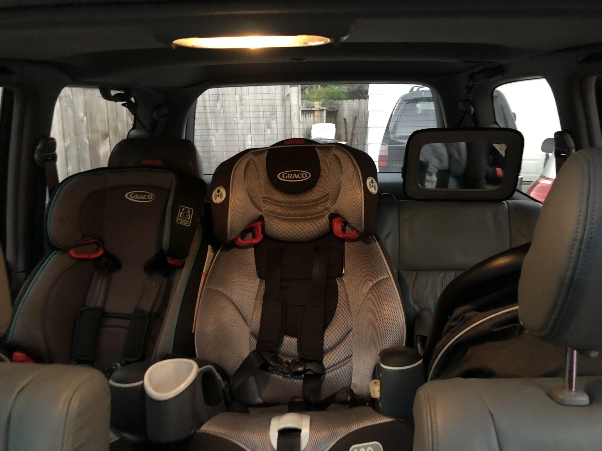

Got all three seats in... Baby 3 will be coming home in a Land Cruiser.

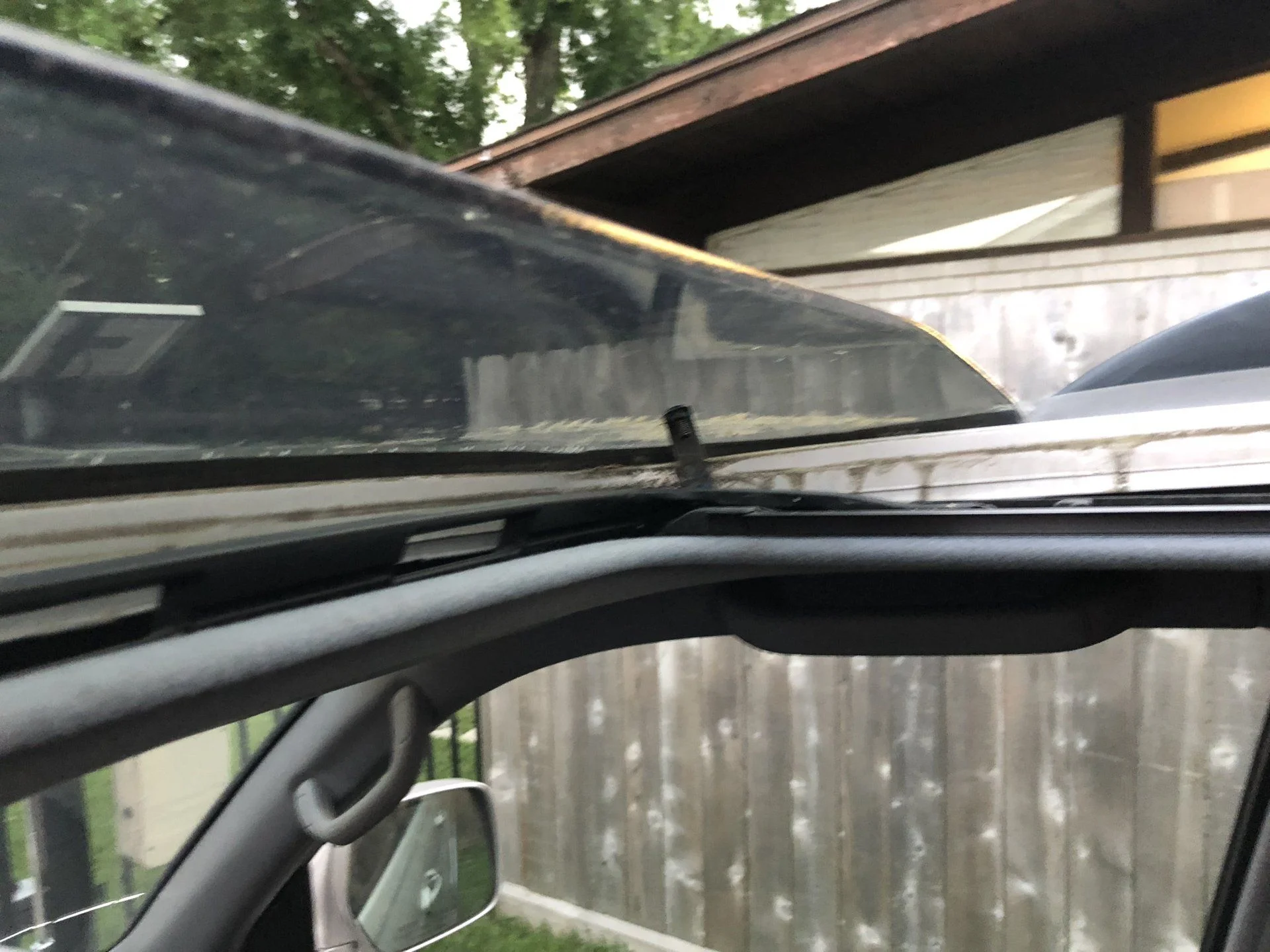

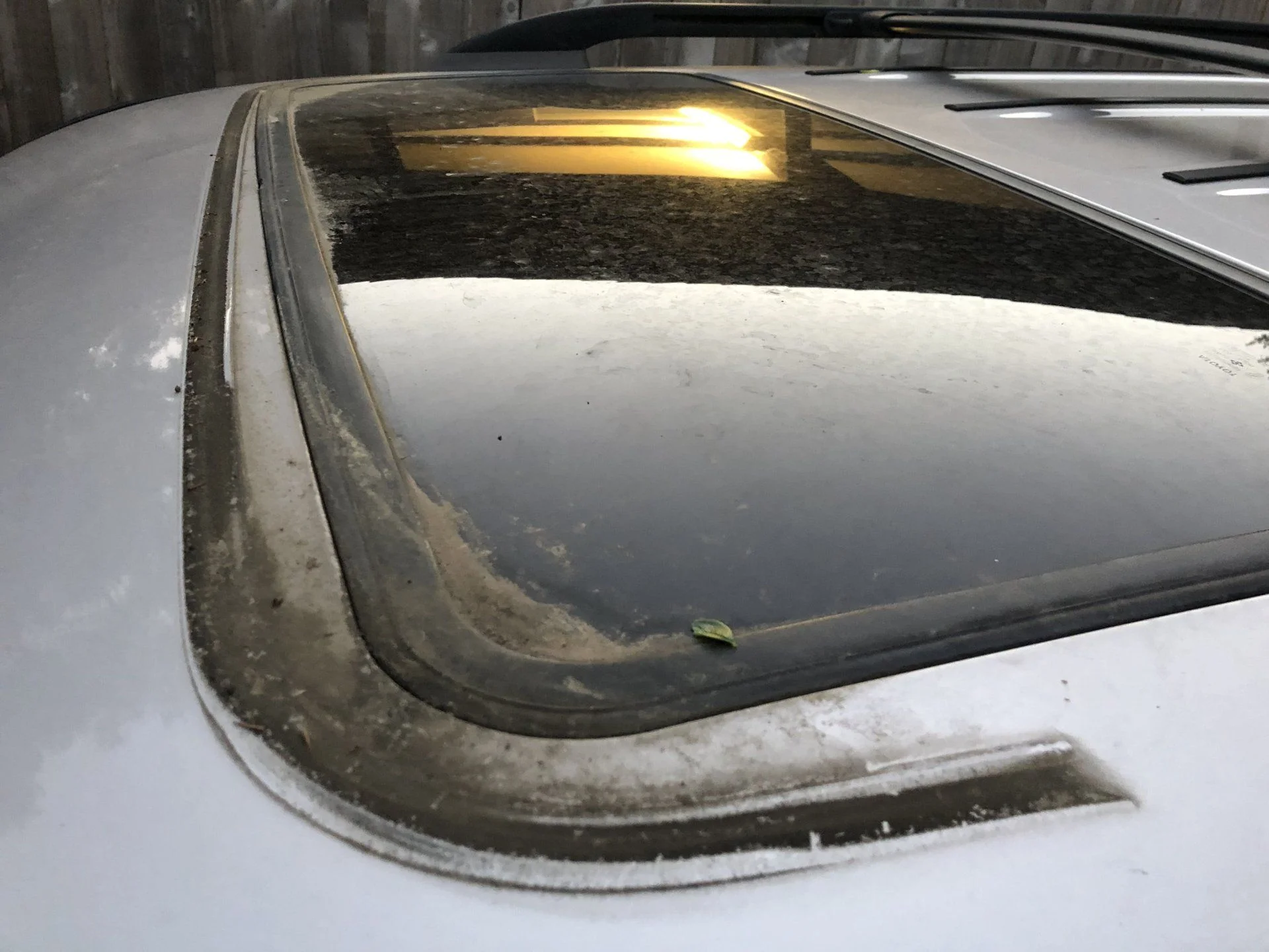

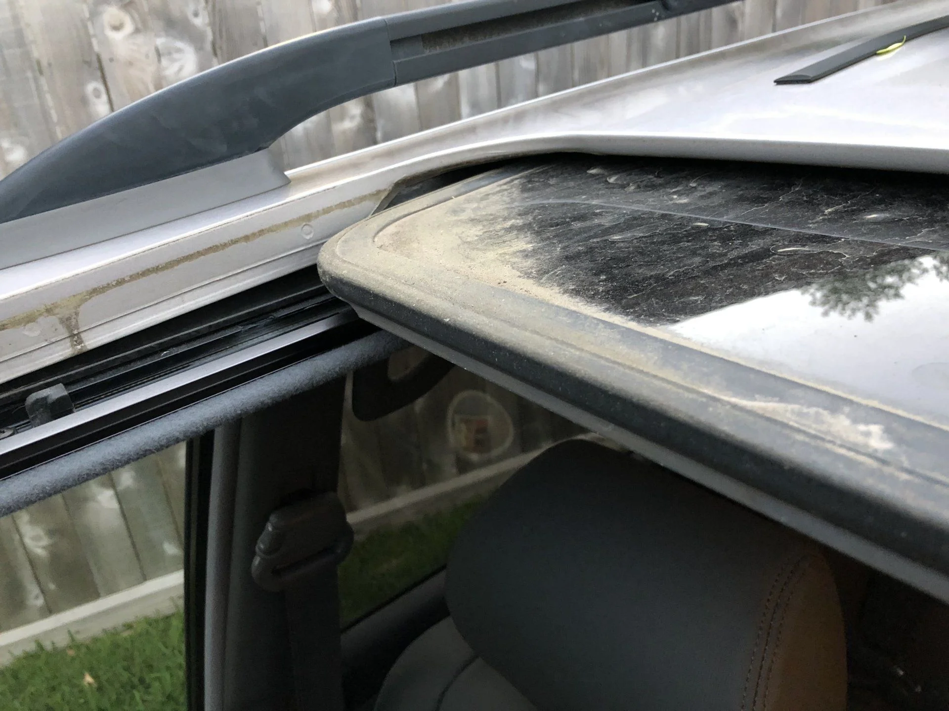

Also pulled off the sunroof wind deflector. I am not sure if these actually do anything or not. Filthy under there.
They couldn’t even put it on straight?
Also pulled off the sunroof wind deflector. I am not sure if these actually do anything or not. Filthy under there. View attachment 1680192

I removed my wind deflector looked about the same underneath but cleaned right up nicely. It was worth cleaning all the channels while I was up there too and I've found that my sunroof moves a tad smoother. i know some Cruisers have issues with the sunroofs getting jammed, but a quick cleaning can go a long way.

Here is three deep in the middle row:
Very little power steering fluid in the boots/ bellows but def more on drivers side. I will put some stop leak in to preserve the rack for a little longer.View attachment 1678294

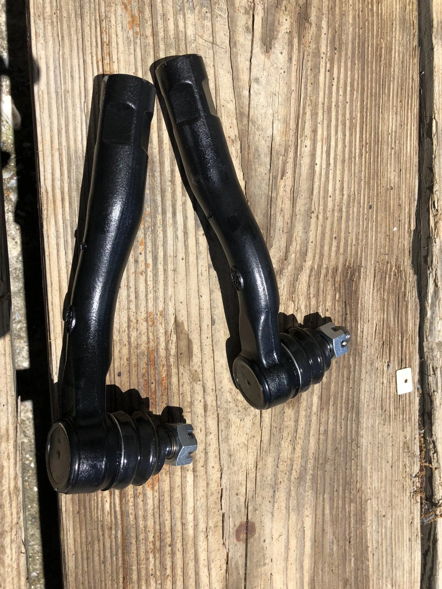

Just FYI if it helps anyone else, I bought moog outer tie rods recently and they were 555's as well.

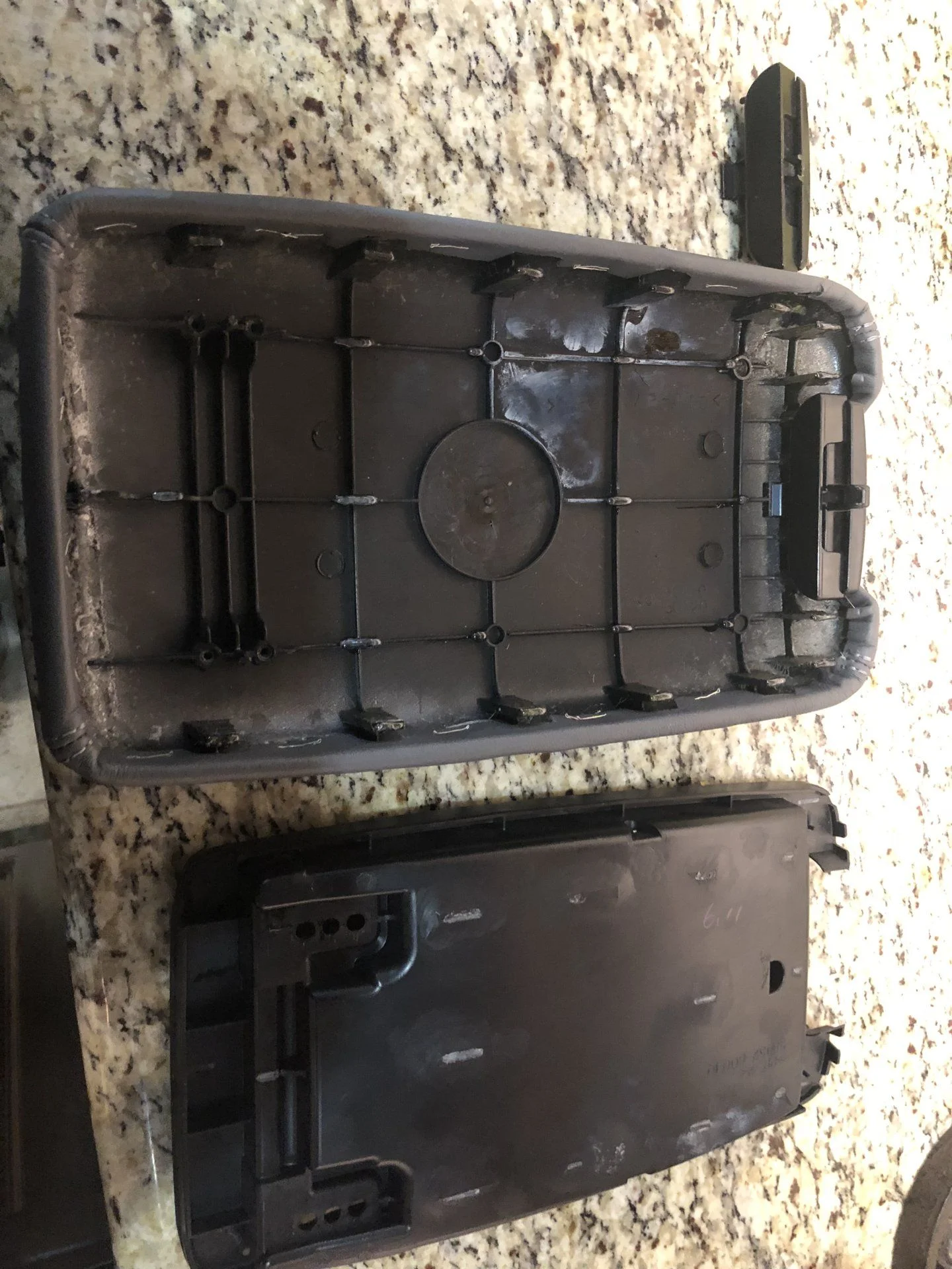

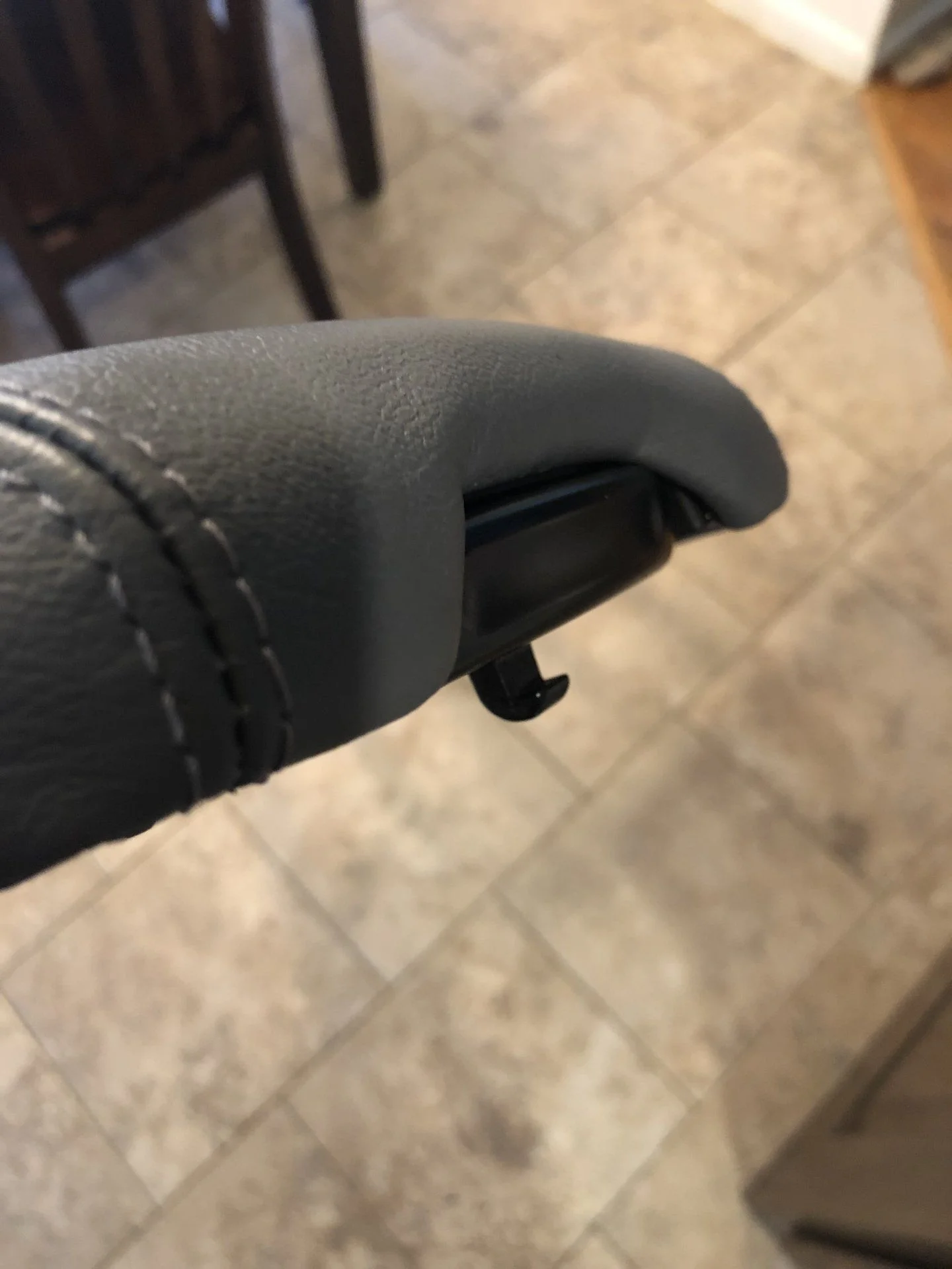

My center top console latch was broken when I got the truck and I used magnets glued in place but it only held for a week or two.
Looking online, I could not find any “Land Cruiser” center console latches so I figured it would be the same on other Toyota models. Low and behold, an eBay search for “upper center console latch Toyota” gave me mostly the lower latch in the results but sprinkled in were similar looking items for the Camry/ Solara and ES300. They came in grey, beige and black. I took the risk at around $25 shipped and it turned out to be a perfect match. I unscrewed the lid and popped off the cover shell (that I previously glued back on after the leather cover install). I used a skinny #1 Phillips to get the two screws out under the push button for the latch. Took the old one out and put the new one in and glued it back together overnight. All done and working great
