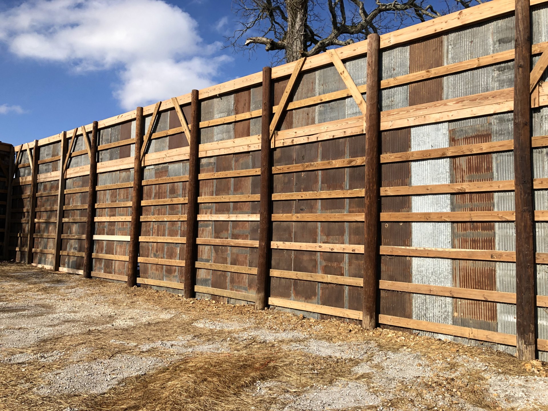

While I was waiting my turn I sealed the bottom of the metal with Great Stuff and silicone. Then I laid down the floor plate. After that I installed a 2x8 horizontal girt at the 8’ level all the way around the building for added rigidity in the walls. You can see both the plate and the girt in this picture.

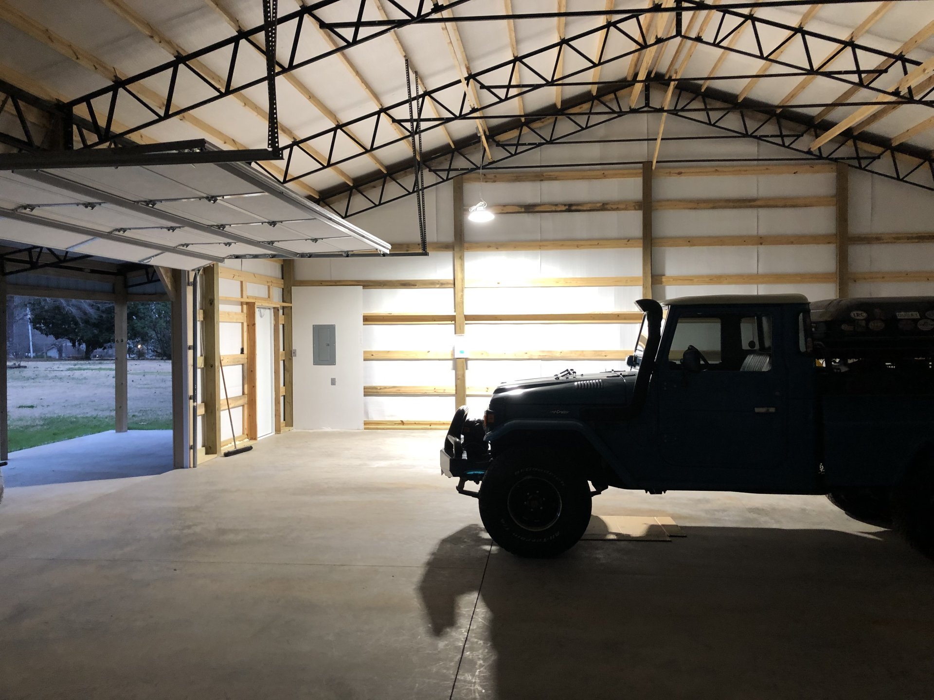

Power to the people! Today was my day with the electrician. Tomorrow is inspection day!!
I passed the final inspection today! Now I don’t have to wait on anyone (except the guy installing the lift) anymore. Also my daughter dropped off the security team today.

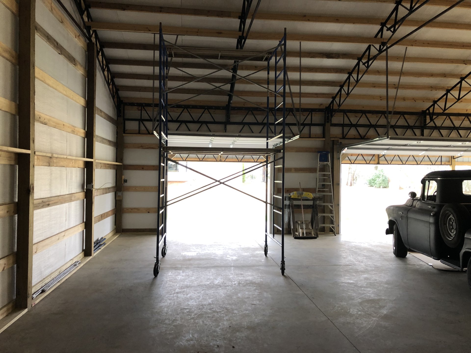

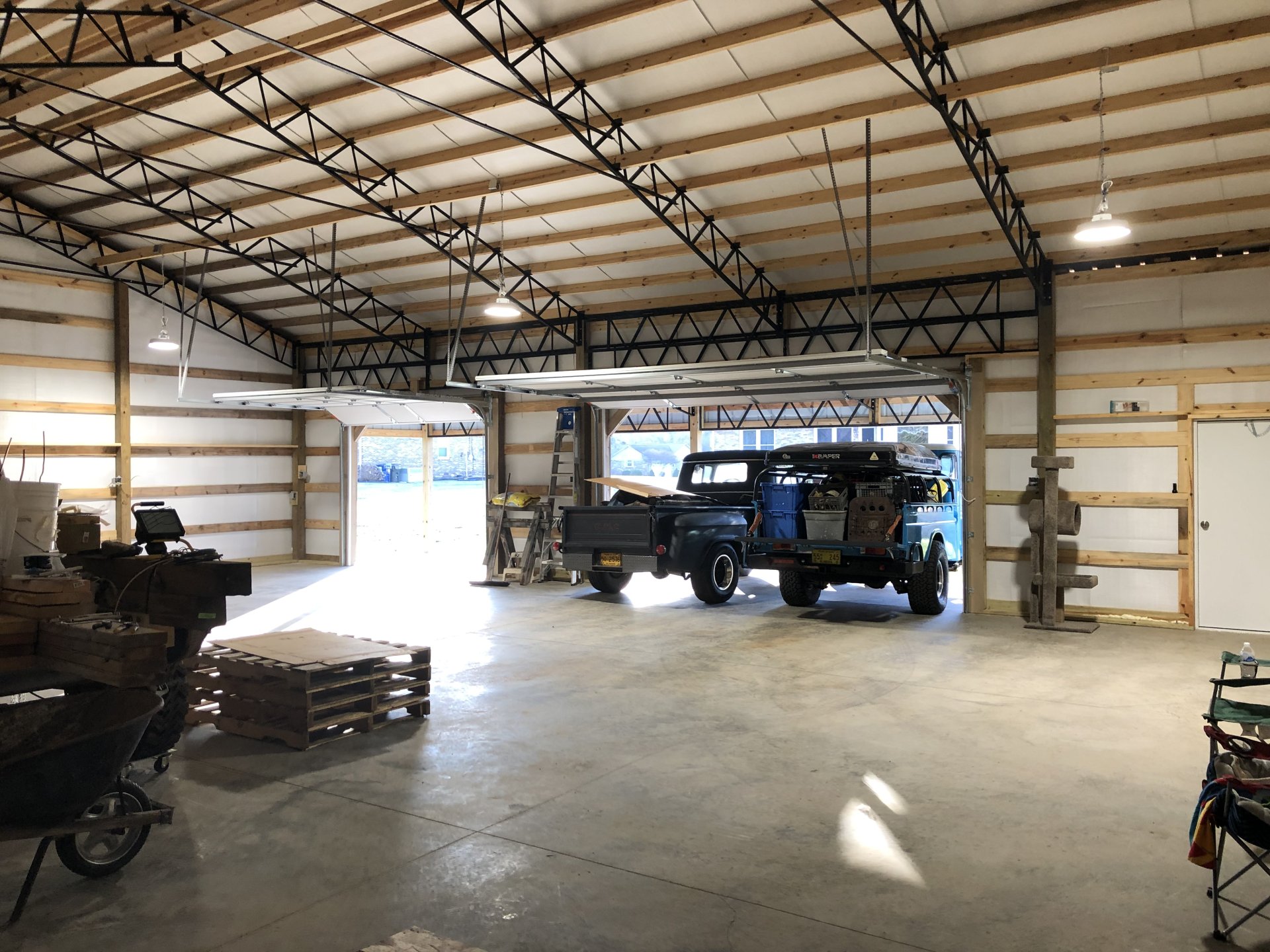

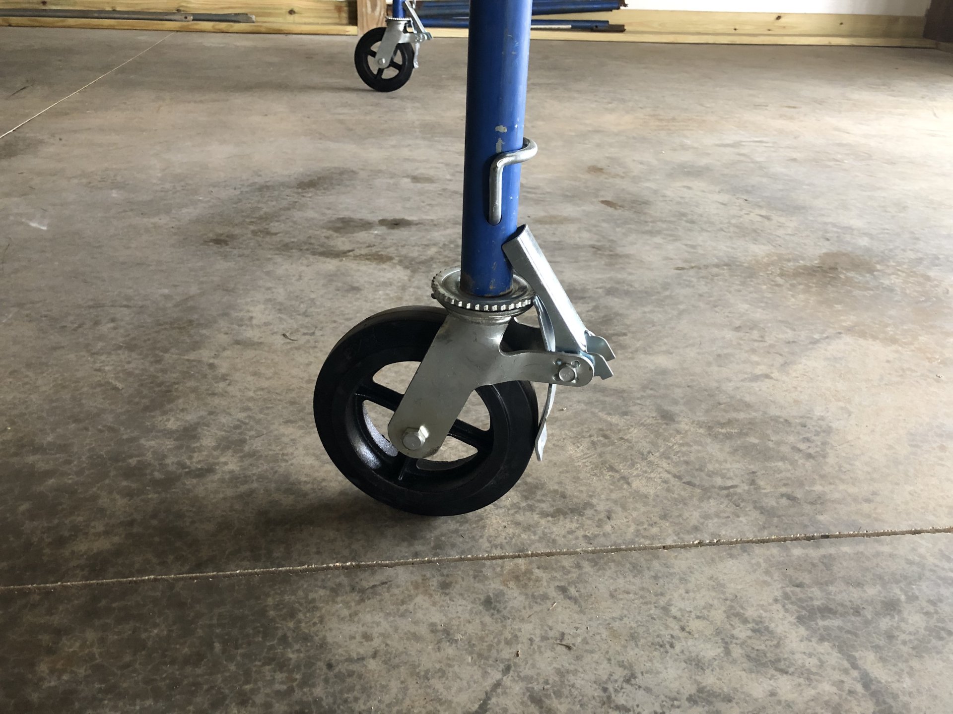

I have also been busy inside the shop. I borrowed some scaffolding from a fellow mudder which facilitated the installation of 4 additional high bay LED’s, my 208v circuit and then 12 double gang 110 receptacles. I have the lift installation tentatively set for 15 January.

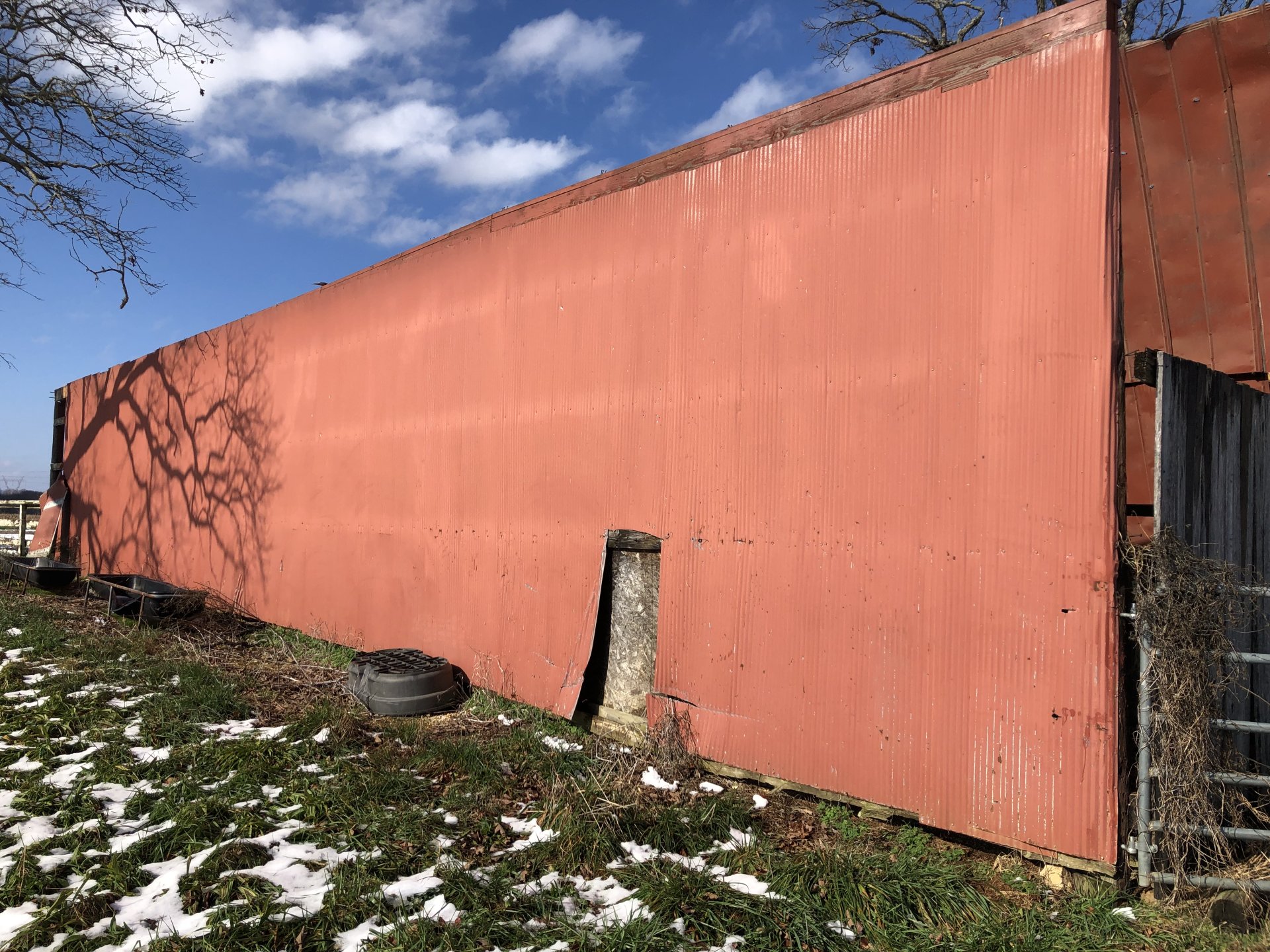

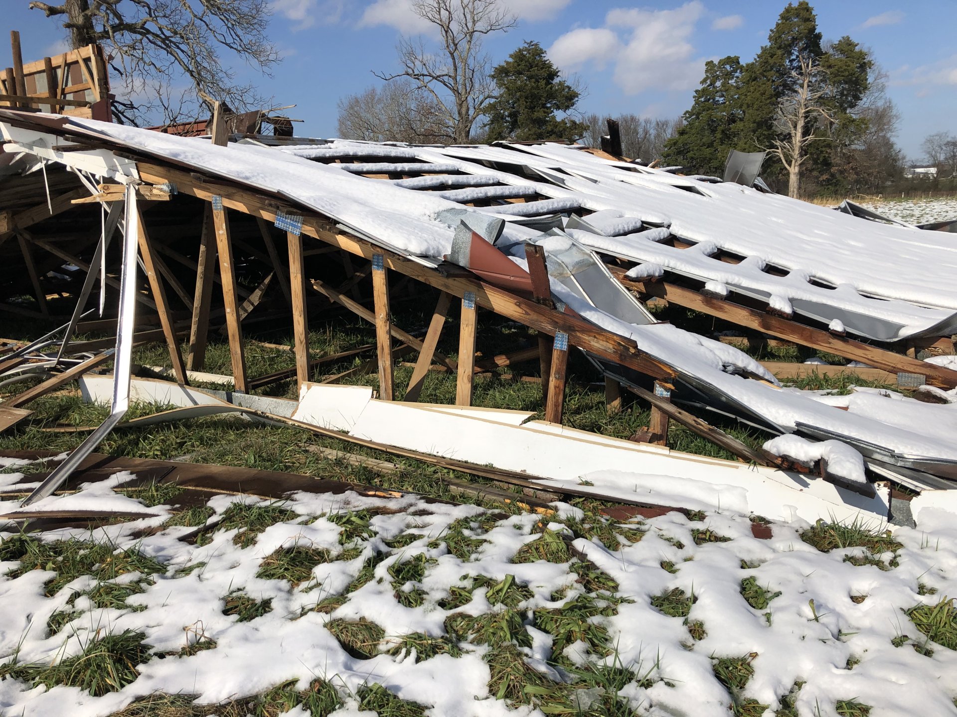

I was able to secure the rights to salvage this local pole barn that suffered catastrophic damage in a recent storm. It’s about 50’x100’x20’. There’s a lot of useable wood and I will probably use the metal for my inside wall finish.

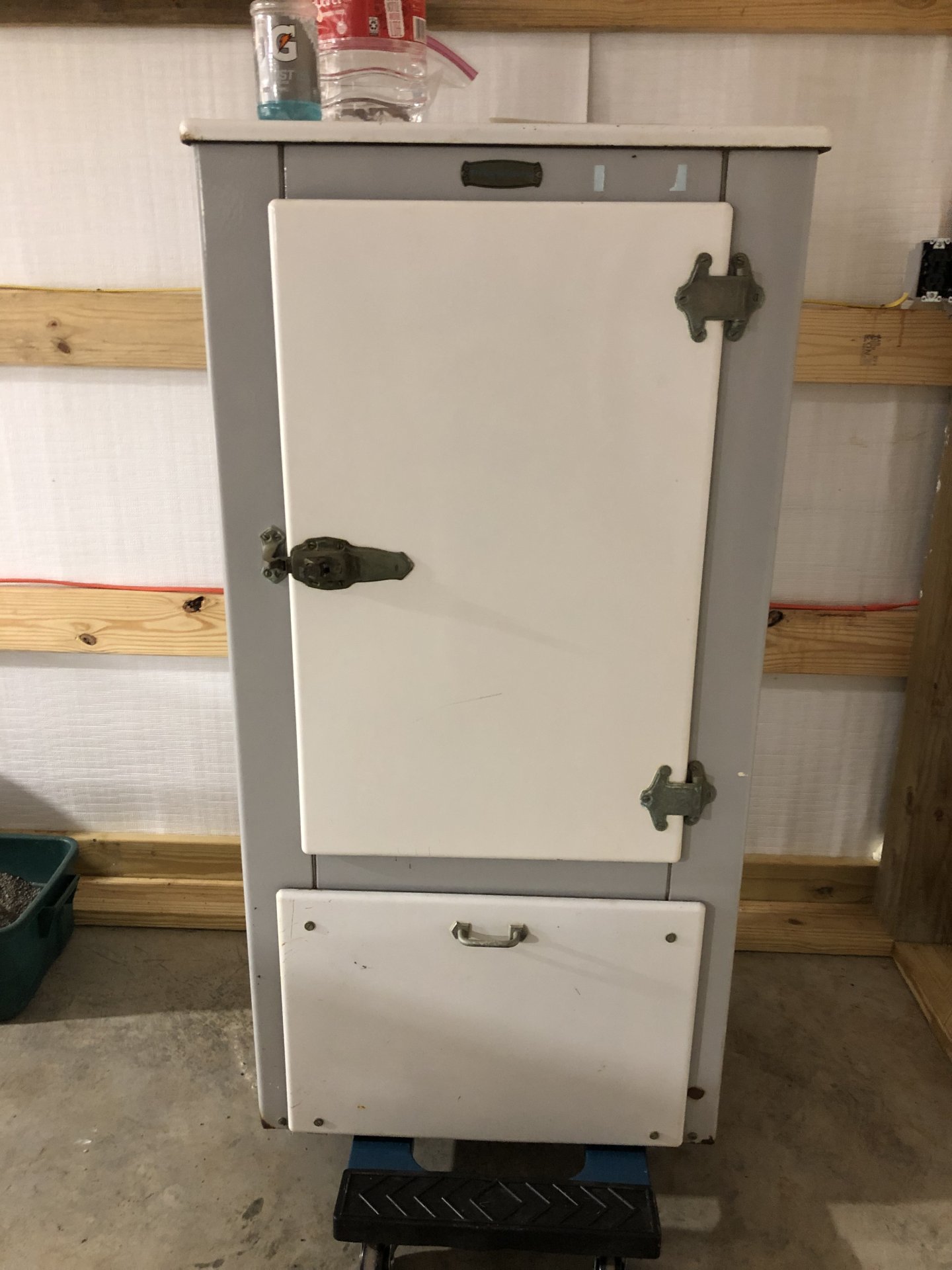

Yesterday I brought this 1920’s Frigidaire home for the shop.
Love the old pump. We had that same unit on our farm when I was growing up for diesel fuel. Love the fridge too but watch your power meter if you plan on using it. A friend of mine that owns an HVAC company has an old CocaCola ice box. He keeps it unplugged unless he’s having a party. Says he can watch the meter speed up when he turns it on.

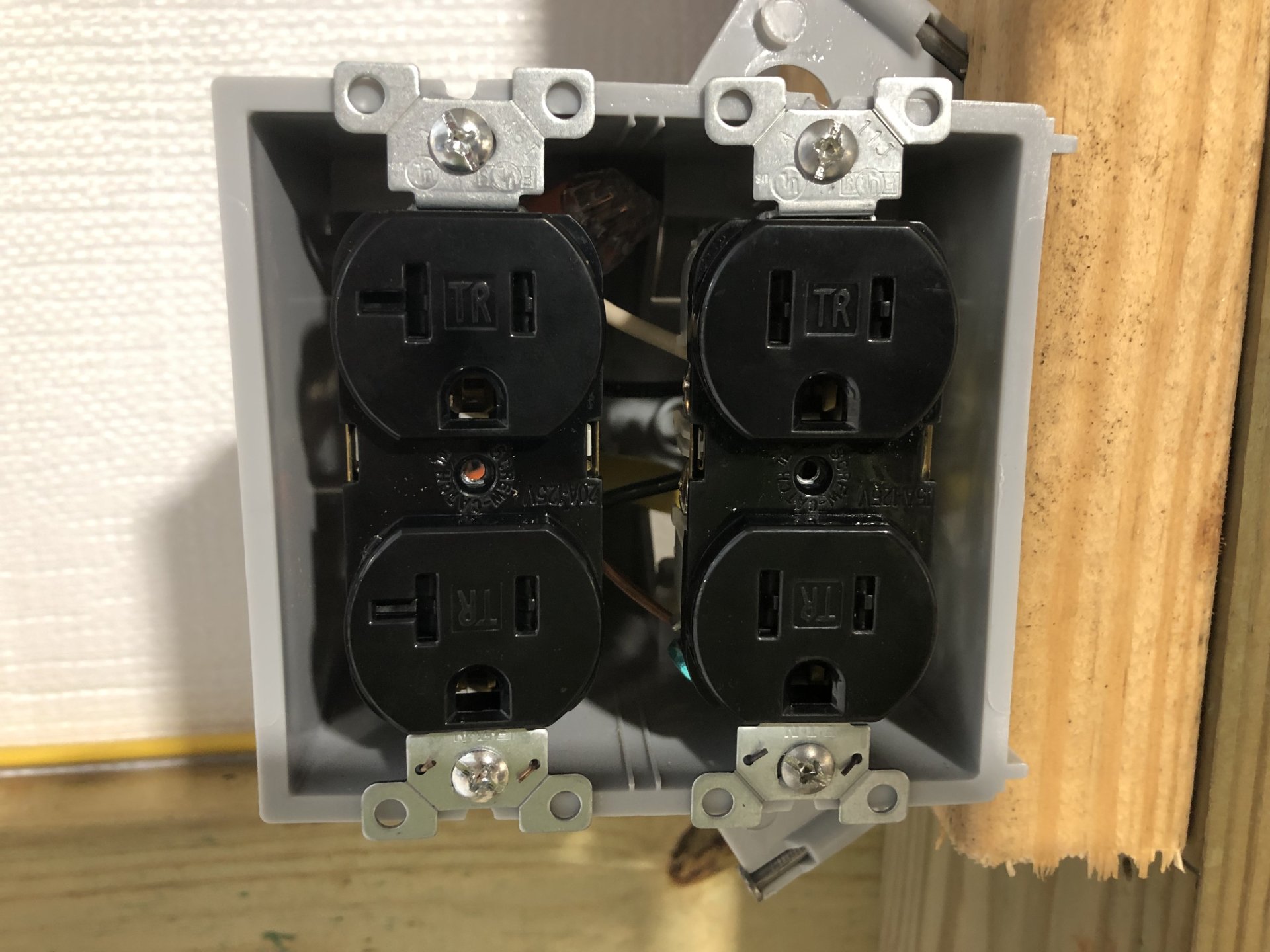

Why do you have 15 amp and 20 amp receptacles in the same box? Are they on the same circuit? 20 amp circuit?

Just not paying attention. It’s all on a 20 amp circuit. I will add that to my list.
