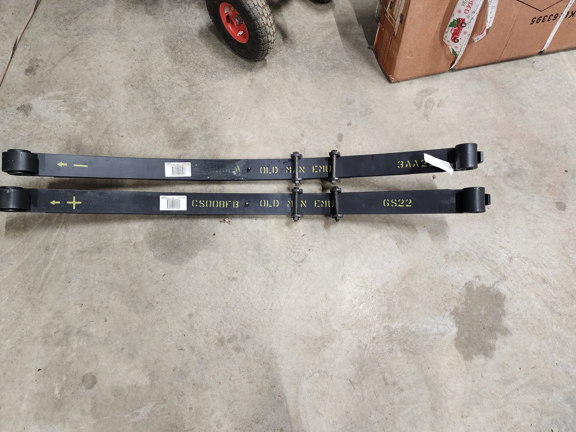

After a lot of searching, I was able to find a set of 5165s that were within a fraction of an inch of what the OME nitros measure out to. So 7.5" pin/eye with remote reservoirs will get going on with the new springs once the other spring gets here.

Well, after 3 different tracking numbers and much confusion, the DS spring arrived yesterday in perfect condition. No idea what kind of stupid was going on with it, but it's here. I should pick up some new bushings and also based on my last attempt, I should probably get some new spring bolts because I'm pretty confident those are going to need to be replaced before I'm done.

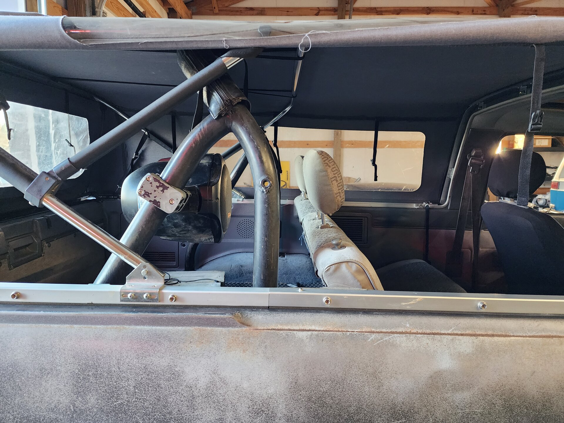

I also have been trying to figure out some improvements for the radio and speakers. I got a set of pods with the warpig that were in the corner. I pulled them apart and redrilled the mounts so that I could rotate and mount them onto the rollbar in the rear behind the back seats.
I have to sort out the wiring into the housing since rotating them covered the original holes.
Plan is a new head unit, fresh 4" in dash, 6.5" in pods and a powered sub we had stashed in the barn in the back. Should do ok.

And when I bolted the new "B" spring in...
I'm not pleased that a brand new spring has this much wrap under just the weight of the truck. Also, the truck still has a distinct lean to the passenger side. So I'm weighing the options. Since plan "A" is FUBAR, plan "B" is going to be to pull it back apart and put the DS spring in. The A spring is supposedly a little heavier rate, so hopefully it will do the trick. If not plan "C" will be to pull apart both the new and old PS spring and build a custom pack out of the two. None of which make me happy, but I'll figure it out.

Swapped the "A" (drivers) spring into place and gained about 1.5". The front now looks to be setting level. Measured from leaf to frame is almost exactly the same now. I went ahead and bolted on the new shock and finished up the passenger side.
Since we're getting ready to go on a ride in a couple weeks I pulled the sway bar off. Now to get the drivers side shock replaced and then if I have time I'll update the radio and speakers.
@tmxmotorsports I noticed that, but i didnt change anything other than the spring, and the shock mount is perfectly aligned. I think the larger tires put it closer and thats why lots of folks move the axle forward. But perhaps not. I'll study on it.
@gnob i studied a lot on the springs. A and B and which was which. Everything i fou d said the A was left and B was right. Didn't seem to matter where the driver was, so not sure. Either way, it sits much better and if the other rside starts to give trouble, I've got 2 springs that 8 can scavenge from.
The spring eye to center pin location is usually offset can measure the springs and see if they are.
I checked the OME install notes. Arrow toward fixed end is how they are installed. I'll check the measurements. Also, I think the angle of the tire and picture also make it look closer.
